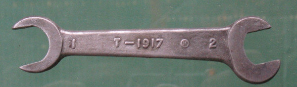

The 1917 wrench has survived in vast numbers, and most of us have it. You can adjust your bands with it, as intended.
The 5-Z-829 ratchet is much easier to use (quicker). You don't have to turn it over multiple times.

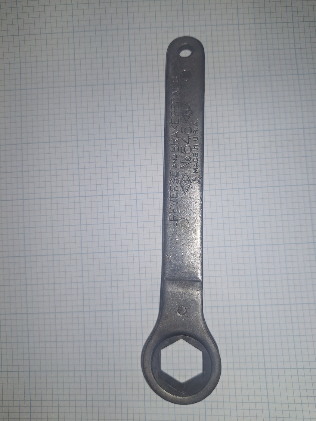

My favorite T tool. #645

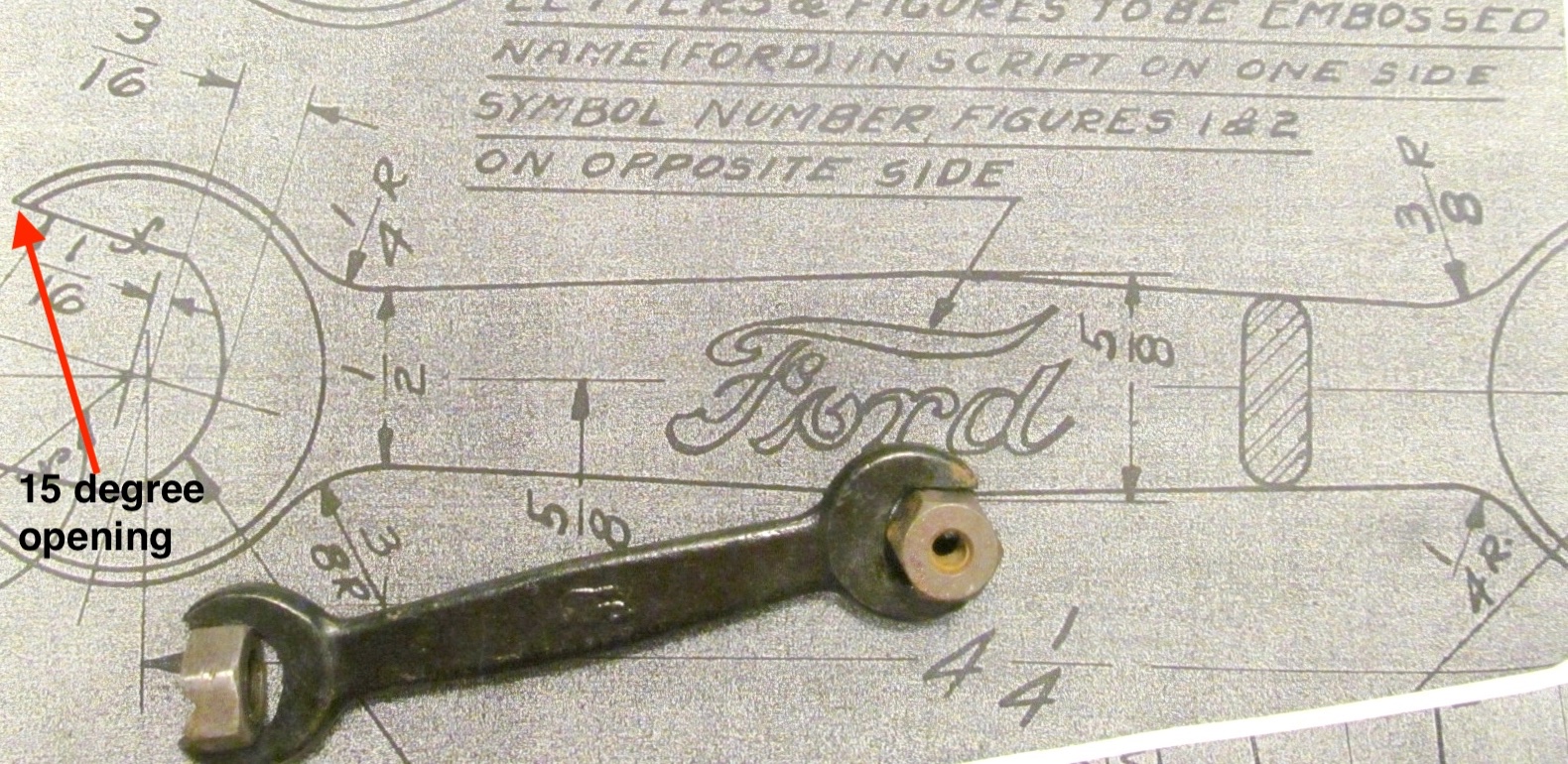

The famous 1917 is for the band adjusting nuts and for the fuel line pack nut.
The end marked "1" is for band nuts, and the 15 degree opening is there so the wrench will fit over the nut flats at an angle, as that approach is needed inside the hogshead.
The "2" end is for the pack nut.

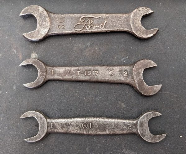

I've used both the 1917 Ford band wrench and the ratcheting wrench for band adjusting. I too found that the ratcheting version does have some clearance issues on the earlier aluminum hogshead, so I pretty much just use the 1917 wrench now, since flipping the wrench while adjusting the band nuts isn't a big deal to me.
After Dan posted about why the wrench is designed the way it is, including that the other end is for the fuel line pack nut, I use that end for doing that job too. Yes, you can use a modern wrench for that, but I enjoy using Ford, Walden or Blackhawk tools designed for the T when I can.
The 1917 wrench design was changed by Ford several times over years. Over time I ended up with most or all the variants. The chunky one on the top in the picture below came with the 1911 T that I restored, and I think it may be the earliest version of the wrench.

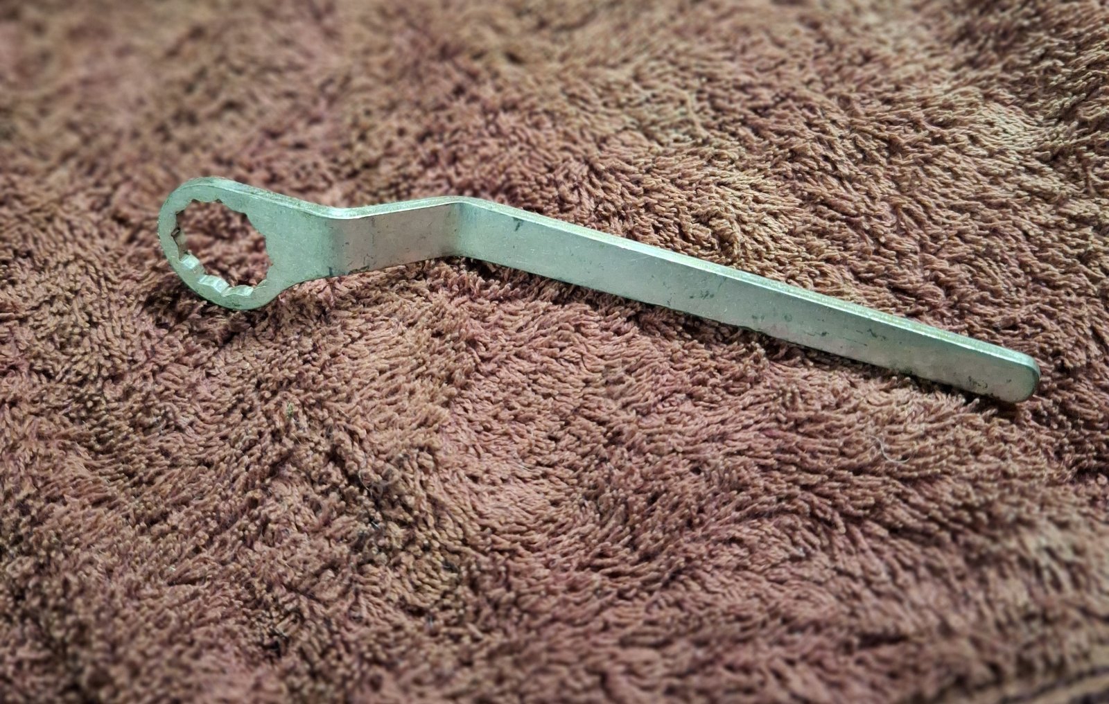

This is a modern version, created to make the job even easier. A friend had a batch of them made and I sold them for him at swapmeets.
The crank in the handle gets it well inside the side of the hogshead opening. On our RHD cars the first gear band is the only one with an internal adjuster. This tool would make adjusting your LHD brake band at the back of the opening even easier. Allan from down under

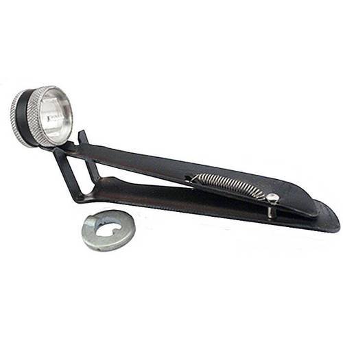

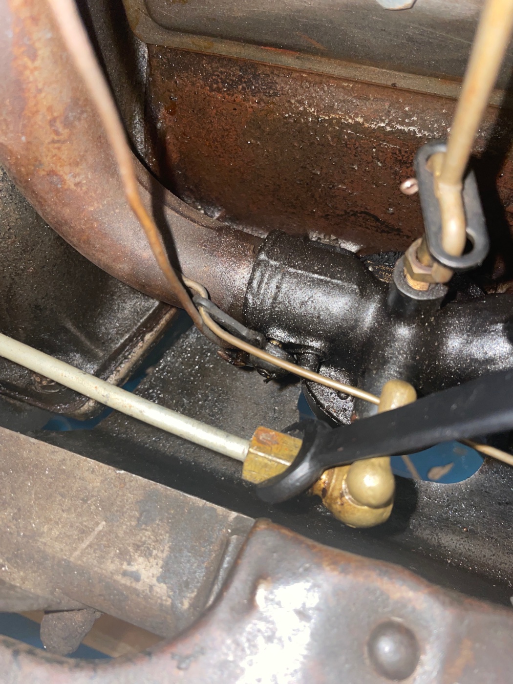

We used this to put in the nuts. No fear of dropping the nut in the abyss or need for dental floss.
- Posts: 4638
Re: Easier band adjustment
I still would use stuffed rags just in case. Can’t hurt a thing. Force of habit I guess.
