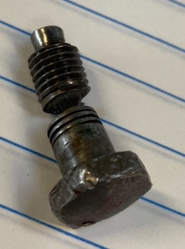

I put new bushings with shaft seal, brushes in my starter to resolve the oil leaking out of the starter peep hole. It spins fine and in the right direction. After I installed the bendix and cover, I pressed the starter pedal and I heard a clunk and then free-spinning of the starter. I took the cover off and found the outer spring bolt top in the cover. It sheared off flush with the outside of the #5019 nut. The key was still in the shaft and all looked right according to the diagram. It worked fine before I removed it. What can be the cause of the bolt shearing off? I ordered a new bolt set with lock tab washers.

Was it a new bolt, or reused bolt? Is it possible that the bolt was overtightened at assembly. Was it a "real" bendix bolt, or a turned down, modified, hardware store bolt?

The bolts from vendors appear to be grade nothing. Not a new story. Use originals or period replacements. New tabbed lock washers are OK.
Same failure just happened to a new member's first T.
No mystery. Bendix bolt failure has been common for the 40 years I have been in the hobby.

I reused the same bolt, origin unknown but looks rough. It could have had stress in that area and that was it's last dance. 6V, no mods.

That bolt appears to be an original. Originals do fail also. The bolt seats @ 2 points @ the same time. One being in the shaft recess & secondly on the spring loop. If the bolt, when tight doesnt lock the spring down, the bolt shaft gets a constant working.
Tightening the bolt a bit past its shear point fatigues the bolt at that very spot where it separated. That over torquing on the soft repop bolt shears in the same spot.

That bolt has done its fair share for a long time. Not too shocking that it finally retired.

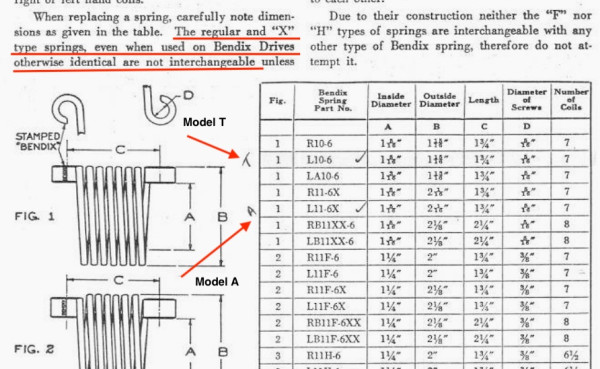

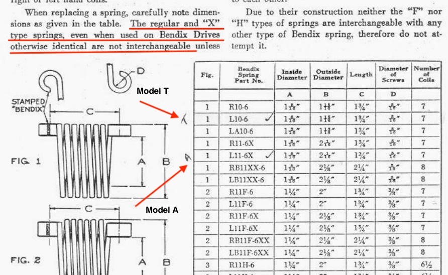

Correct bendix spring is essential. I seem to recall someone in the past posted a comparison picture of a Model T and a Model A bendix spring. For those like me who have both a T and an A, it is helpful to know the difference.

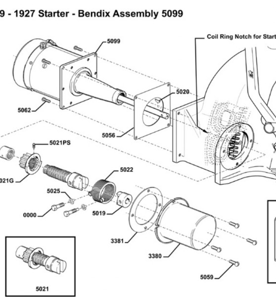

I can post a picture tonight of the spring but it appears to match the digram and the starter was working fine in spite of the worn bushings and brushes. The spring was not preloaded when I ran out the two bolts, does it get assembled in static state?
Yes. That's the only way it can be installed.
Be sure the two eye-ends of the spring are aligned with each other, as shown in the diagram. If not, it means that the spring has been distorted and should be replaced.

I mounted it as in the diagram. It looks straight. Not distorted.

Jones in Aiken SC wrote:
Tue Dec 17, 2024 12:50 pm
The difference in A (L11-6X) and T (L10-6) Bendix springs is the A is larger in diameter and can strike the cover, and believe the loops on the A are thicker too, making the T bolt a bit short.

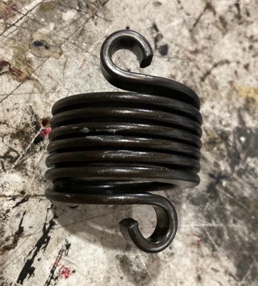

Mine is as in fig.1, a little stretched past 1.75, measures 1.85 on centers and the ID is 1.75.

That spring is way better than some I have seen that were still in service.
The bolt has broken just short of full engagement in the drive head. When fitted it is meant to jam the spring eye tight on the drive head. The lock washer is there to hold it in place, like Henry's split pins. The small end does not bottom out in the drive head. It is merely a locator, so the break is where the twisting is when too much torque is applied. Let the lock washer do its job, rather than loading up the bolt excessively.

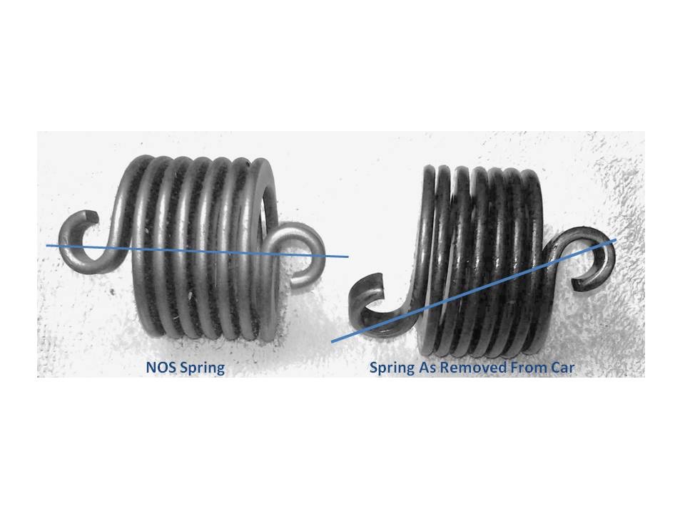

That spring does show usage. For me, $15 for a new spring is good addition for starting pleasure. Fixing busted and bend spring from under the T is a pain ;)
Photo from forum poster on his bent out of shape spring that needed replacing.

DanTreace wrote:
Wed Dec 18, 2024 8:03 am
I have more faith in the old one than a new one.
