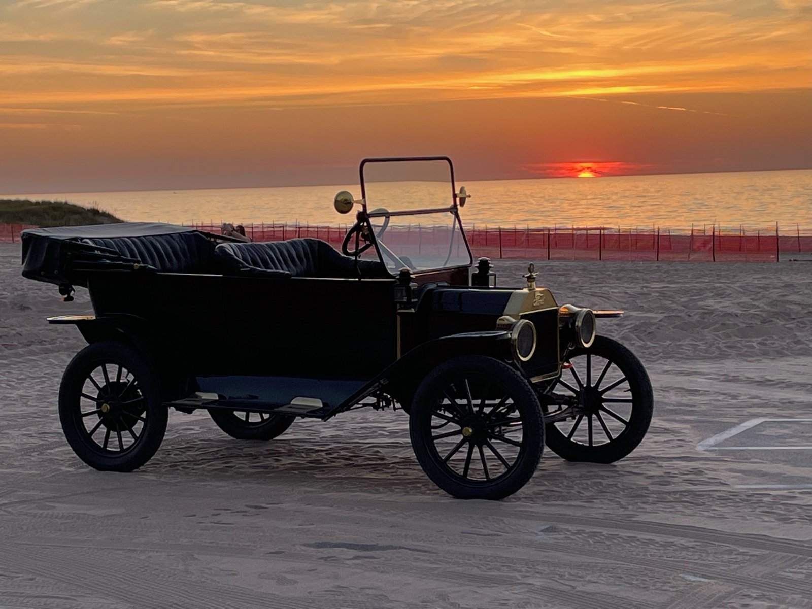

Also...my office is right next to Lake Michigan. I stopped on my way home from work and took this picture about 7 weeks ago. Isn't cruising the beach after work better than going to some show and sitting for hours? Maybe I don't need to worry about keeping it strictly original.
And a second response to John, I have tried replacing the burners with LED lights a few years ago. The best ones available when I tried them were not very bright and I felt very unsafe when I was driving at night. I replaced them with 55W halogen light bulbs and they are much better. The halogen bulbs screw into the burner holders and the wires run down the acetylene gas hoses and unless you look closely you will not notice anything different from stock. They pull a lot of power, but they are bright. I know there are some new LED lights available, but I am not sure how well they compare to the halogen bulbs.
