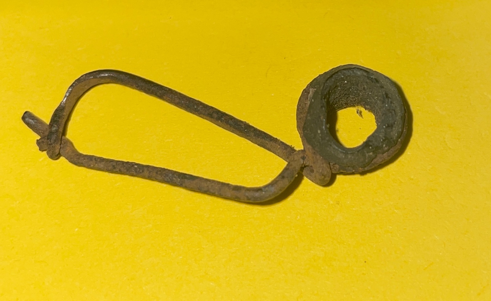

Here's one original tail lamp wire bushing and wire twist in my stash. It's rather stiff now after 100yrs or so, but was probably a hard rubber like material same as the panel plug on the touring cars to fill the hole in the rear body for removal of top prop iron shafts.
The dimensions were hard to determine, best guess is hole for wire is 1/4" dia. And the outer dia. of the circle wire is 1/2".
The wire is .062" dia. The grommet has an obvious groove in the grommet for the wire wrap, and the sides of the grommet are rather conical too.
The wire shows the single twist as noted.

Dan, those images surpass 1000 words. Thanks so much.
Your description of the material reminds me of the conical-shaped rubber grommets used on old electrical appliances which break easily and crumble if you manipulate them too much. They almost seemed to be made of a tar-like material the way they would break up.
I don't know where I came up with the idea of porcelain insulators for the tail light wire. Bruce McCalley's Encyclopedia has only one entry for the word "porcelains", referring to the coil box, and I have yet to glean through my paper copy of "From Here To Obscurity", but it appears safe to say that the T-4082 was not made of porcelain but from a rubber material.
If anyone has evidence of the contrary, please chime in.

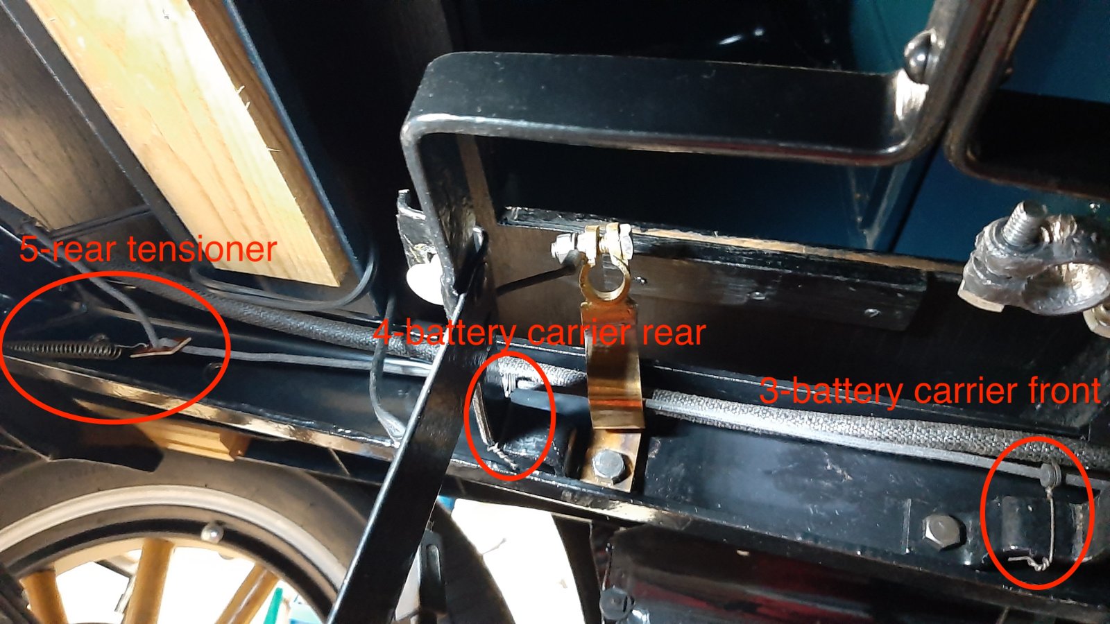

Here is my interpretation and how I have fitted the insulating supports for the tail light wire on my 27 Roadster.
The extra wiring loom carries the turn indicator and brake light wires.
I attached the tail light wire separately just because that's how it came from the factory. What can I say, I'm a futz with this kind of thing. Some people enjoy finding all the parts to assemble a jigsaw puzzle, I like finding all the parts to assemble a Model T.
