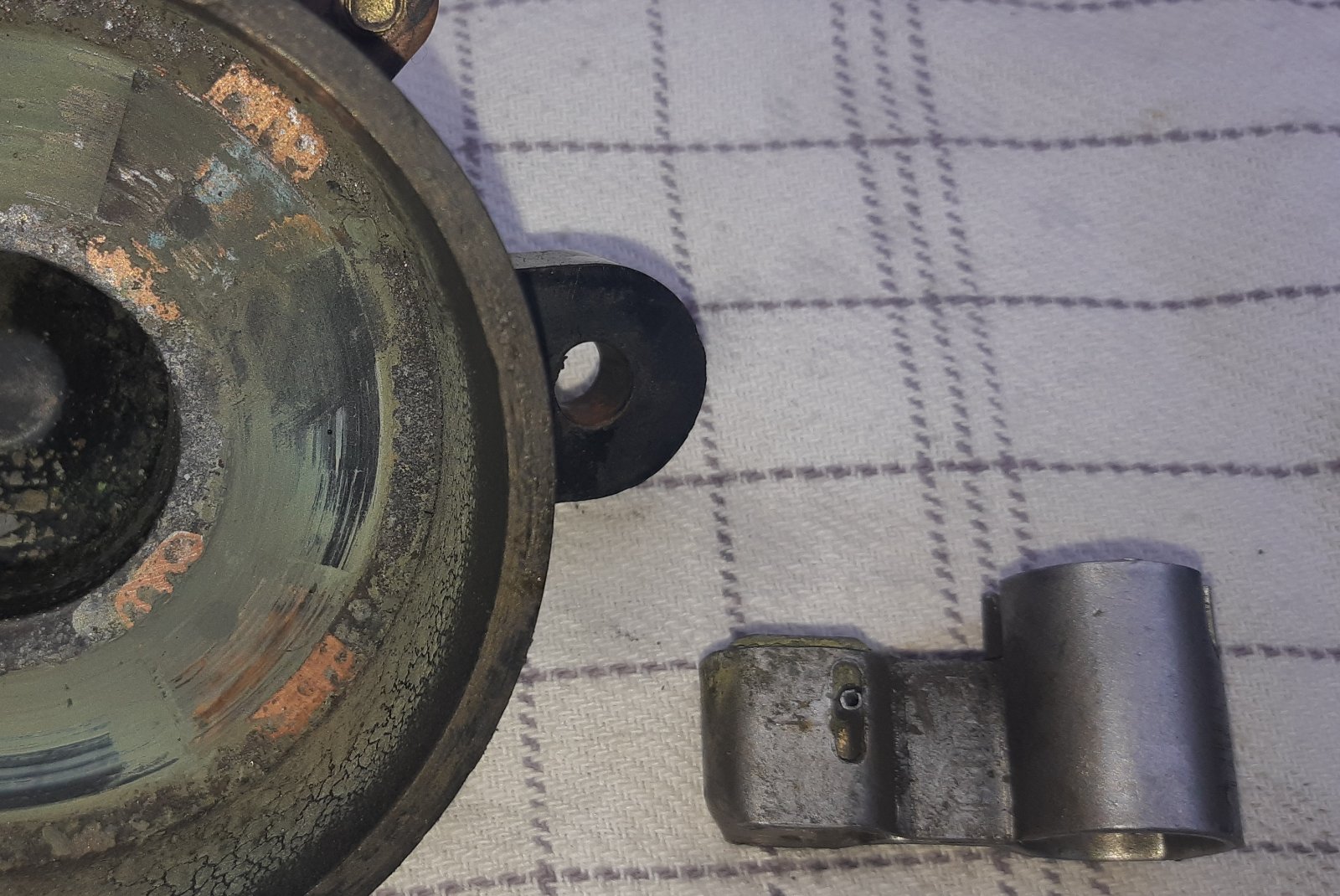

Hi,
my 1922 Fordor was equipped with a Newday timer and drove very fine with my rebuild and ECCT trimmed coils. That was 2 years ago. Back then the one rearaxle snapped, but with a complex fracture so that it retained the wheel. Actually I thought it was a broken tooth in the rear end.
This summer I took the rearend off the car and found out that it was the axle that whas broken, not a tooth. A new axle was purchased and replaced. The rearend was put back on the car and everything seemed fine and I could proceed to the tour I was planning to.
That tour want OK and back home all was well for a couple of weeks, and then it started to run rough. An investigation showed that the brush in the Newday rotor was toast. All weared down and the timer it self looked like this inside: OK, maybe the inside of the timer have been somewhat corroded during the 2 years storage (not always under perfect conditions) so I polished the inside with a piece of steelwoll and bought a new rotor.

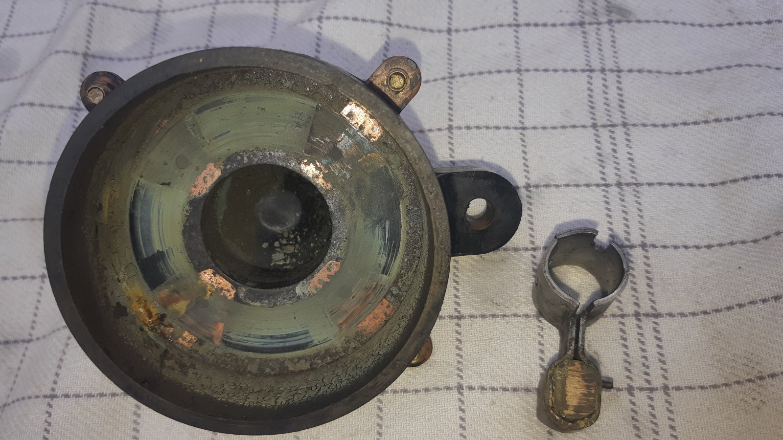

Some couple of 100 miles and the same happend - actually the picture above is as it looks now, not back then as I took no pictures, but I'm sure you get it.
Here you see the rotor is all weared down but straight: I know that where some issues with the rotor some years ago not able to hold the brush square, but that does not seem to be the problem here. The brush are weared down nice and square.
What seems to be the problem here?

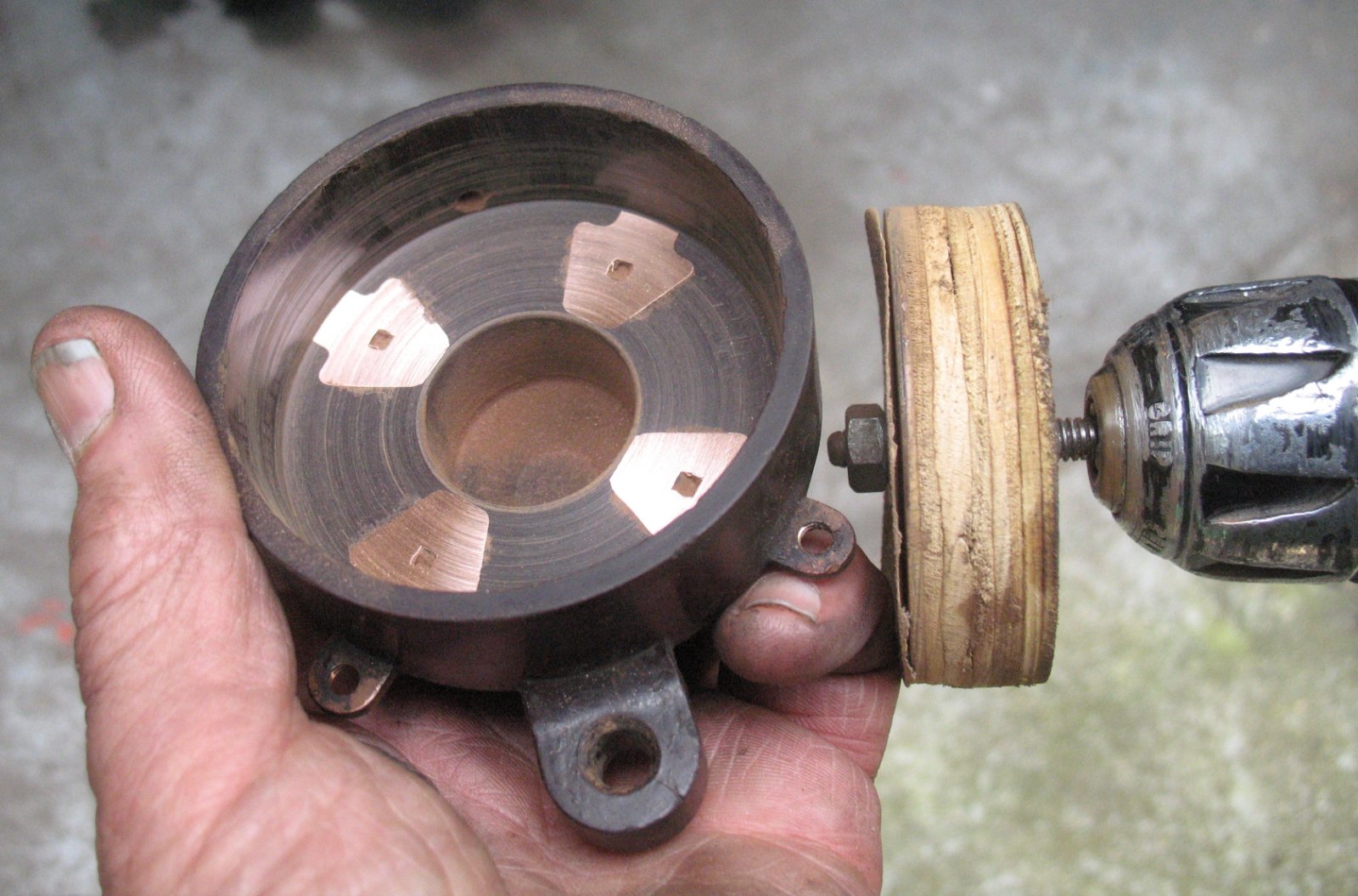

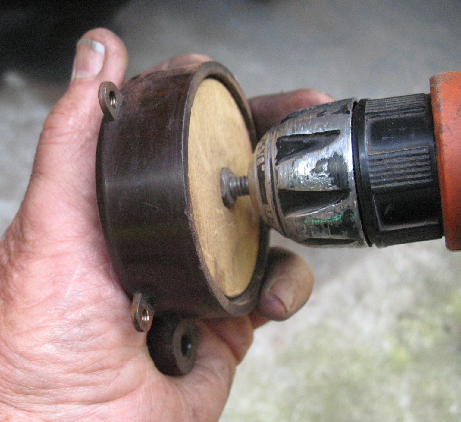

Looks like water got trapped in it. You could cut a round piece of plywood and stick a superfine sanding disk on it with a bolt thru in center and put it in a drill to grind it smooth again. Cut a notch in the bottom edge of the timer so water can drain out.

If the residue is not oily and has a greenish color, it would appear that water has somehow gotten into the timer. Otherwise, one or more coils may have developed a problem. Mechanical alignment or clearance issues can also cause problems. If your engine's crankcase has collected water from condensation, running the engine to operating temperature could generate a lot of water vapor in inside the engine, and some of it could work its way into the timer case and condense there, due to the timer running cooler that the rest of the engine, especially in winter weather. I would check carefully for any evidence of water in the oil and change it if necessary. It would be a good idea to clean up the timer, then run the engine for 15 minutes or so, then stop it and check the timer for any indication of moisture, oil, or some mechanical issue.

I agree that something is getting in there but, (especially oil or even an oil/water mix), would tend to lube the brush. That might not help your running much but it sure wouldn't cause the brush to wear so quickly. That contact surface on the cover must be pretty rough.

Brush clearance to the timer face is in question. Appears too close. Can be from the brush mounted to high from a condition caused by a thicker timing gear hub or a poor thrust situation where the cam can be moving forward. In worst situations the timer will dance while running.
Clean the timer contact surface as suggested. Look for gouged insulator material loss.(to dirty to tell in your pix) Measure the depth of the timer & the height of the brush to confirm proper clearance & test cam for potential cam forward movement.

Some New Day reproductions are of notoriously poor quality, including the rotor and the cover. I haven't used one of the current reproductions, but they are said to be very good. Maybe yours is one of those earlier reproductions, prone to failure.
1 Your rotor appears to have a brush that is much too short. The simplest cure for that is a new rotor.
2 I've never seen a cover that looked as bad as yours. Has it been lubricated with oil or grease? It's supposed to run dry.
Try this.
The surface should be clean, and as smooth as possible.

The biggest problem I can see is with your rotor. The brush does not extand at all from the holder. Doesn't matter what you do to the cap, the rotor is useless as is. Not sure that the brush is worn down, as you suspect. I think it's just jammed all the way in and stuck there.

That is not an original New Day cap. The little holes in the contacts are round whereas originals are square. It may be one of the inferior knock-offs. The best reproductions are available from Tip-Top timers of Spokane Valley, Washington. They are also sold in a kit (including a new brush) from both Lang's and Snyders. I have had good luck with them, putting many thousands of miles on them without issue.
If you haven't replaced the felt camshaft seal with neoprene you should. Also, remove the brass shield behind the brush if there is one still installed. It isn't needed with a neoprene seal.

thank you for your feed back. I obviously did not cleaned it up before putting a new rotor with new brush since it was weared down very quick.
Moisture is obviously the problem here. It was stored in a ventilated barn with fixed (but not concrete) floor so some moist may have been there during the winter. Also, I have noticed "Mayonaise" in the oilfiller neck when adding oil - clearly from condensation on the front of the engine. I do not think I have a cracked block where the coolant seep into the oil, but you never know unless you pull the engibe and inspect with magnaflux or the like. Thats not in the plan right now.
I'm for to change the seal from felt to modern type to make sure neither oil or moist or both enters the timer.
And by the way - it is not an original New Day. They are probably not around here in Denmark and Europe, but it is a newer repro bought 2 or 3 years ago at Snyders via a local representative/dealer here in Denmark. So it should be OK which is also why I was surprised of the wear.
