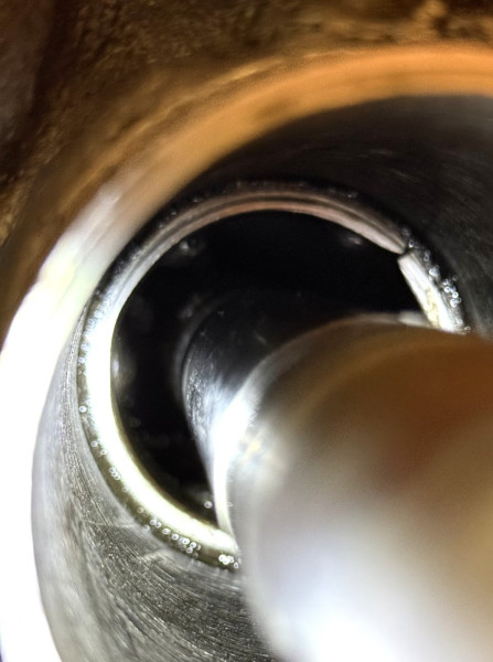

Re: inner seal rear axle removal
Don't make this mistake I made. After reading a few posts and taking out the roller bearing and the liner from my rear axle I saw what I thought was the remnant of an inner seal. It was covered in grease. Pulling with a hook on the end of sturdy wire didn't budge it. I made a tool out of 1/8" flat stock with a handle I could hammer on ... it still wouldn't come out and my tool kept slipping off. By this time I had pulled out a lot of the grease and I noticed some bumps on the inner part of what I thought was a seal. See the pictures. Next I measured from the what I thought was a seal (but is really the end of the axle) to the outside of the bearing housing and got a just over 4". The new bearing sleeve was exactly 4" and the metal part of the new neoprene seal about 1/16" if that. So I cleaned out the rest of the old grease, slid the new seal in and installed the new sleeve as per the video. Everything went all the way in and was flush to the end of the bearing housing. I hope this post saves someone a lot of time that I wasted.
