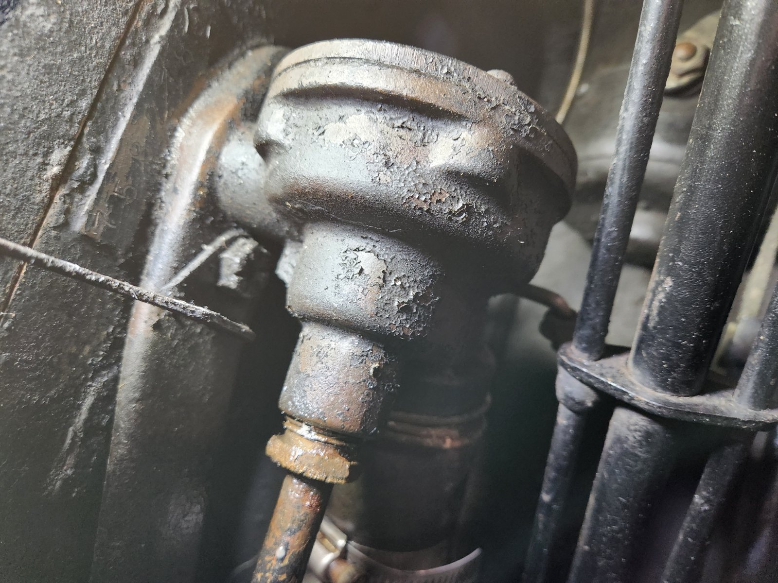

Removing a legacy water pump
How to remove that nut under the horn bracket?
No Bird Soars in a Calm - Wilbur Wright
- Posts: 7120
Re: Removing a legacy water pump
Looks like enough clearance for a ring spanner to me.

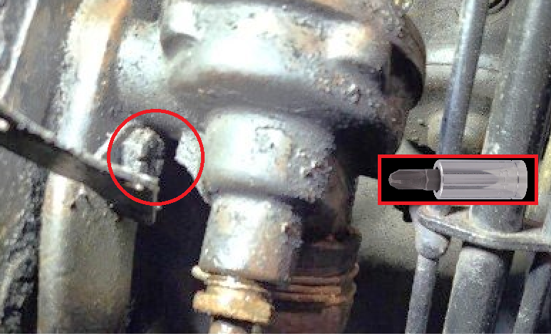

There may be an on'off reason for the Phillips looking + on the head of the bolt.
- Attachments
- 20241229_161700.jpg (74.8 KiB) Viewed 41285 times

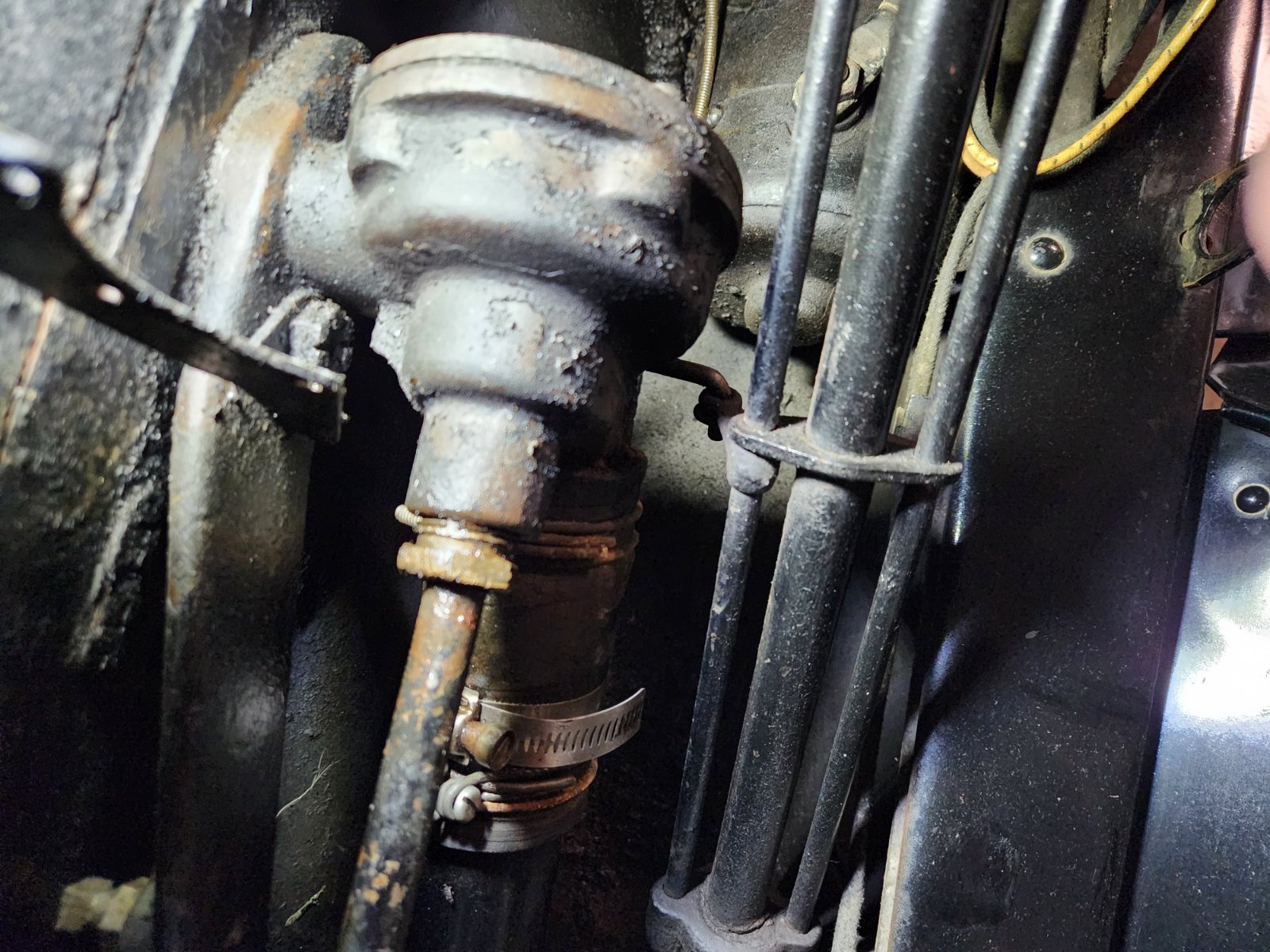

You are removing the water pump. Yes? The horn is off, the fan belt is off?
Remove the rear bolt, it is in open space and easy to get to. Try to shake the water pump a bit to see if it is firmly stuck onto the side of the block or not.
Regardless. You may be able to barely get an open end wrench part way onto the bolt's head. Another option is to drive a nail or small punch or old wood chisel in between the bolt's head and the water pump's inlet to the block. Anything to more or less lock the bolt head to the pump. Then with one hand pushing down on the front end of the water pump and the other hand hanging onto the barely holding wrench if you have one, or what ever else may be helpful (maybe the horn bracket?) helping to hold everything together and rotating counterclockwise? See it the bolt will follow the pump? Chances are pretty good it will?
That has worked for me twice many years ago with very similar inaccessible bolt heads on T water pumps.
With the rear bolt out, and once the forward bolt breaks loose, the front of the water pump can be raised and lowered without turning the bolt such that an open end wrench can hold the bolt in downward turns and then be pulled out and repositioned for additional downward thrusts.
That is how I have done a couple of them.
Then again? Some people have such great respect (I say, that is a joke son!) for water pumps on model T Fords that you should take a fresh hack saw or die grinder and start cutting off bits and pieces of the water pump until you have easy access to that bolt. If my first plan did fail? That IS what I would do next.

I would remove the hose and water pipe to see if it could be accessed from under the water pump. If they got it on there you can get it off.

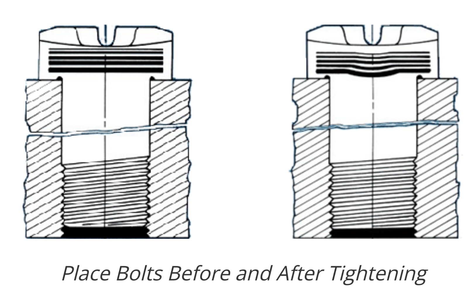

“There may be an on'off reason for the Phillips looking + on the head of the bolt.”
The bolt is a Place Bolt. The grooves provide a self locking feature.

Perhaps the cuts in the head of the bolt were for a Pillips
Thomas Miller posted correctly above:
What Are Place Bolts?
Place bolts are self-locking, free-spinning hex head bolts that prevent loosening due to vibration. While other bolts’ locking abilities reside in their threads, Place bolts are unique in that their heads are responsible for the locking action. This is an important quality because it not only produces up to seven times more vibration resistance than conventional hex head cap screws, but it also makes the bolts reusable — giving you the ability to loosen and re-tighten them without any loss of locking.
There are currently three different types of Place bolts on the market, including:
AA Place bolts – The original design, invented by Charles Place back in the mid 1950s, which includes a symmetrical six-slot head with an undercut.
B Place bolts – Wilson-Garner’s improved Place bolt design, featuring a five-slot asymmetrical head with an undercut.
BH Place bolts – Wilson-Garner’s further improved Place bolt design, featuring the same five-slot asymmetrical head and undercut as B Place bolts, but with an oversized head.
https://wilsongarner.com/what-are-place-bolts-used-for/
https://wilsongarner.com/how-asymmetric ... olts-work/

Just how do place bolts achieve their anti vibration abilities? If they lock in place as advised, why is the head drilled for safety wire? I am not quite with the program.

Explanation here:Allan wrote: ↑Mon Dec 30, 2024 6:06 pmJust how do place bolts achieve their anti vibration abilities? If they lock in place as advised, why is the head drilled for safety wire? I am not quite with the program.
Water pumps for a T do have uses. The best one is as a conversation piece when used as a wheel chock when parked.

Thomas is correct. More zoom & filtering

It's out! Had to thin down the box end of the wrench. Parts on order from langs to convert it back to thermosiphon. Suprisingly, whoever installed the pump didn't also put in a thermostat
Thanks to all

Very interesting explanation about place bolts, never heard of them before. They sound very useful.
