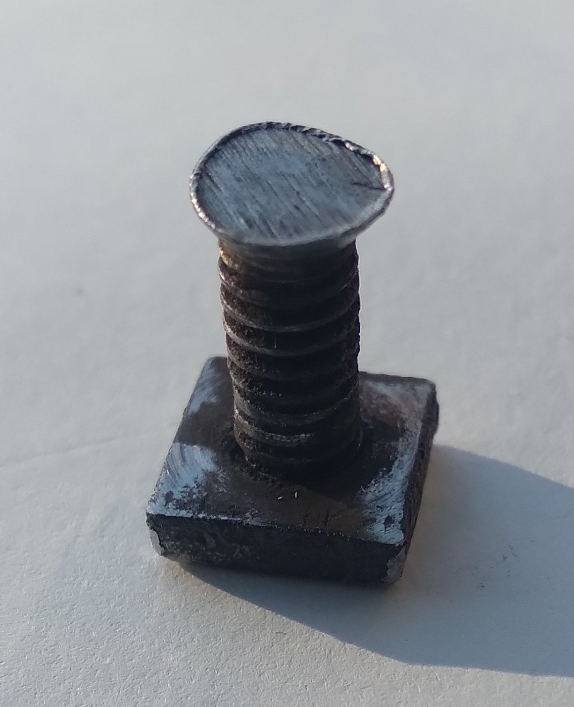

JR, I am also in need of wood plans for my 17 project. On my 17-22 body panels you can clearly see the spot weld as have been talked about above. My drivers side panel was spot welded in 13 spots, 4 places on the passenger side blow the door. I'm thinking that these panels were most likely spot welded before being attached to the body wood, perhaps in a fixture. It's also interesting that the fasteners that attach the rear panel and the side panel did not have any filler covering the heads, just ground flush.

More pictures.

One more picture.

Thanks for the pictures. Can never have too many reference pictures. So the screws that insert through the trim and hold the rear panels to the center panel were smooth, no slot?

Yes JR, that is correct. The head of the machine screw does not have a slot. I'm not sure of the correct name for the body iron that creates the bead down the back of the body is, but the holes in that part are counter sunk to match the head of the machine screw, 10-24 thread. The driver's side panel fit is as Wayne has described above, the notch and the splice were made very neatly along the bead forming the fake door.

Close up pictures of the rear body molding machine screw.

I wouldn't be so sure that they didn't have slots, at least to begin with. It's possible that un-slotted screws were used, but also likely that they had slots in them, before being ground flush with the trim piece. (I believe the term for this flush grind is "frenching in.") One of the screws shown, may just barely be showing the last trace of a groove.

Correct... I was merely referring to the finished appearance and whether or not smooth fasteners are correct. I have seen some pictures of the same profile trim on the rear deck of the roadsters, below the turtle deck, that had obvious fasteners (most likely wood screws as I believe they screw into the wood) but the screws were flush with trim and no slots. This can only be a result of dressing the screw heads after installation. I am assuming this is the case with the trim attaching the roadsters side and rear body panels. Mine had slots but the body I have had been previously disassembled and reassembled prior to my ownership. I am sure this is a common. So what do people do when restoring one of these, assuming they separate the panels? Do they use slotted screws and call it good, or are taller counter sunk screws available that allows the slot to be removed by grinding/sanding/filing or is one to think outside the box to achieve this result?

When I replaced the missing trim piece I used slotted flat head screws. I used the correct size drill bit and then countersunk the hole. I then installed the screws and ground them off smooth. I’m pretty sure it was originally done that way but thats my opinion.
The screws would need to be tightly secured and the slot head is needed to do that.

Right. I believe the key is to not countersink so deep that the head won't protrude enough to grind away the slot. I suppose the slots & heads could also be covered over with body filler, but that might "pop" over time.

I’ll have to check some of the machine screw sizes I have and see how much of the slot, if any, seats below the tip of the trim. I never did pay much attention to how deep the countersunk areas of the trim is. It’s possible they could be shallower than what is normal depth in order to accomplish a smooth, slot-free, fastener. I appreciate all the replies.

As John and Jerry both prescribed, flat head machine screws with a straight slot (10-24) but more importantly I'm in need of body wood.

Thanks. Looks like that should work just as Ford planned.

Post by JR Ewing » Fri Jan 17, 2025 12:13 pm
I have another question that I have not been able to find online or on this forum and it is regarding the top irons, not to be confused with the bows. The short irons that were in my 1918 Roadster connected the body at the tackstrip to the wood on the "B" pillar and did not connect to the seat frame area like others I have seen. Which irons are correct for my car. I did not see any part numbers on my irons but the parts book says the correct iron is part number 8401X, fits left and right sides and is for the years 1917-1922. Thoughts?
Thanks!
