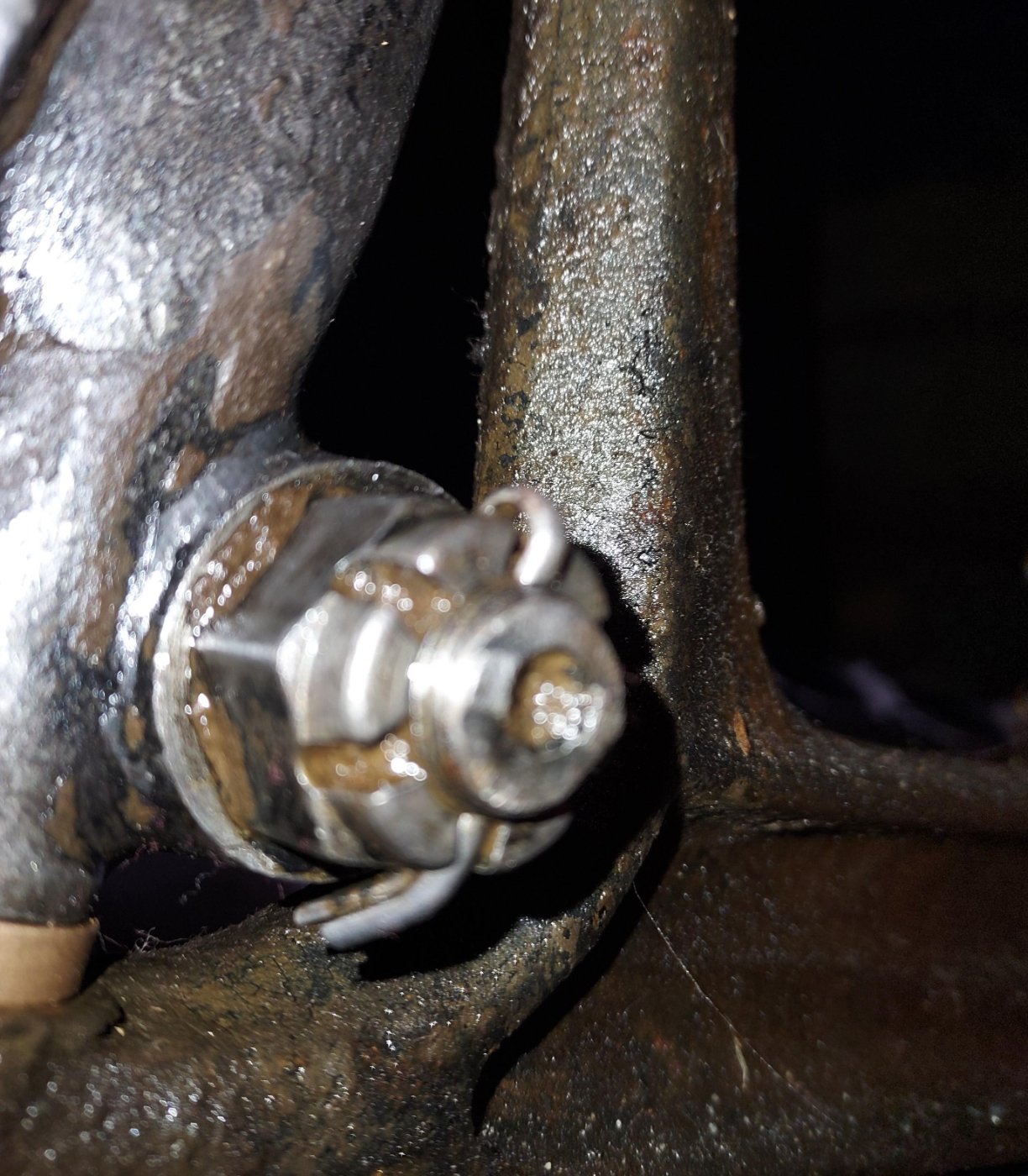

My unrestored 23 T has cotter pins made with equal length legs which would make installation more difficult. The assembly line solution in 1923 appears to be to not separate the legs but push them over as if a single pin. The cotter pin shown in the picture is on the right spindle arm. All the cotter pins I can see have been installed this way.

That cotter pin looks a little new- electroplated, it could have been replaced and the guy did a cheese job on it. The original ones I find on mine have a dull look to them.

The cotter pin shown in the picture, as well as all the others on my car, are unplated, unpainted, even leged pins that have been in the car for 100 years.

Maybe the shine of the flash made it look newish.
