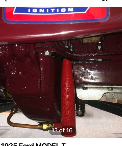

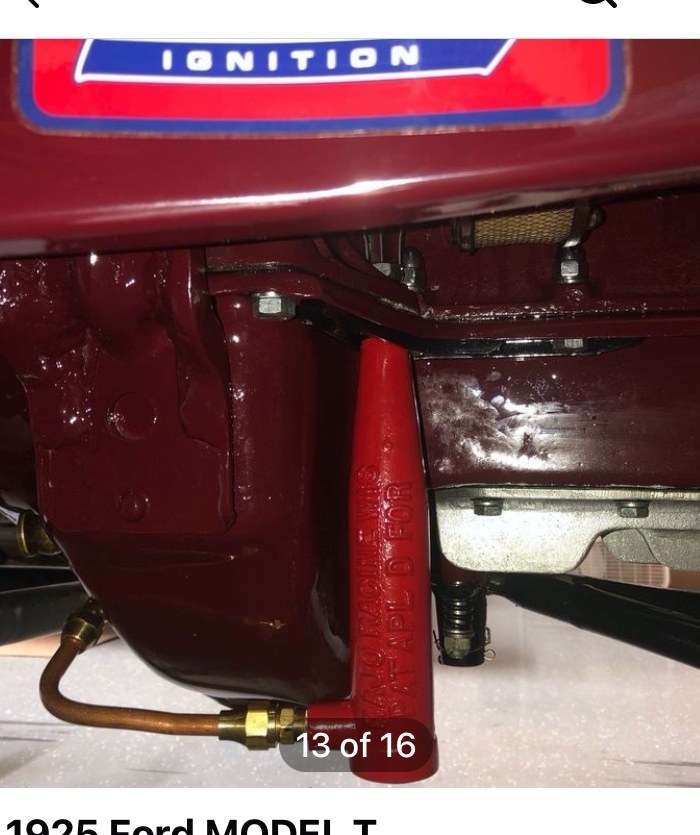

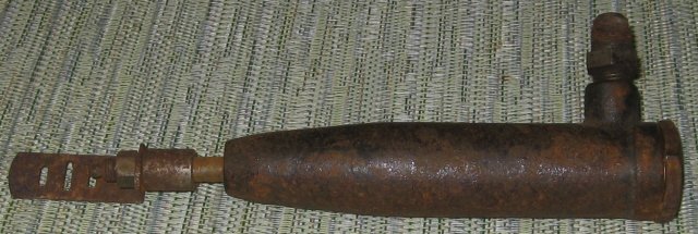

I noticed this Rajo oil accessory on a car listing and was curious, what it would be for? An oil level indicator?

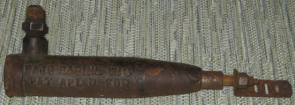

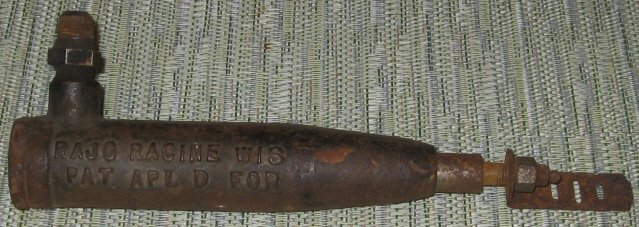

Yes. It checks the oil level. Tim Morsher was at one time reproducing them. Don't know if he is still making them

RAJO manufactured them along with an accessory overhead valve cylinder head.

It uses a cork float.

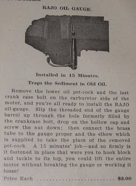

As stated, there is a float inside the casting. The top of the indicator replaces one of the pan bolts and there is a wire attached to the float with a small ball on the end of it that can be seen in the engine compartment. Like any of the sight-glass indicators or the APCO indicator, they replace the lower petcock and give you a static/non-running oil level.

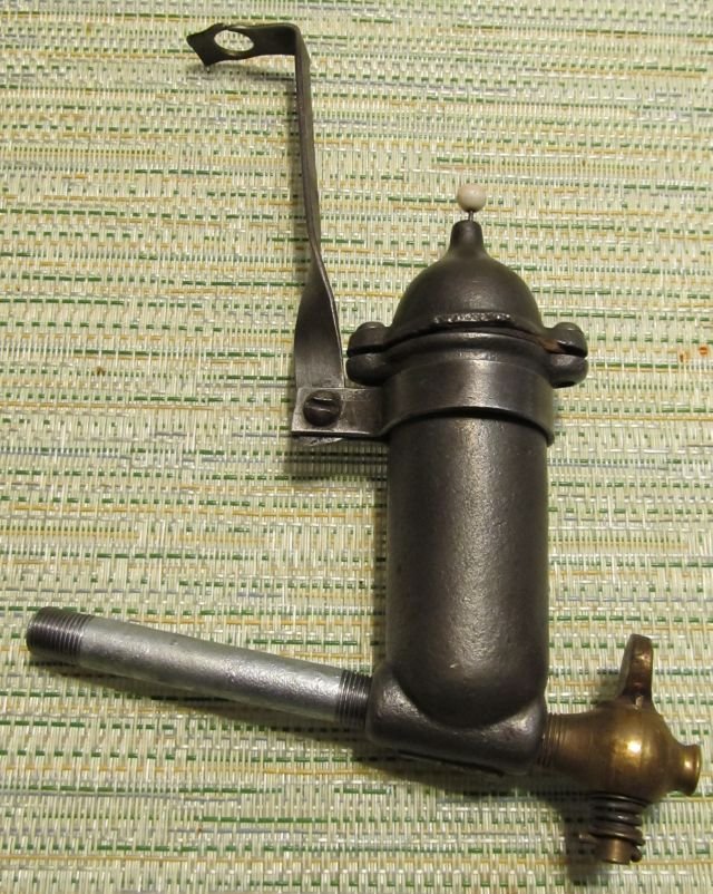

I had one of the sight-glass level indicators decades ago and if I hadn't been looking in the rear view mirror at the right moment it would have been a disaster for sure. The glass had broken and I was leaving a healthy trail of oil. Off the car it came and into the junk box (still sits there to this day).I still have an indicator gauge but now I use an APCO like the one pictured below, instead of replacing one of the pan bolts, it mounts to it with the bracket that is shown (a part that is often if not always missing when found):

Interesting piece. I guess the Rajo R was hidden in the screenshot. Like most T improvements, there are good but bad points to them.
