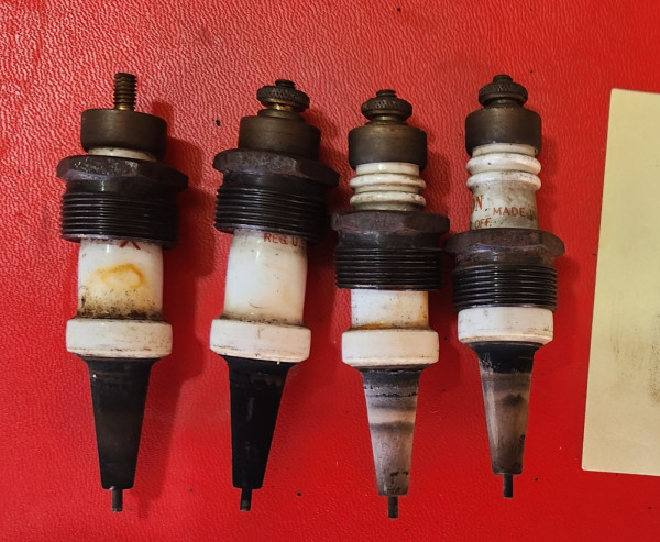

Car starts up and up and runs fine, then loses power & stalls out. Wait awhile starts up, repeat. Plugs look like this. Thoughts?[image][/image]

Not my best post. Plugs are in order. Yellow tag is firewall

Your running problem sounds like a fuel flow problem. Clogged sediment screen?
You dont have a secondary fuel filter do you? @ this point, your plugs are a red herring.

You may want to check for an air leak at the back leg of the intake manifold.

Henry, Sorry for making a quick post but we were headed out the door.
I suggested you check for an air leak on the rear leg of the intake manifold, because the one thing that stands out to me is the condition of the plugs from cylinders 1 and 2, that appear to be running very rich. While the plugs from cylinders 3 and 4 appear to be lean.
In order to get the engine to run, we keep giving it more and more fuel to compensate for the air leak and end up fouling the plugs while others continue to be too lean. I don't think you have a fuel problem, because 1 and 2 are getting too much fuel. It appears 3 and 4 are not, and the common denominator in the equation is the intake manifold. The front leg feeds cylinder 1 and 2, and the back leg feeds 3 and 4.
Also, I would be wary of taking the plugs apart to check them, each time you remove the gland nut you run the risk of cracking the porcelain when they go back together. Better to take them out with the base. Just a thought.

Ignore the plugs. You most likely have a fuel flow/starvation problem causing your stall-out. BTW, it's not necessary, or even desirable, to remove the porcelains from the plugs. Just remove the whole plug without disassembling it.
Most T's have uneven coloration on the sparkplugs. Fuel flow through the intake manifold is not optimal or ideal, leading to richer buring in 1 & 2, than in 3 & 4. If the car runs fine, it's no big deal. Many people get needlessly hung up on this.

I agree with Jerry, there is no need to take the plugs apart. The copper ring gaskets are scarce enough without taking the plugs apart unnecccesarily.
The back two do look lean, and I would be checking the gland ring/seal on the back port of the inlet manifold.

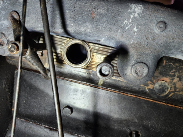

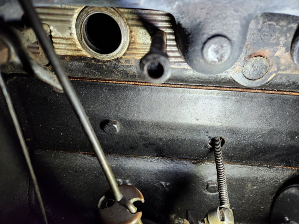

So the rear intake manifold seal is compromised. Is what's there a one piece gasket? Refurbishing that would mean exhaust manifold would have to come off too.
