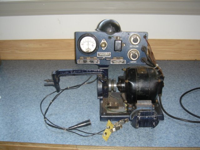

Re: Generator - 1927 versus 1928
The article above can also be useful when testing the generator on a dynamic as shown below.
Now you all have a electrical schemetic of the Allen Electrric generator tester.
Go for it an make one.
Here is a photo of one I built copying the Allen Electric design.....................
If anyone has questions about it I have many other photos of the mechanical details.
Ron Patterson
Ron Patterson
