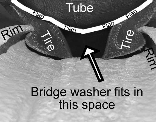

"I also don't like the idea of the tube squeezing down between the edges of the clincher tire from the pressure (60-65 psi) It can't help but wear. The photo shows a cross-section of a clincher tire in a rim. Without the flap I think you'd see the tube bulging down."
I agree and that is why I used flaps (much as I hate them) on my Clinchers. Some old-timers told me the same thing and advised using flaps, even with my new Clincher rims. Flaps can be a bear next time you take the tire off the rim, however. They don't always play nice.

Tim's picture above does a great job of showing why you need flaps (not rim strips) in a clincher tire. Only thing missing in Tim's diagram is what our current tires are shaped like inside- that nice gentle curve in Tim's picture on most new tires is really a sharp 90 degree edge. Those sharp edges will make short work of a tube. You won't know why because the tube will explode once the tire deflates, and the common reaction is to blame the tube.
