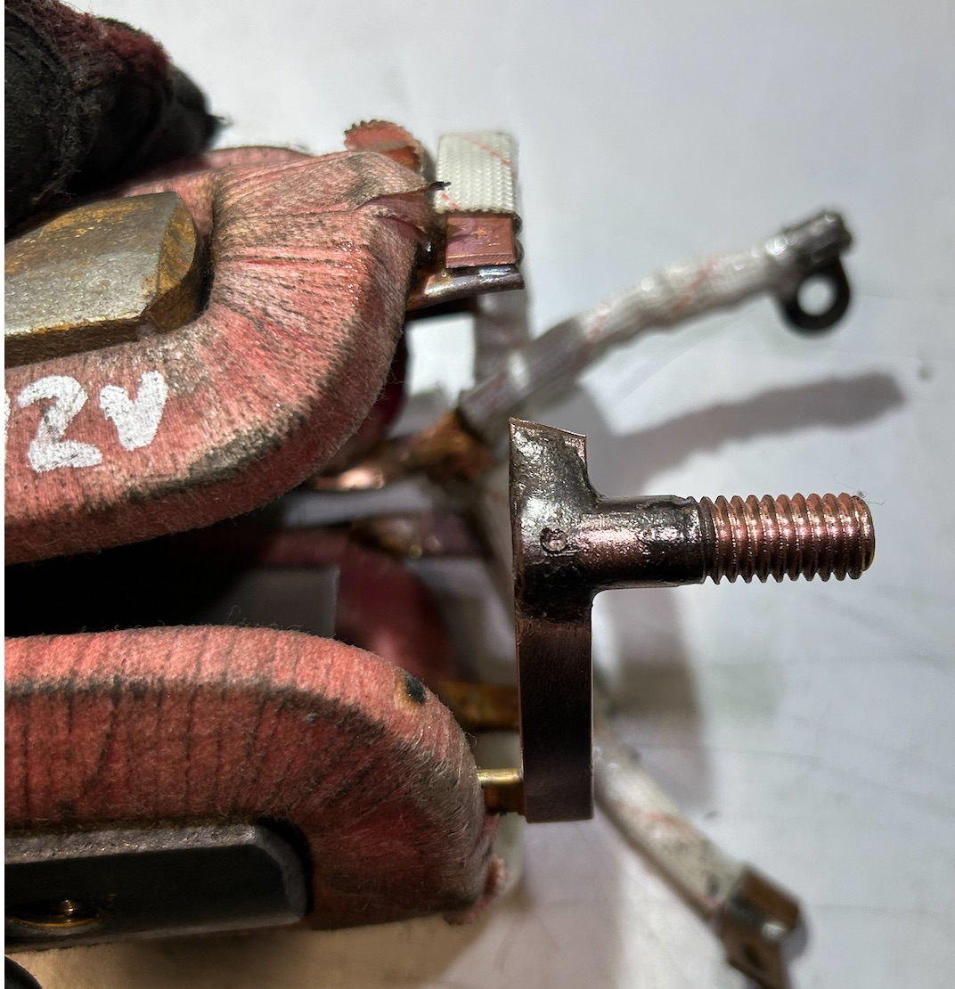

Post by AdminJeff » Mon Feb 24, 2025 9:02 pm
As you may suspect I've installed hundreds of new field coils in the starters I rebuild. How do I get the post silver soldered to the field winding bar and do it without burning up all the insulation? And NO through rod is required when you do it this way. Silver soldered joints do not break free.
They last forever and ae infinitely stronger than regular soldered joints.
Im all about sharing knowledge. It's what makes this hobby so much fun.
Here's my secret. Not exactly what you would think or expect from a spot welder!!! So here's my tip of the day for starter post installations:
https://m.youtube.com/shorts/4QUmjEpBvvo
A decent SILVER soldered joint that will literally outlast your car.
