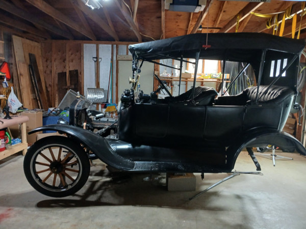

So far, nothing! However, I will be getting getting our 1911 off the jacks soon and get it back on the road since spring is arriving in Kansas after a long winter.

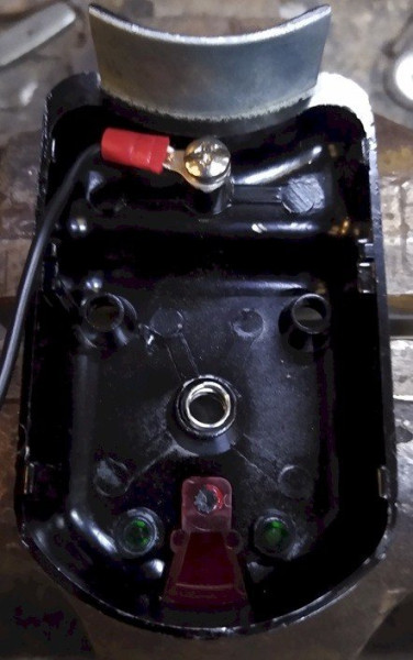

Finally cut the choke rod and re-drilled the hole for the knob.
Moved the bracket higher up, away from interfering with the hot air tube.
Cut and installed a wire to the carburetor.
Cut the floor boards to make more room for the pedals to travel. (They were sticking.)
Added a ground wire to the turn signal switch.

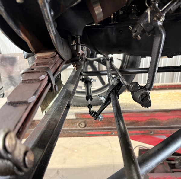

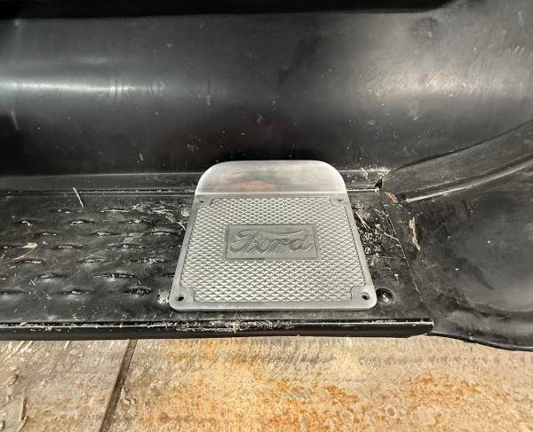

Finally got a break from other work and decided that the fix for my front end shimmy was to add the steering stabilizer. I also put the step plate on. i wanted to get the holes drilled before I decide that I will finally start doing some needed body repairs. I also installed a fan hub with the sealed bearing .

I'm glad you have the shimmy fixed, maybe you can drive that or the 27 runabout in the forest this summer? See you soon.

Yeah, I was at my wits end with the shimmy. I’ve been through the front end top to bottom and cannot for the life of me figure it out. This was my last ditch effort to solve it. I’m not a fan of it so much, but it has to be better than what I (we) experienced on the fall tour through St. Charles on the brick streets. The only way I could control it was to come to a complete stop and then start rolling again. The first time it happened was on the St. James overnight tour, that scared me being 100 miles from home. It sent me down the rabbit hole of new parts. I saw several cars struggling with the shimmy last year on the Trails Less Traveled tour in San Diego as well. It was pointed out to me that I will need to keep an eye on it, since it does add a stress point that the steering was not designed for. (Thanks Scott C). I gave it a lot of thought and decided that it was worth the risk. I’ll see how it does at the St Paddy’s day parade next week. I hope to see you there.

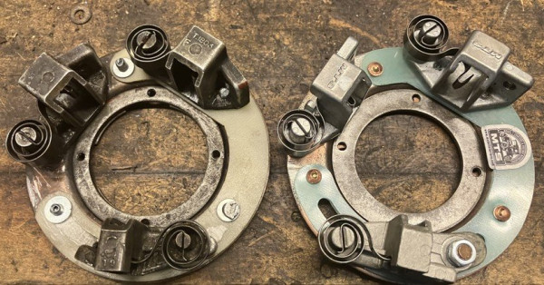

You asked.
Just when I thought I was out, he pulled me right back in again.

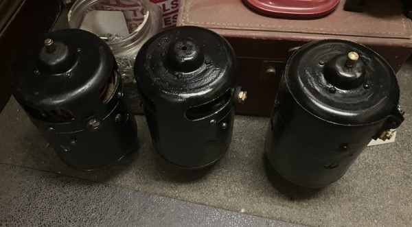

I rebuilt four generators for my cars. I didn't rebuild a fifth or more because I only had a 1919 brush plate and I ran out of parts. I replaced the 1919 insulators on the plate but am inclined to leave it on my shelf as a conversation piece. Generator #1 is already installed. My job before retirement taught me the value of traceability so each rebuild is stamped on the pole screw with a number that's visible when it's installed. I created a spreadsheet that details the bearings, insulators, fields, and whether the armature was professionally checked.
My son told me it would be nice to have a starter generator engine for his use and I found this online. New brush plates are available for purchase outright without me having to surrender the antique one.
I'm on a temporary break because my Craftsman tie rod tool bit shattered while removing a pole screw. It will be interesting to see if I can find a place that will replace it.

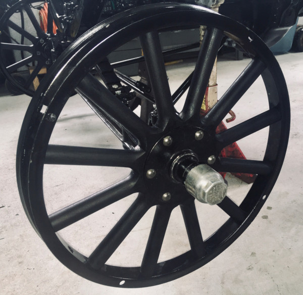

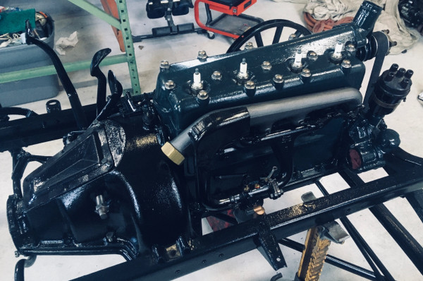

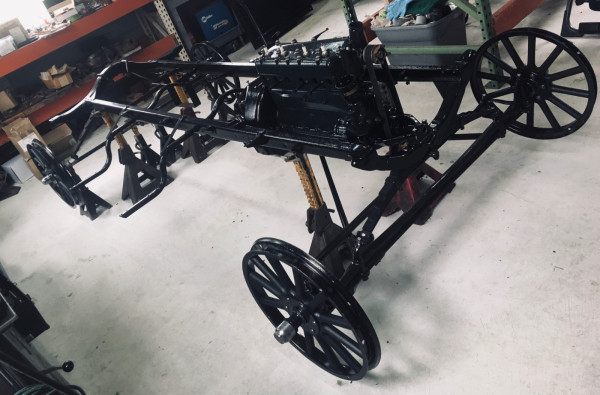

I got my wheels refinished and my engine back together, now it's just the rear end!

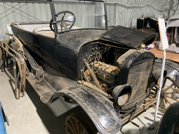

I am working hard to complete a mechanical restoration on a very original 1925 Model T that is about to celebrate its 100th birthday. Built new in Geelong ,Victoria, Australia, at the new Ford Australia company's temporary factory, I will take this car back to the city it was built in, for the biggest Ford event in Australia, the All Ford Day. This year the All ford day will feature the Centenary of Ford Australia and their first product, the iconic Model T.

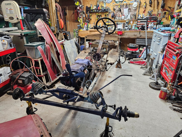

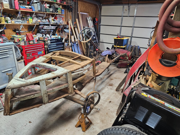

Taking apart the speedster to replace rotten wood. Full frame teardown to repaint. Took apart the diff. after water poured out when I went to top it off. Cowel off for rust repair and frame/suspension work. Valve job on the engine. Need to get it ready for July car show.
