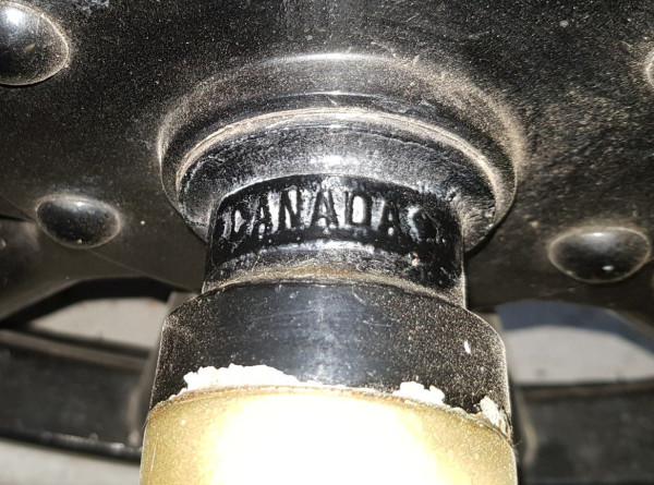

Re: Any Differences Between 1926 Running gear U. S. vs Canadian?
"Made In Canada" marking on parts not already mentioned that I have seen includes hub caps (wire and wood wheels), water inlet, running boards, generator, and starter.
You didn't ask but I will tell you other differences between Canadian and USA made Model T's includes the square drive Robertson head screws, tail light, horn button in center of steering wheel, front license plate bracket.

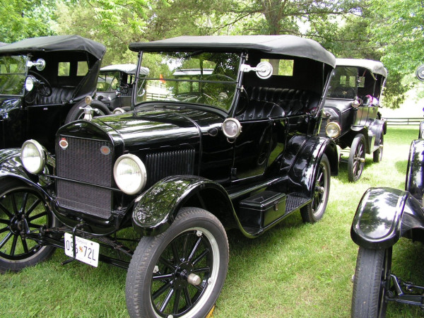

A 1926 Canadian Model T.
- Posts: 7292
That one has electric cowl lights. I have never seen another on any of our Canadian built cars here in Australia. Perhaps a particular Canadian province demanded them.
