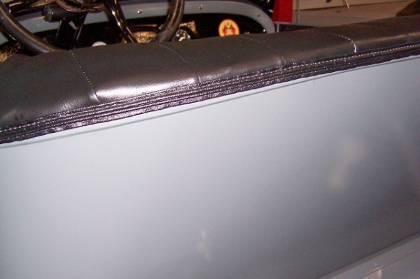

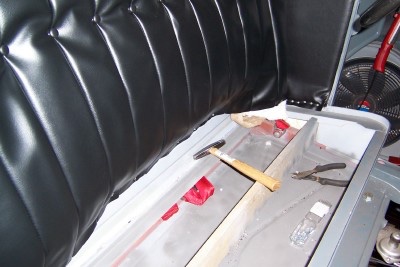

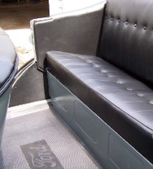

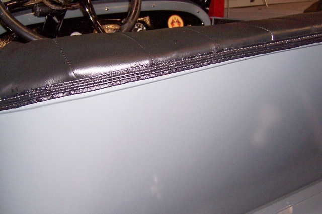

The wood work on the 26-27 is easy, the tack strips as you noted are not, as the factory used multiple pieces and steam bent them to fit. Have found the modern plastic strip the better, it heat forms with a hot air gun and you bend it and bolt in place. It holds tacks great.

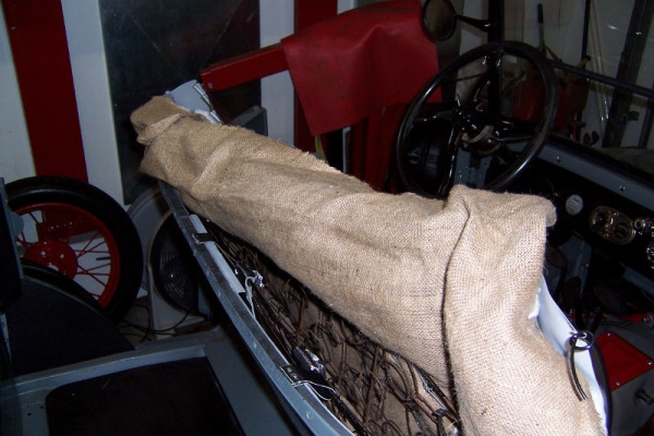

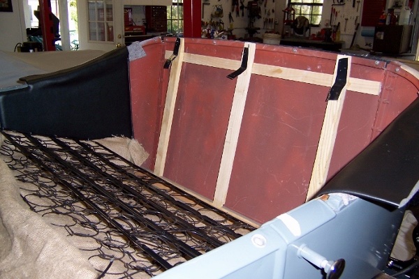

These photos may help, it's a 26 touring, but upholstery method is very similar, the photos are mix of front and rear seat backrests.

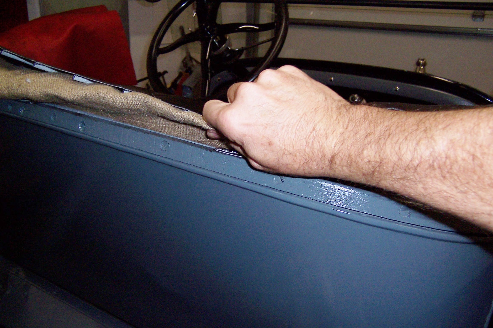

Do the seat cushion first, so it can be used to determine the lower part of the spring, you don't want the lower part of the backrest spring to not leave room to slip the seat cushion under it, nor too much a gap of the backrest spring is set too low.
As with all upholstery work, used tacks, and that way you can pull tacks and move the material where you want it. Isn't a determined measure of where to mount the backrest spring, that is judgement. The spring will be hung from strips of material that you can then pull up or lower and then tack in place when you like the spot.
I like to hog ring the spring to the backrest material in a few places, to make it easy to pull and adjust, but still keep the spring level, and centered in the backrest material, that you have marked a center line. Install the hip pads prior.
Hang the spring, tack the lower part of the backrest upholstery to the lower wood, then pull up and over to the upper tack strip, adjust as needed.

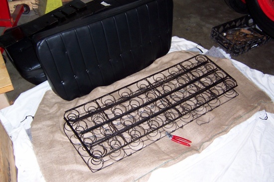

A few more photos.
It's important to bunch the excess material, some times more padding is needed, to the top of the backseat spring. That fills the void and gives good support. Otherwise there will be a sag and look won't be correct.

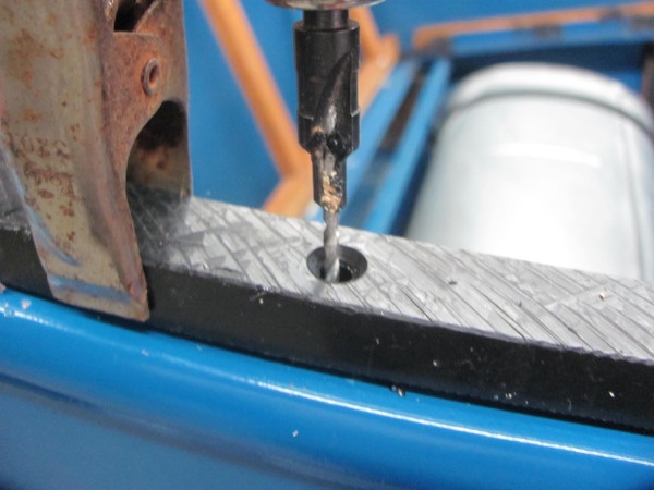

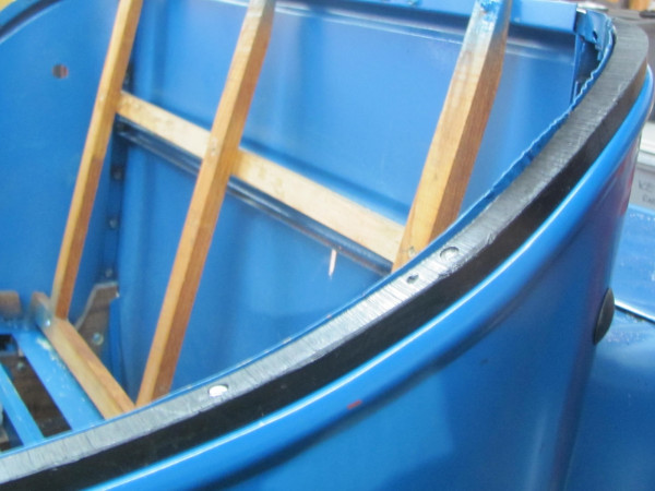

Tom

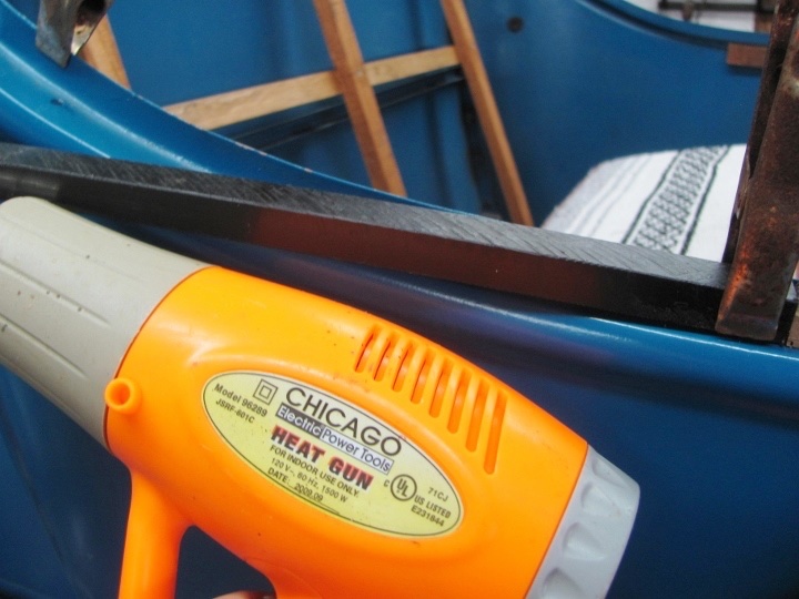

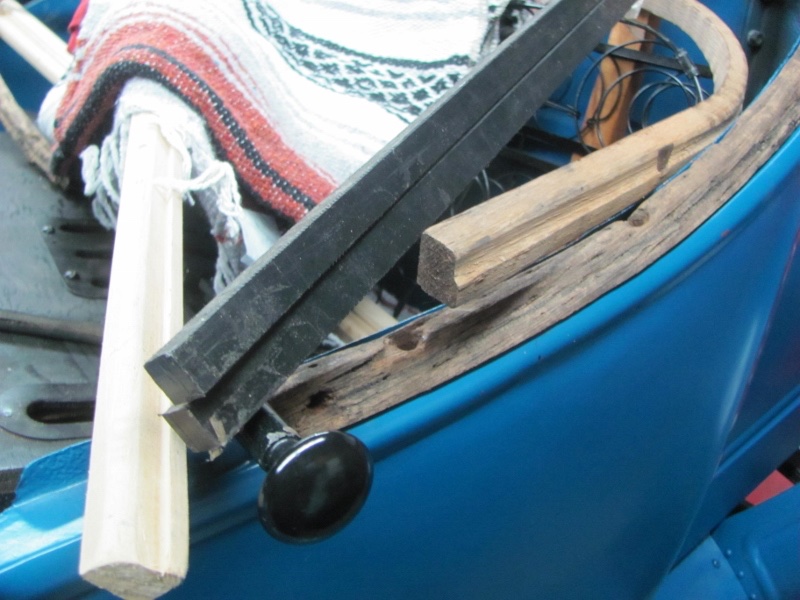

Respectfully, experience for me with the plastic has been very good, first use in 2001, and still is fine. Have done several T's with plastic now.
Original tack strips are normally way gone for use, have tried the vendor pieces, but they never fit the complex curve up and down and in on the backrest metal. Even tried to do my own by routing the edge like original, but forming after steam soak, the wood just would not lay down on the body metal channel.
The thermo black plastic rectangle strips sold by Lang's work the best for a non-woodworker like me :?
Easy to shape and go, drill and bolt down, heat and advance to the next fastener point, and around the body channel with ease. Really holds the upholstery tacks great, no splitting like wood does.

Sure don't think any trouble, the tack strip will be heat formed to shape and fit the drilled holes in the body channel as first installed. This plastic is rigid, except when hit with hot air gun at 300 degrees. Will keep the shape after forming, as it is a thermo set plastic.
