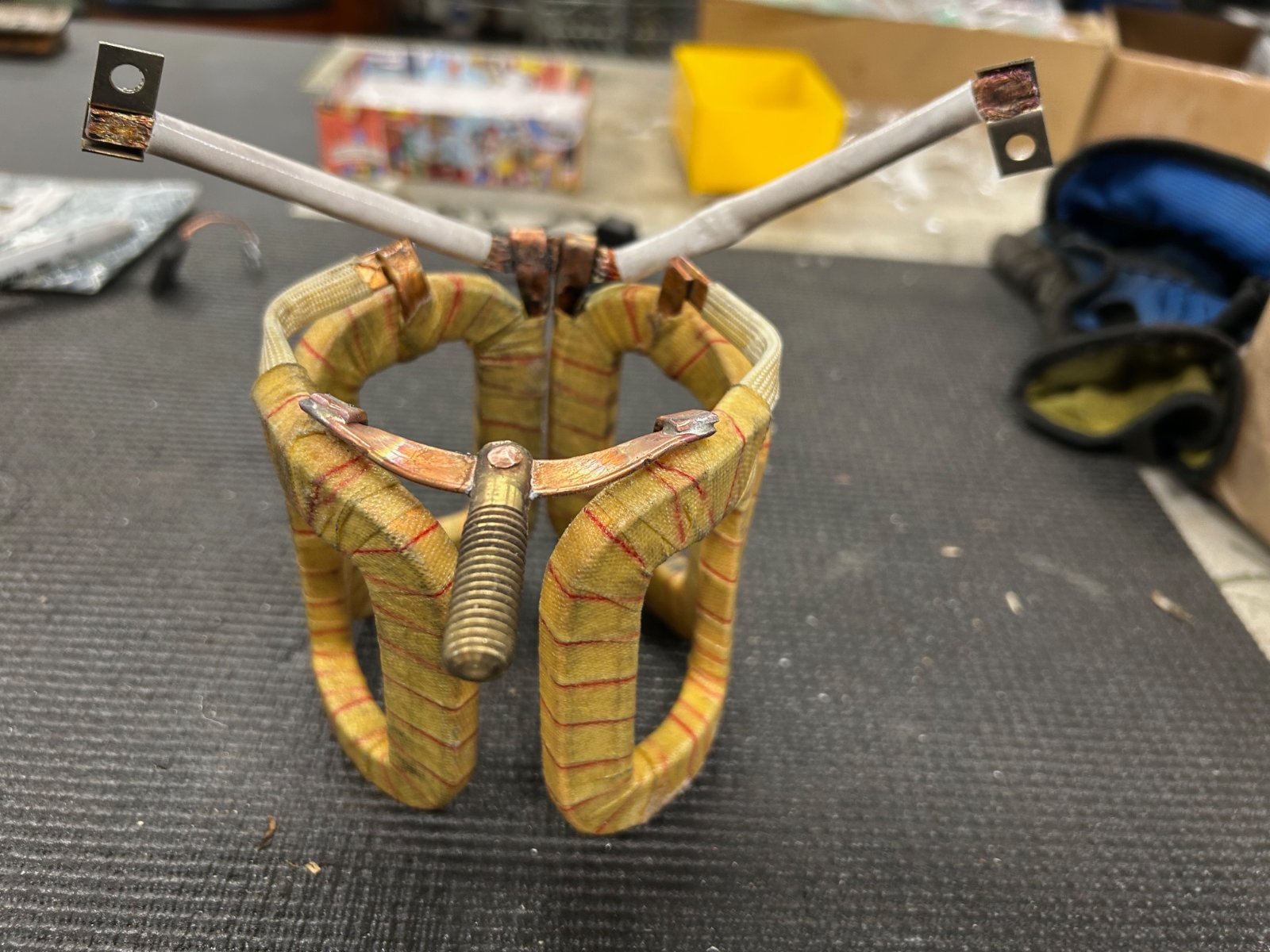

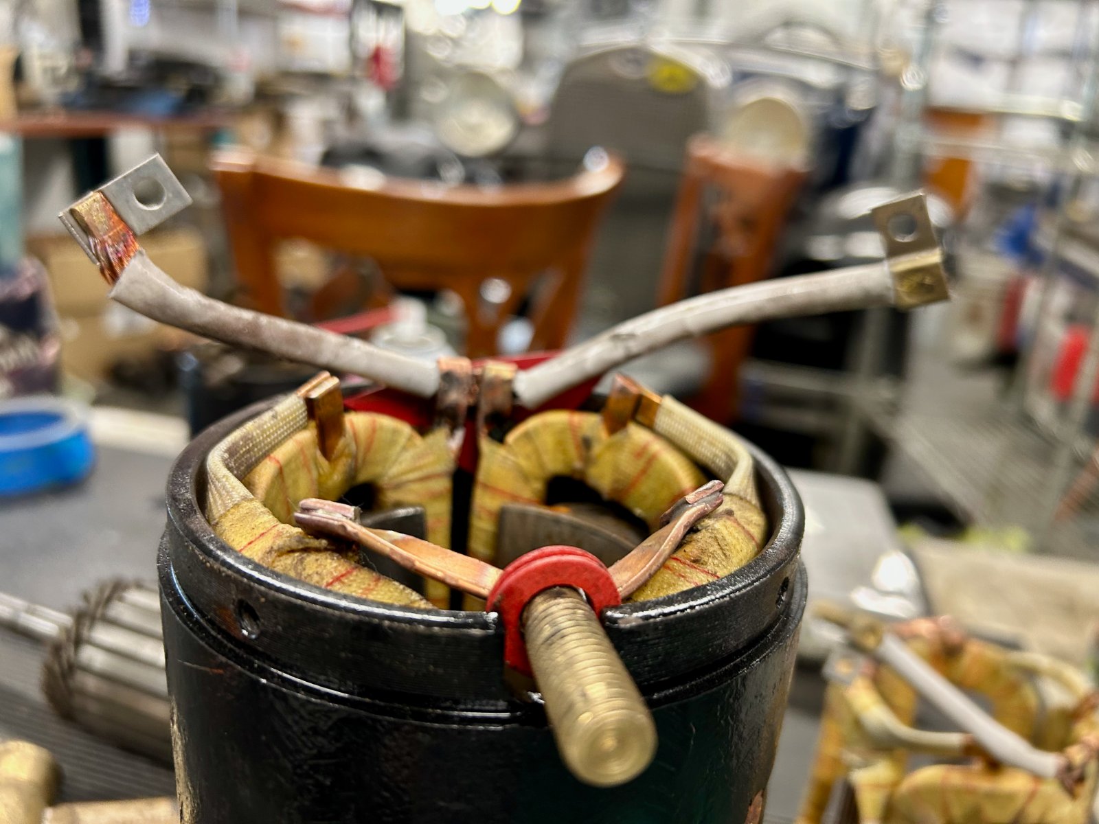

I'm now making both starter & gen field coils, brushes, springs, post bolts, brush holders, brush plates, everything. Starter Field coils will have the copper (not brass) post silver soldered & pre-installed. Initial testing by myself and others shows them to be equivalent and in some ways vastly superior to the Wilson coils we're currently stuck with using. If you can even find one.

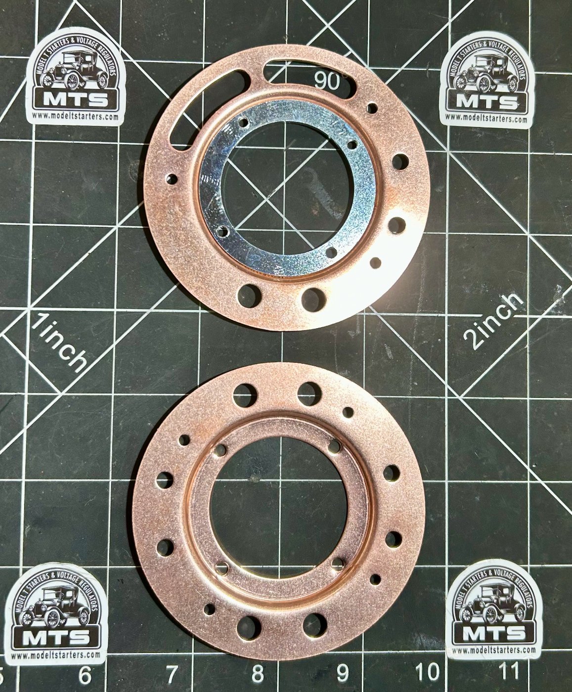

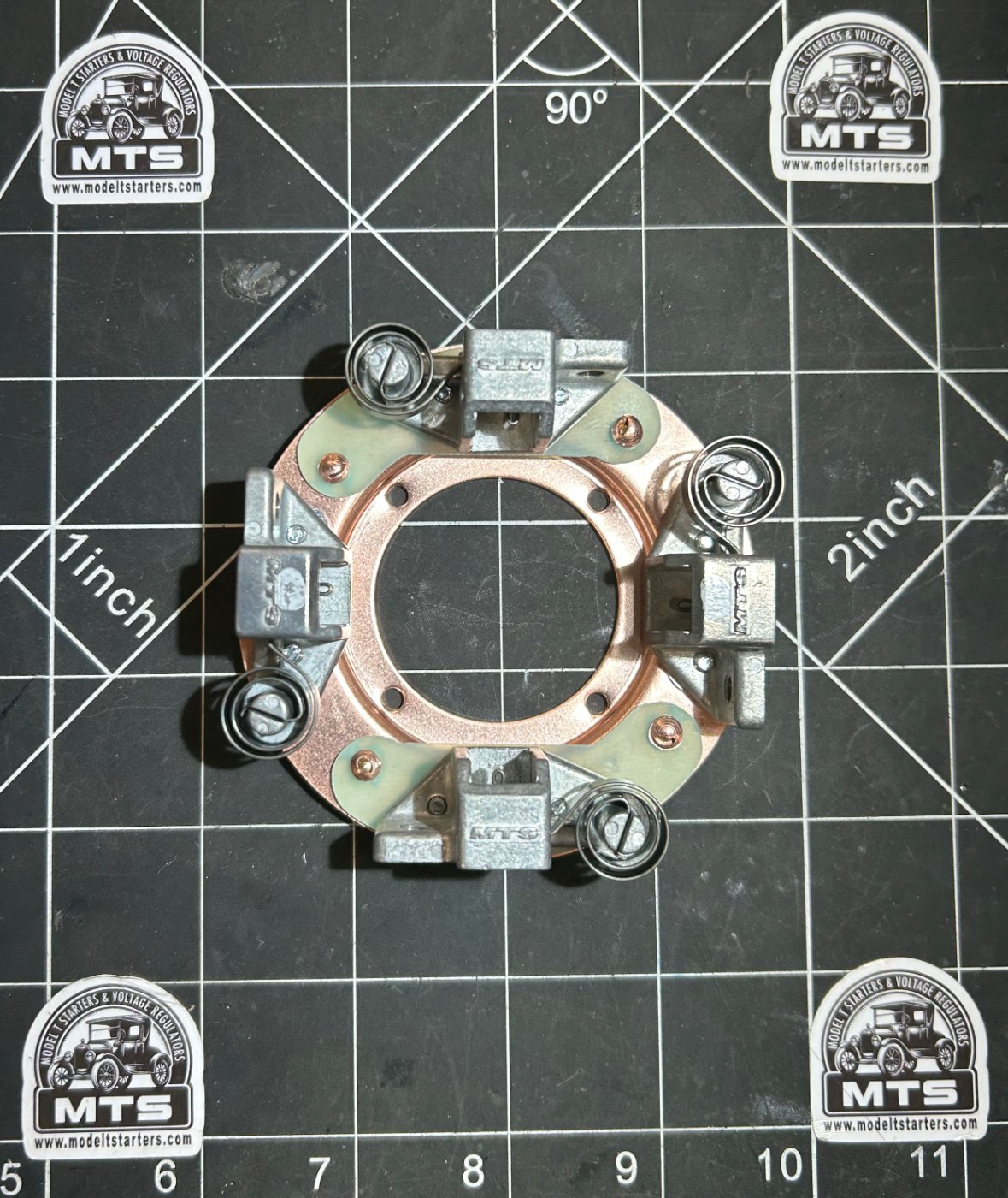

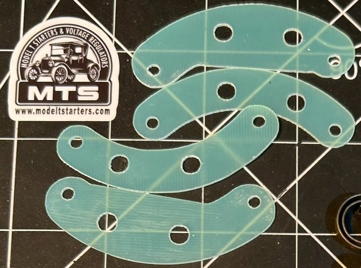

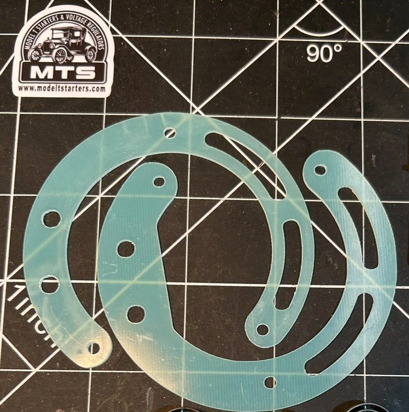

I'm also reproducing both brush plates and adjustment rings - they came out great. I also had them copper plated for superior conductivity. You gotta get as much of that energy from the battery to the starter as possible.

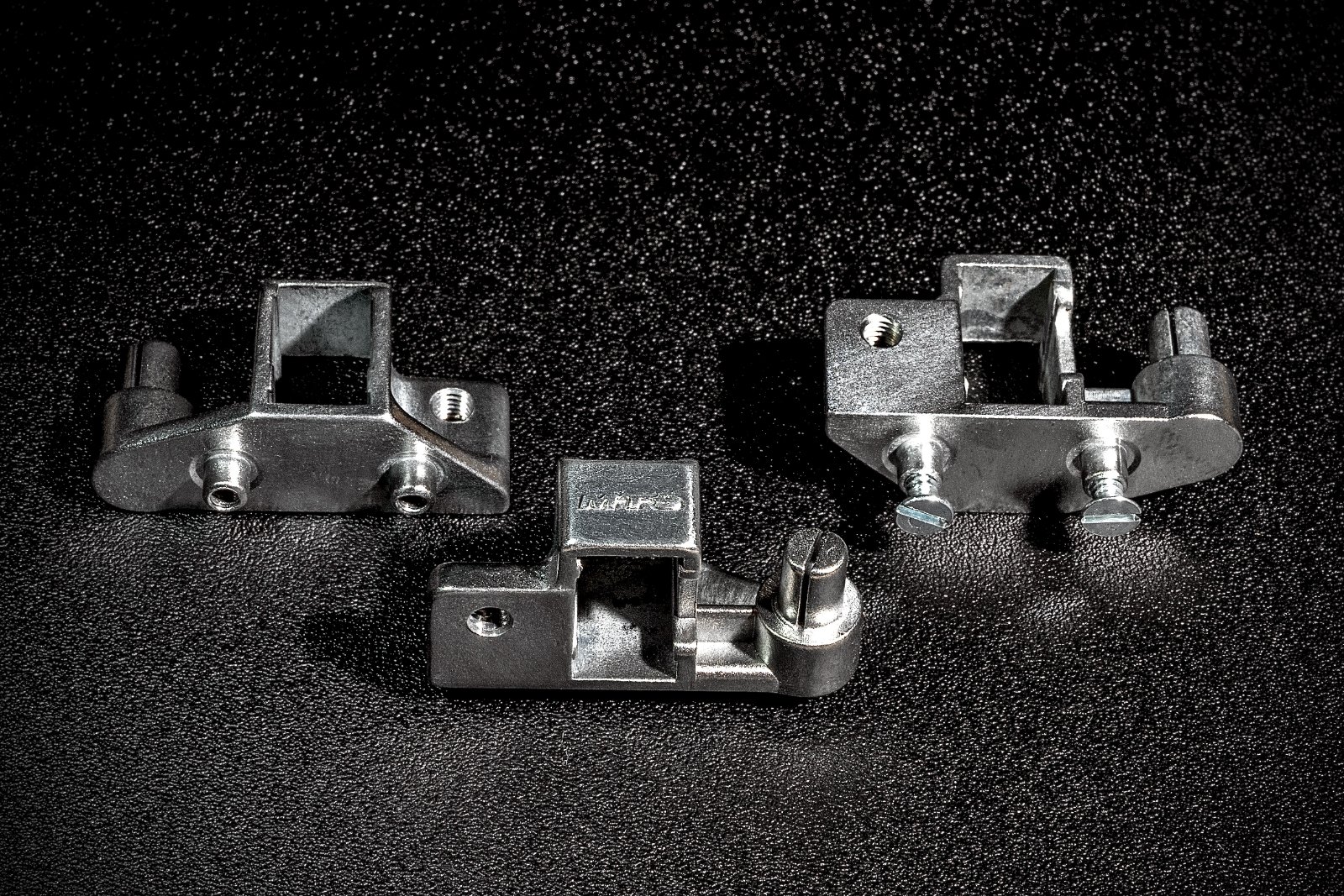

Zinc cast brush holders w/ reinforced screw receiver & pre tapped & drilled posts

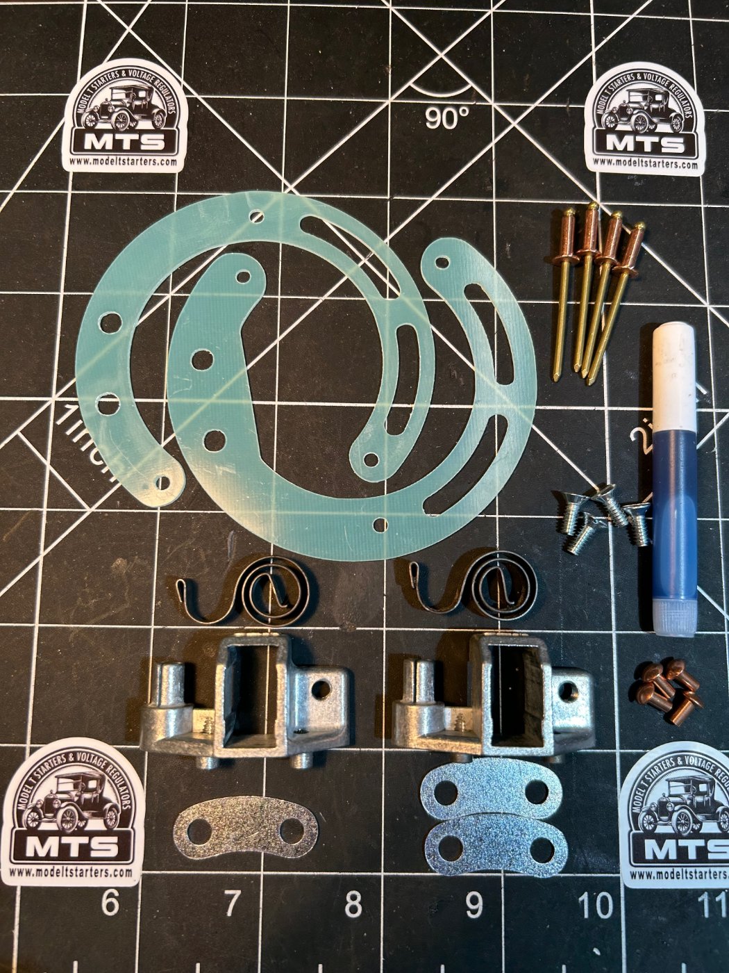

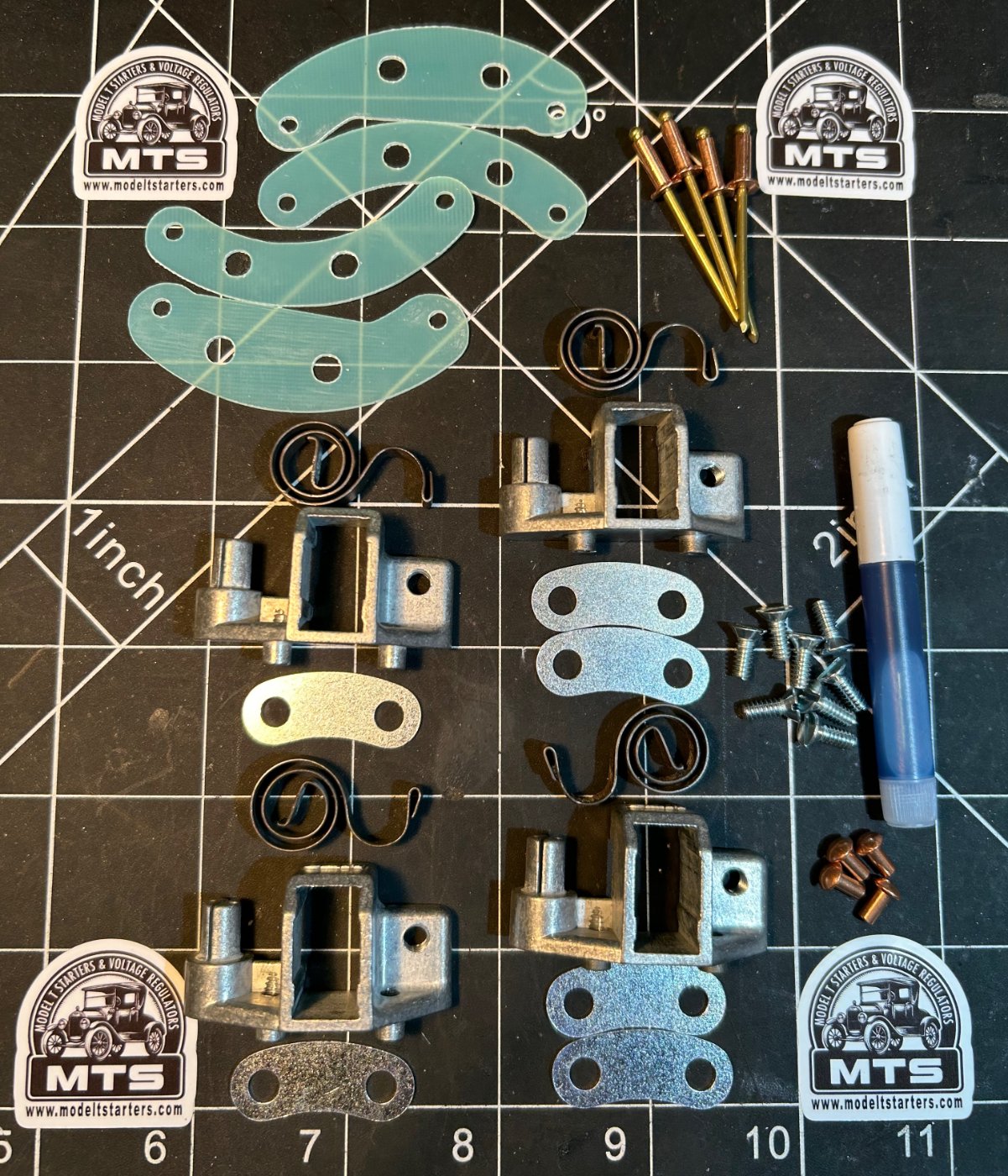

I'm also putting kits together that contain everything needed to do full rebuilds

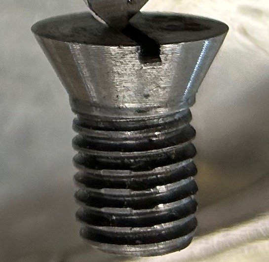

pole shoe bolts.jpeg (56.03 KiB) Viewed 1670 times

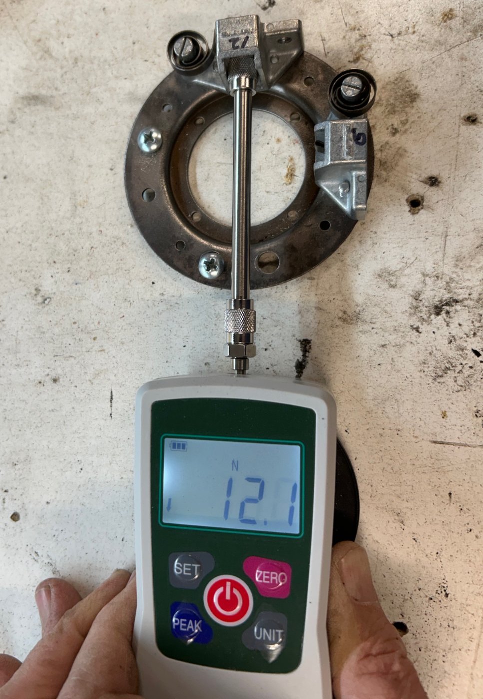

Did you know that starter springs have twice the force as the generator spring? 12 Newtons vs 6 Newtons.
