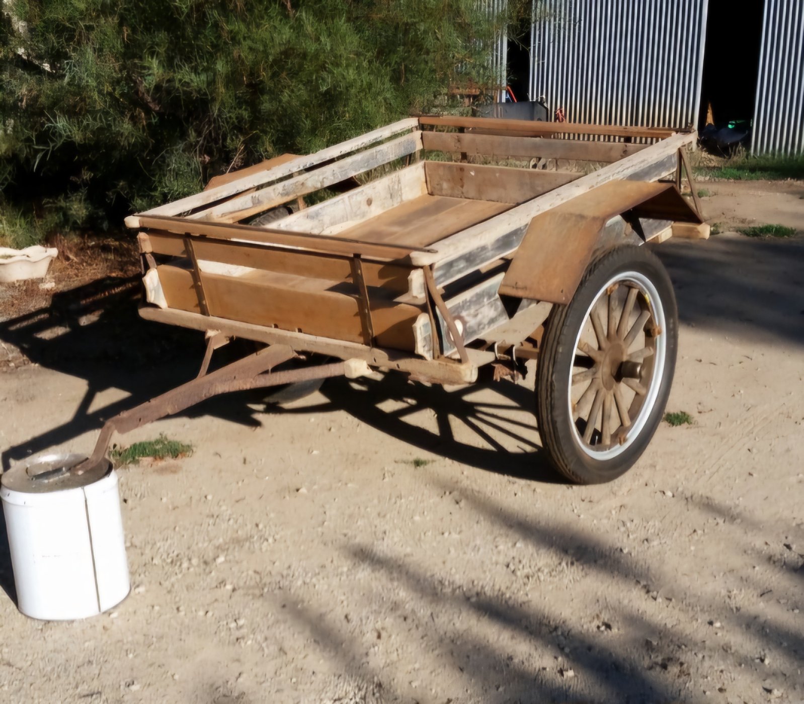

Here's mine. When I found it there was a late 20's Buick front axle and wheels under it, which the owner wanted to keep.
I had a blacksmith made square axle that took Ford wheels to replace it.
I replaced a couple of boards, spliced another to a broken side, and have left it as it was. I just need to make a hitch to tow it behind Henrietta. The drawbar is actually a model T frame rail. Allan from down under.

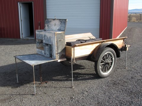

Here is a picture of mine ,set up with the tongue retracted. I built a retractable because I have a new knee from falling over the tongue on another trailer (obviously the trailers fault)

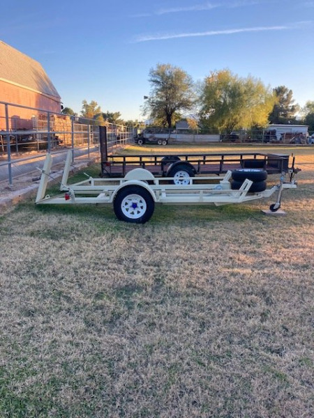

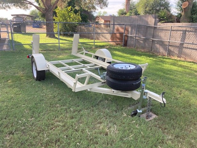

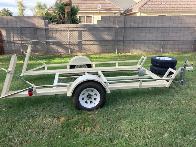

Hi Chad, I tried to post pics but they would not load so I will try again.
This is the speedster trailer I purchased from Joel it is one of two that Tommy Brawner built. It is only 500# & tows very nice. Don't have plans
but your car will dictate the dimensions. The two spares are mounted on the tong so it tows better empty.

Craig, those are nice trailers. Being able to run the car up on up to a permanent stop makes tying the car down easy. All the tie downs do is hold the car against the stop. I have built five similar ones for myself and others. Mine do have a complete floor. It makes them mush more useful for other stuff, while adding little weight. Can you imagine how easy it would be to manually push/manouvre that trailer around without having tandem axles fighting against you. I do chuckle when I see two spares on a two wheel trailer though. How many people carry 4 spares for their car? In my lifetime I have can remember having just two flats on my trailers. The one spare has always been enough, although I did replace one while on tour, because I had more than 3000km before I was home again. No point in pushing my luck that far.

Re: Model T Trailer plans/ideas?
Hi Allen,
I do catch some flack over the two spares. I wish I could say the same when it comes to flats but my Tandem trailer has had two flats in a
single trip twice & three in a single trip once when the EX & the HIL borrowed it. In December I had a flat on a trailer tire that only had 400
miles on it. If I'm going very far I carry two spares. Having to unhook & drive to the next town & find a place to buy & mount a tire in the
middle of the night can just plane ruin a trip.
Chad,
I have never had a single axle trailer with brakes. My tandem has brakes on both axles because I sometimes haul the M-F on it. I wish you had
said something when you were here I have a drop axle with brake flanges & springs I picked up to make a trailer before I bought this one.

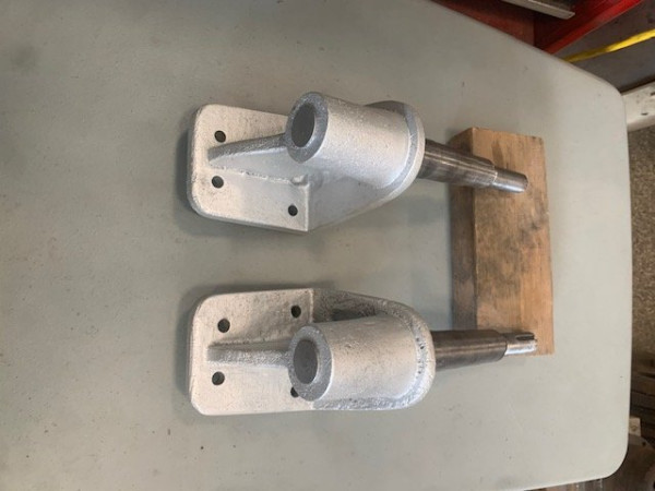

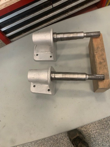

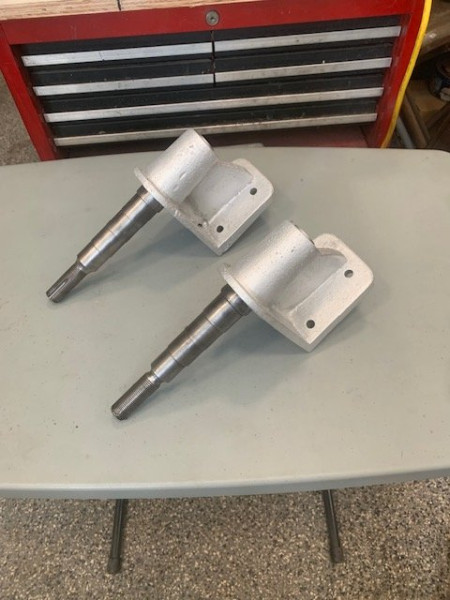

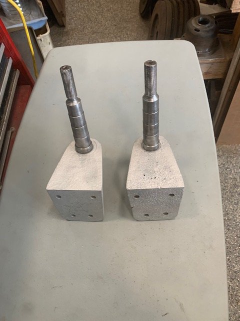

For about forty years, I have had these very unique spindles. They were attached to a wooden beam with T front wheels mounted. I recently took the wheels off, cleaned, bead blasted and primed the brackets intending to sell them. They are nicely machined to spec, T front left and right thread spindle shafts cast into a robust aluminum bracket. I have no idea who made them but I am impressed with the quality of manufacture. I have not chosen a price but, if anyone is interested, send a message with your phone number and I will call.

I just realized after paying attention to the subject, that it was about hauling trailers, not T towable trailers. Oops.
