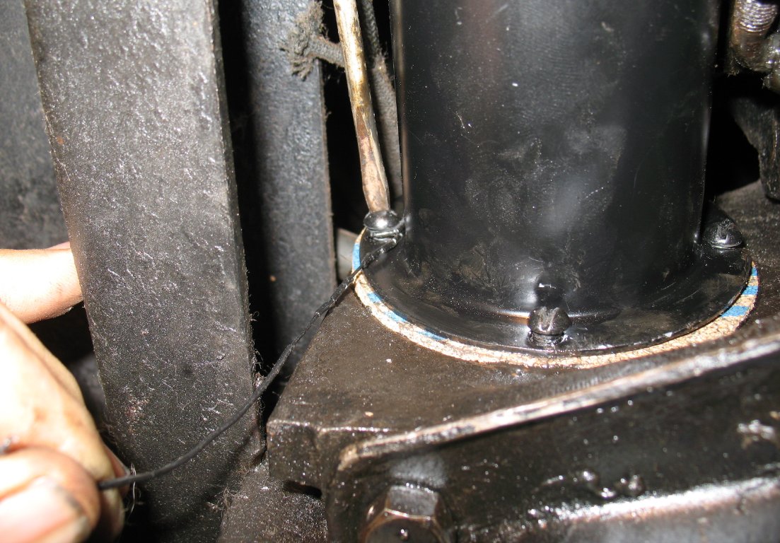

Nobody asked, but I'll show how I get them started with a long screwdriver. :)
