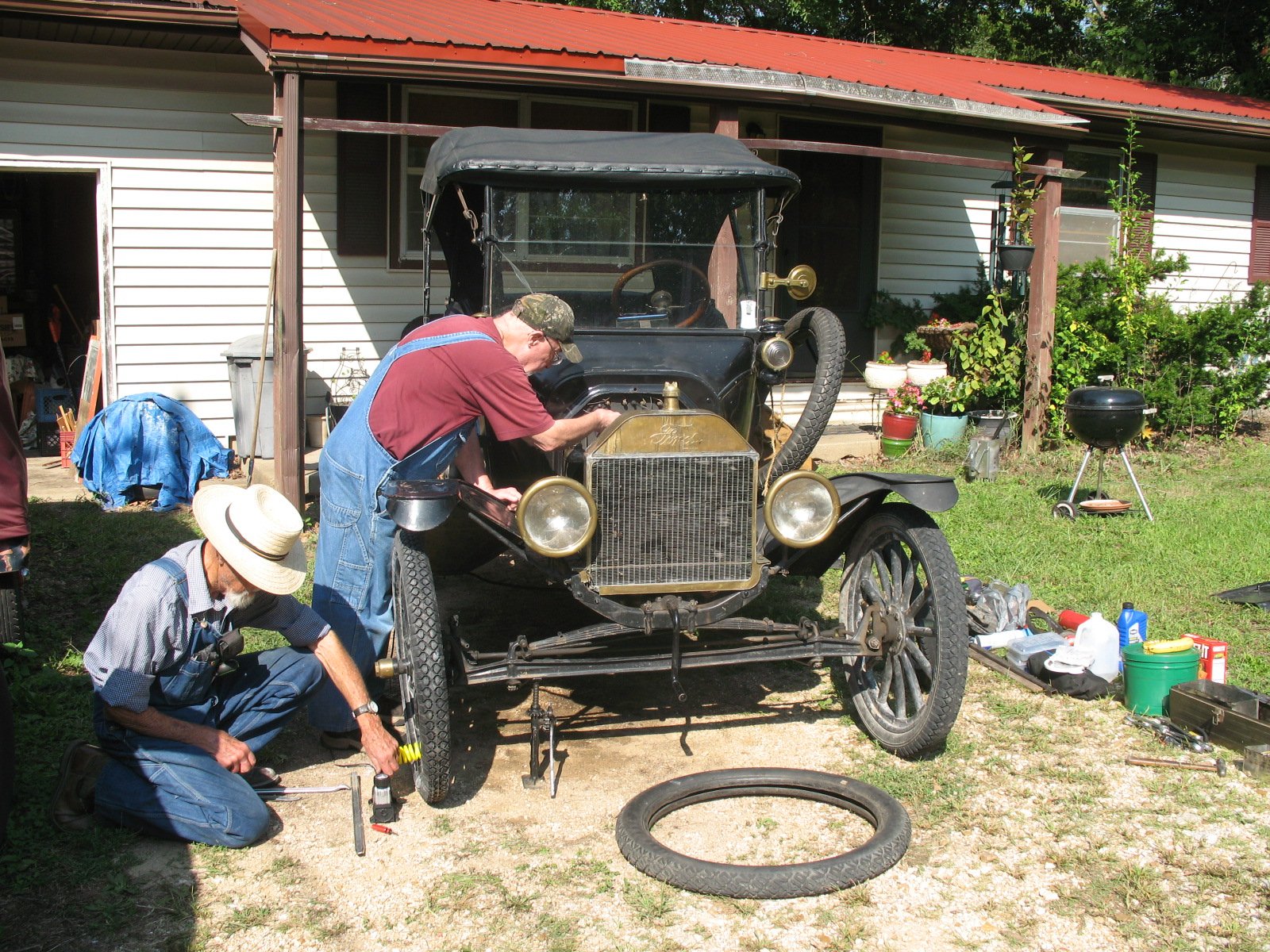

Re: Changing tires
From personal experience, it is substantially easier to remove and mount a clincher tire with the wheel on the car instead of the wheel or demountable rim on the ground or a bench, etc.
If you have demountable rims, move the rim to the front wheel if necessary as there is more room under the fender.
Click on this link and scroll down to Royce Peterson's tutorial on how to mount a clincher tire with the wheel on the car:
https://www.mtfca.com/discus/messages/1 ... 1325091009

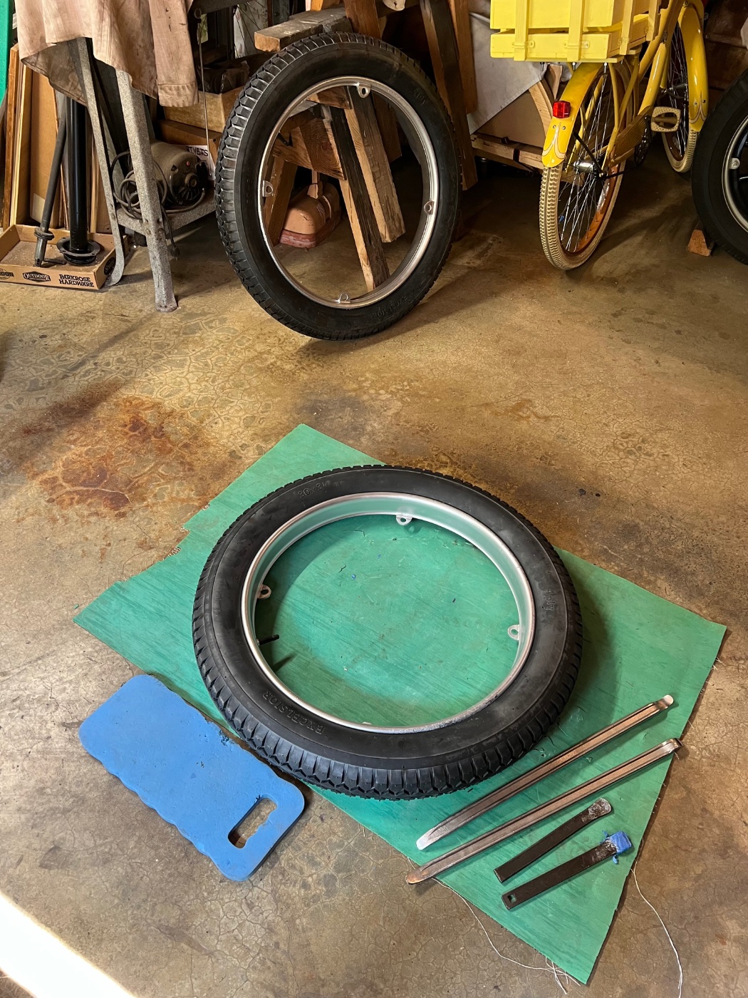

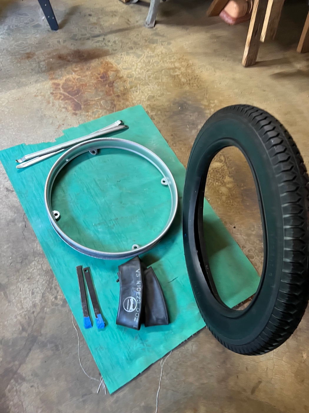

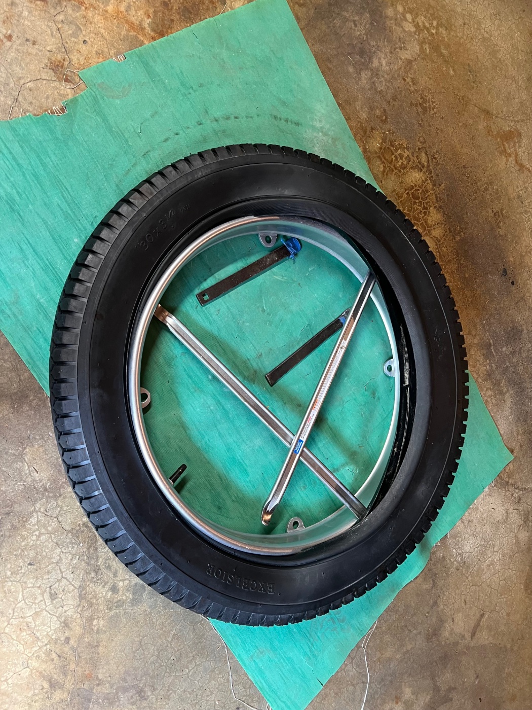

Re: Changing tires
The picture montage should be helpful to you.
Early on I used flaps on clincher tire installs.
Flaps do add a bunch of extra protection against pinched tubes. Without flaps, you have to be extra careful.
The garbage bag video method using only your hands is on drop center tires. (21" wires), not clinchers. Not the same.
I do install both beads @ the same time for all T tire types.
- Posts: 7376
Re: Changing tires
I have not seen a decent or pertinent video of an install with clincher rims.
When I first got into this game, like all new guys, I found mounting tires quite a struggle. Eventually I got into Model T travel, which means covering lots of miles. It also means an occasional need to change a tire. I guess practice didn't make me perfect, but it got me to the point where changing a tire was no big deal. If I ever have the opportunity, I'll make a video. Until then, I'll just tell some things that may help.
I prefer changing a tire with the wheel ON THE CAR. Let the weight of the vehicle work for you.
I agree with using HF two-foot irons. Little Ford irons make changing tires the job from Hell. Mister Archimedes tells us that a long lever makes prying easier.
Lubrication helps, but the lack of it isn't a major impediment. I use baby powder. Talc or starch? I don't care.
Procedure summary:
Jack the wheel off the ground. Position the stem at the bottom and lower the vehicle only enough to keep the wheel from turning.
Starting at the top, pry the tire (both sides) off the rim. Raise the vehicle and extract the tire.
Installing is easiest with the tube in the tire, inflated only enough to keep it in there. Again, the stem hole should be at the bottom. Put the stem in the hole and lower the vehicle only enough to keep the wheel from turning. Beginning approximately at the four o'clock and eight o'clock positions, pry the tire (both sides together) onto the rim. Inflate to forty pounds, completely deflate to let the tube find its position, and inflate to running pressure. I use 65 psi in front and 70 psi in the rear.
Did Ford use flaps? Neither do I. I do make sure my rims are excellent.
George is checking the wiring while I inflate the new tire. After trying various methods of inflating tires, I finally settled on a HF compressor and a 12 volt battery to run it.
