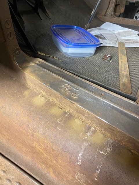

Two easy ways to tell them apart. The front door posts on a 26 are offset at the top for the front of the door. The 27 go straight up. The door sills on a 26 have an aluminum plate with the name FORD on them. The 27 does not have the plate. The name is right on the steel sill.

If the doors are original to the car, the side curtain post grommets will be stamped into the door skin. In ‘26, they were separate zinc pieces. Also the the latch in the door is not square and has a raised portion to grab the curtain post. Look at a ‘28 model A latch, it has same configuration.
The gas tank on the ‘26 has two canvas straps riveted to the firewall. In ‘27 the straps were replaced with a dished cardboard panel.
If you have a ‘27 body, several of the wood pieces won’t be used.

Thanks for the comments
Here are some pictures of the sill.

Here is a link to one of my older posts on how to identify 26/27 roadsters. I hope it helps you.
viewtopic.php?f=2&t=3730&p=81137#p81137
