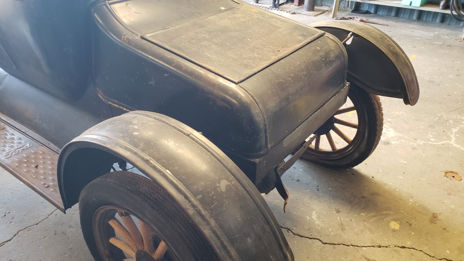

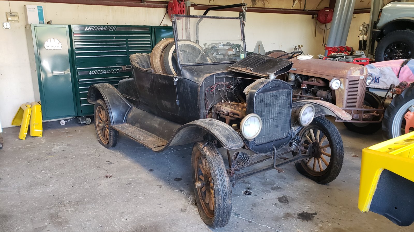

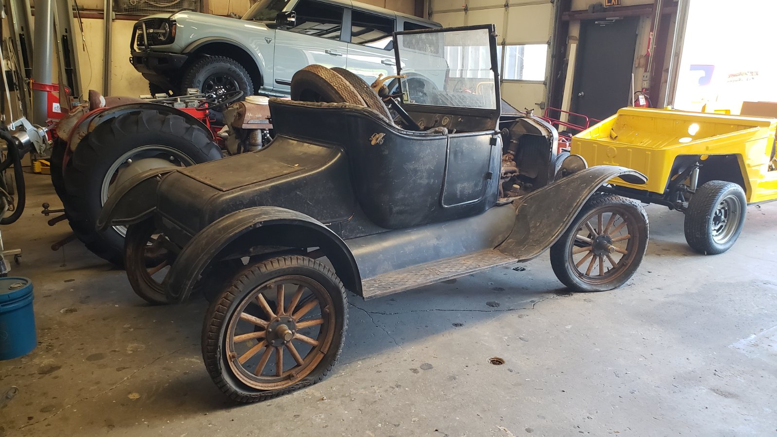

I just bought my first Model T and need help identifying the year.
It is titled as a 1926 and the number on the engine is from 1926. (140?????)
However, someone with more experience than myself tells me everything else is 1925.
I this point I'm not sure what differences to look for between a 1925 and 1926.
Thanks for any help.
James

Not a 26!!
Fenders, cowl, gas tank location , coil box location all earlier. And other stuff

1925 with a 1926 s/n engine.

Some of the “improved car” features began in ‘25, but are limited to minor drive train changes. This car is definitely ‘23 - ‘25

Appears to be a '25, looking at the door hinge - would need more photos to verify - the interior firewall uprights - should be steel - not wood, a 2 rivet patent plate - not a 4 rivet, the door straps had a steel clasp and both front & rear fenders had a slight outward profile at the running board connection.
- Posts: 7401
Re: 1925 or 1926 Roadster?
Not 1923. Not 1924. 1925. Not 1926.
A 1926 engine would be a replacement.
Dating a T calls for more than a couple of general views. At least one more photo should provide a good view of the firewall..
