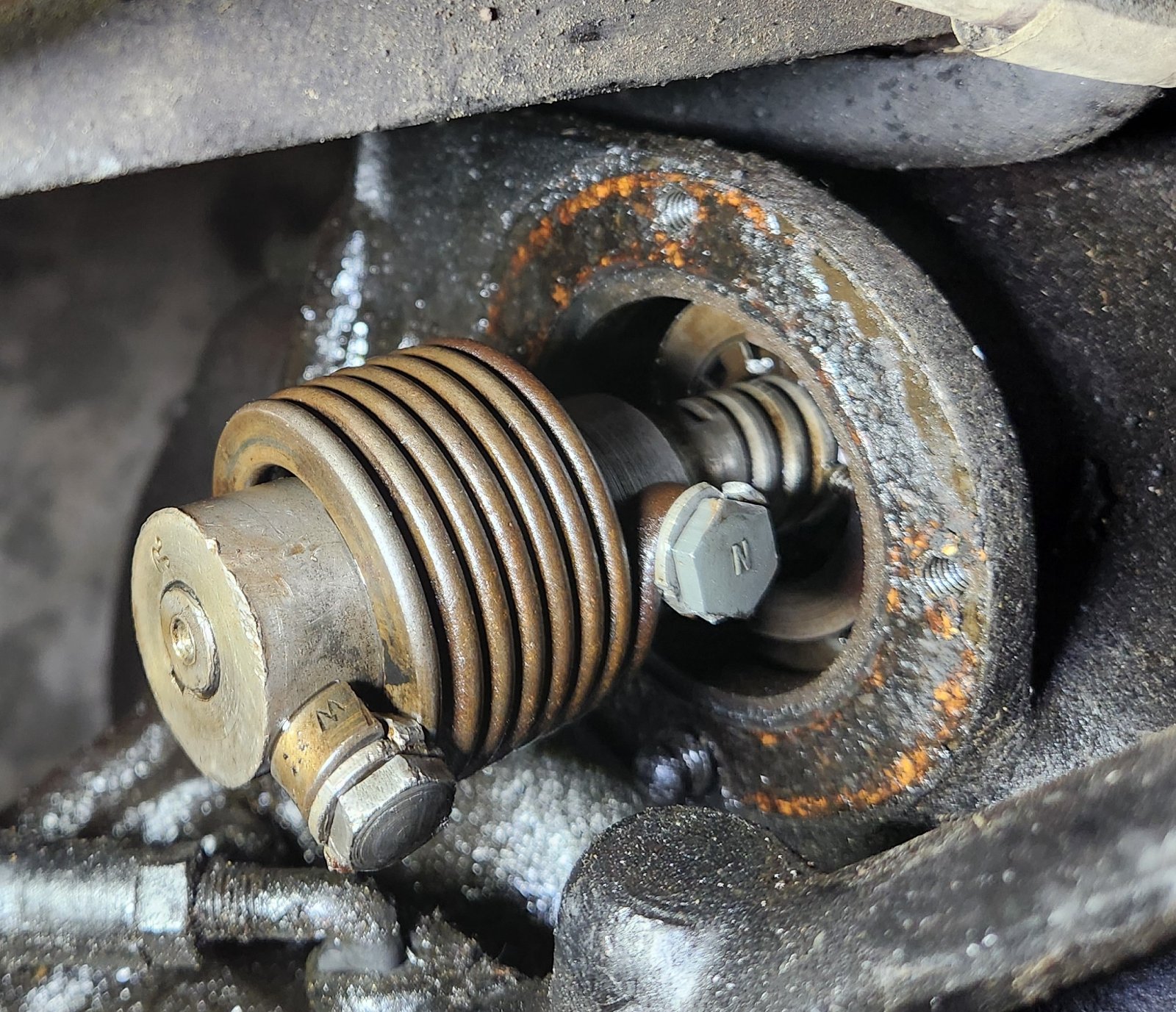

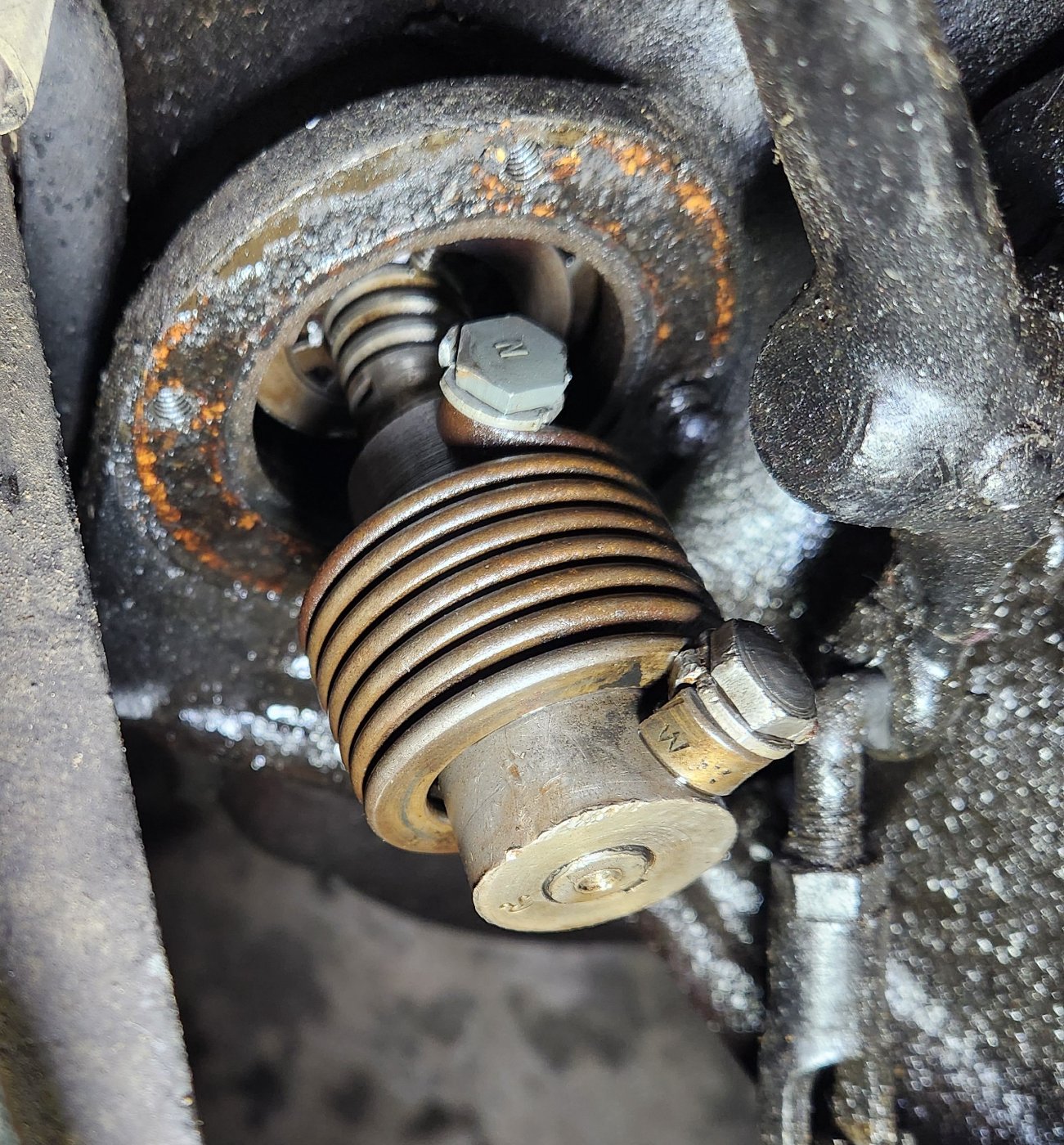

Motor kicked back a bit when starting, now won't turn over (sounds like it's trying). Battery, switch, power to starter seems ok. is the bendix jammed into the flywheel?
No Bird Soars in a Calm - Wilbur Wright
Posts: 5587
Re: Starter Jam
Post by RajoRacer » Wed Apr 23, 2025 8:28 pm
It appears so ! Throw the handbrake forward & rock the car. BTW - the Bendix bolts should be straight across from each other !

In my experience the bendix jams on a worn ring gear. All things equal, the things will work well until they don't. The kickback means the gear teeth can often engage on a different face on the worn ring gear. Once it is disengaged normal service may mean that the worn ring gear will carry on as usual, until it doesn't. The only lasting cure is a new ring gear.
Re the bendix spring, I have seen far worse springs than that one still giving good service. Sure, the bolts are aligned on a new spring, but that is not necessarily a reason to replace one as straight as this one. When they start to unwind and distort, then they need replacing.

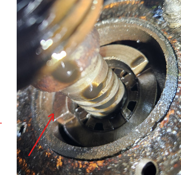

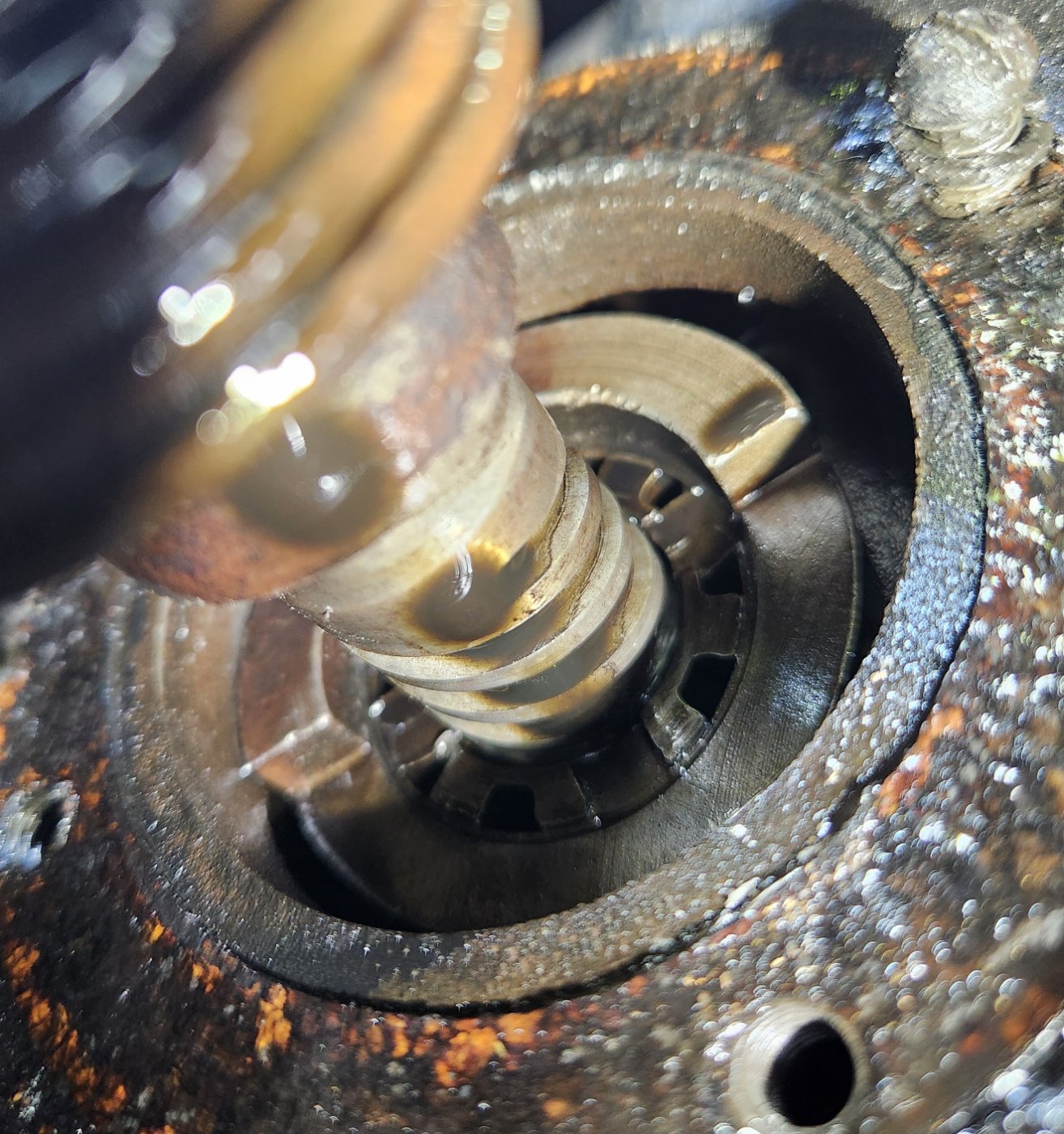

This area here concerns me. It appears that the counterweight has been driven up hard against the hogshead. It would be difficult to believe that the starter housing and/or starter shaft has not been bent in order to do that.
Either way, you first need to get it unstuck. You have had a lot of good advice in order to do that. Have you made any progress?

Something is way off for the bendix counterweight to hit the hole on one side & lots of clearance on the other side. (if the pix didnt lie)
"Looks straight" Aint gonna cut it. Spin the motor with the bendix off & watch the shaft. After confirming a straight shaft, slide the bendix on. It should effortlessly slide into the starter snout bushing. If not, the snout is bent.
Posts: 5587
Re: Starter Jam
Post by RajoRacer » Sun Apr 27, 2025 4:23 pm
The closeness of the counterweight to the side might have been a camera angle matter - if not, there would be a "tattle-tail" where it was rubbing.
