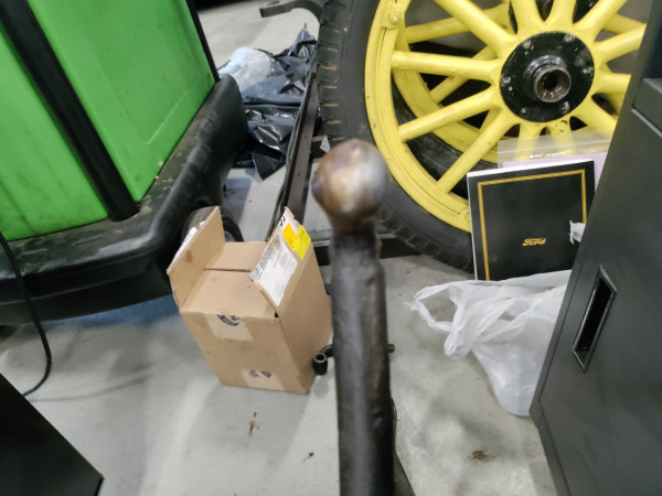

The ball is quite malformed, I wanted to remove it to see what k can do, I think there's a weld on replacement, also it should be the earlier style (I think) but I got the more common later style with the lower supports, actually one is loose in the bracket, if I tighten it up it becomes a tad shorter of the other one, what should I do about that, I didn't remove the rod, but from what I can see it looks fine thread wise on the rod.

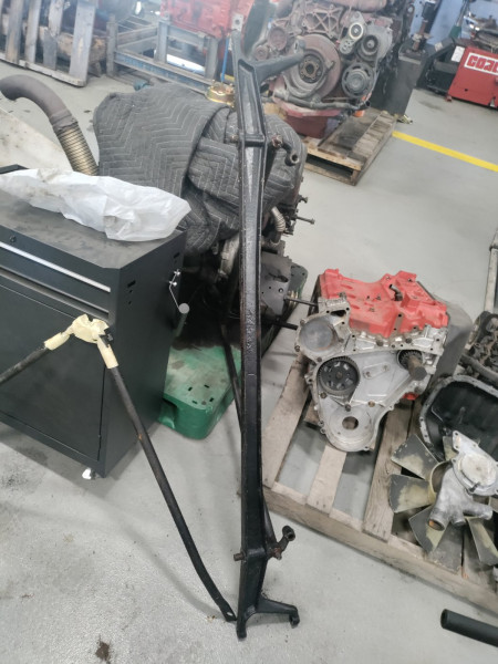

Lucas, the U bolts for the early type spring mounting are not available new, so you will have to source some good used ones. To use them on a 9 leaf spring would require them to be 1/2' longer than standard. I have never seen such U bolts. A photograph may help identifying just what you have. Perhaps they are aftermarket hand made items.

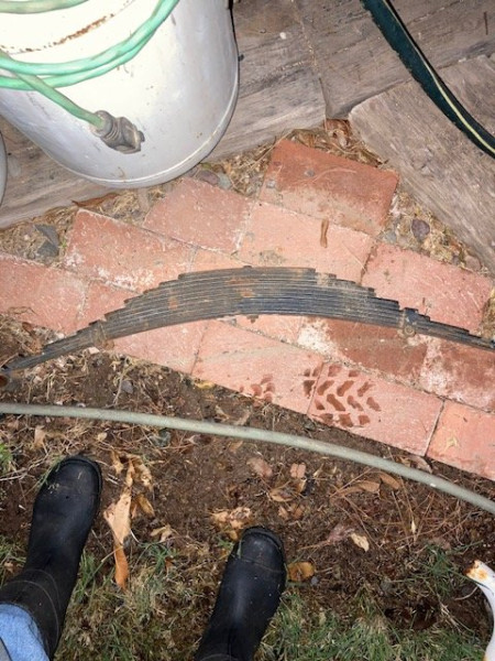

I'm one of the last people to ask about originality on Model T's but this is the front spring from a TT chassis I purchased some years ago.
Note that two leaf's are doubled up, it's 11 leaf's if you remove the doubled ones it's 9 leaf's.
Craig.

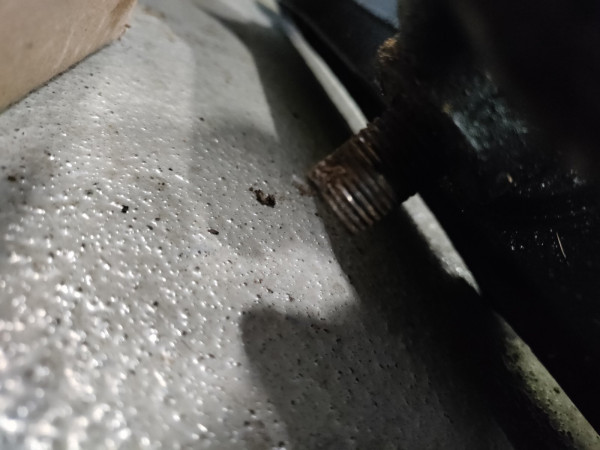

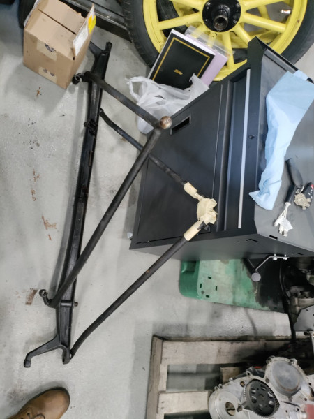

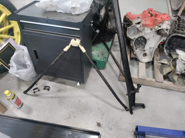

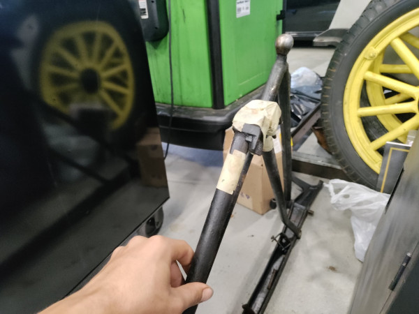

Post by LittleTimmy52 » Fri May 09, 2025 8:17 am
I don't know if the pictures are good, but as yok can see the ball is bad, I tried to get one of the threads its bad on the wishbone on a side the the lower half with the tape o font know how to adjust because I e is loose but if I tighten it it is shorter than the other. The u bolt may be stripped on one side but since I'm taking 2 leafs off, the damage will be raided just above the nut and I can re use it since the threads below are fine. Thanks everyone who replied this far I appreciate any help I can get.
