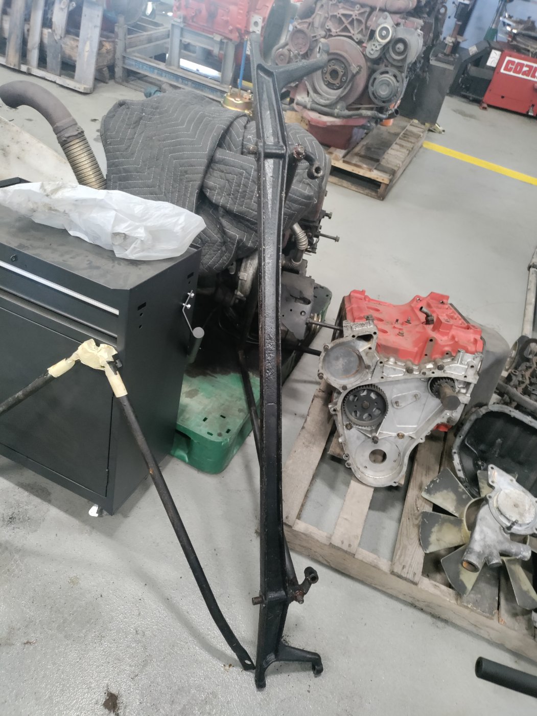

The ball is quite malformed, I wanted to remove it to see what k can do, I think there's a weld on replacement, also it should be the earlier style (I think) but I got the more common later style with the lower supports, actually one is loose in the bracket, if I tighten it up it becomes a tad shorter of the other one, what should I do about that, I didn't remove the rod, but from what I can see it looks fine thread wise on the rod.

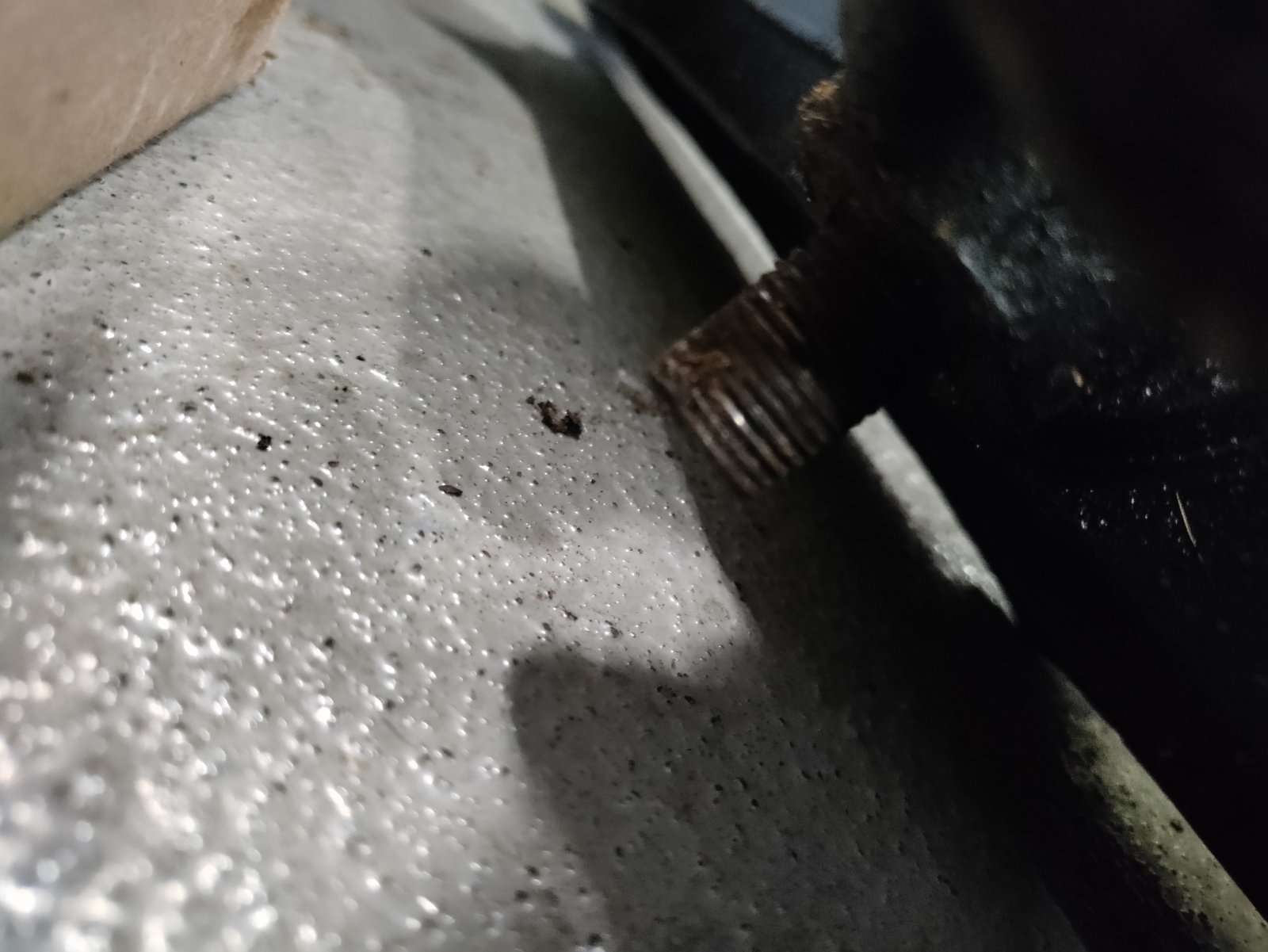

I don't know if the pictures are good, but as yok can see the ball is bad, I tried to get one of the threads its bad on the wishbone on a side the the lower half with the tape o font know how to adjust because I e is loose but if I tighten it it is shorter than the other. The u bolt may be stripped on one side but since I'm taking 2 leafs off, the damage will be raided just above the nut and I can re use it since the threads below are fine. Thanks everyone who replied this far I appreciate any help I can get.

I'm reusing the old ones because I removed 2 leafs and the damaged part would be above the nut do its still useable.love2T's wrote: ↑Fri May 09, 2025 10:21 amWhen you say "new bolts" I don't know what you mean other than totally modern U bolts which first won't fit right and second look horrible. Try Chaffins or Langs they often have good used early Engine Mounts a.k.a. Front Spring Clamps and maybe even an NOSLittleTimmy52 wrote: ↑Tue May 06, 2025 10:20 pmCan I use new bolts on the early one? I plan on sourcing am early one, but I need a plan b.
I thought I needed a new one until I realized the spot of the damage was less than the width of the leafs removed therefore it will stick up more and the nut would pass it.
