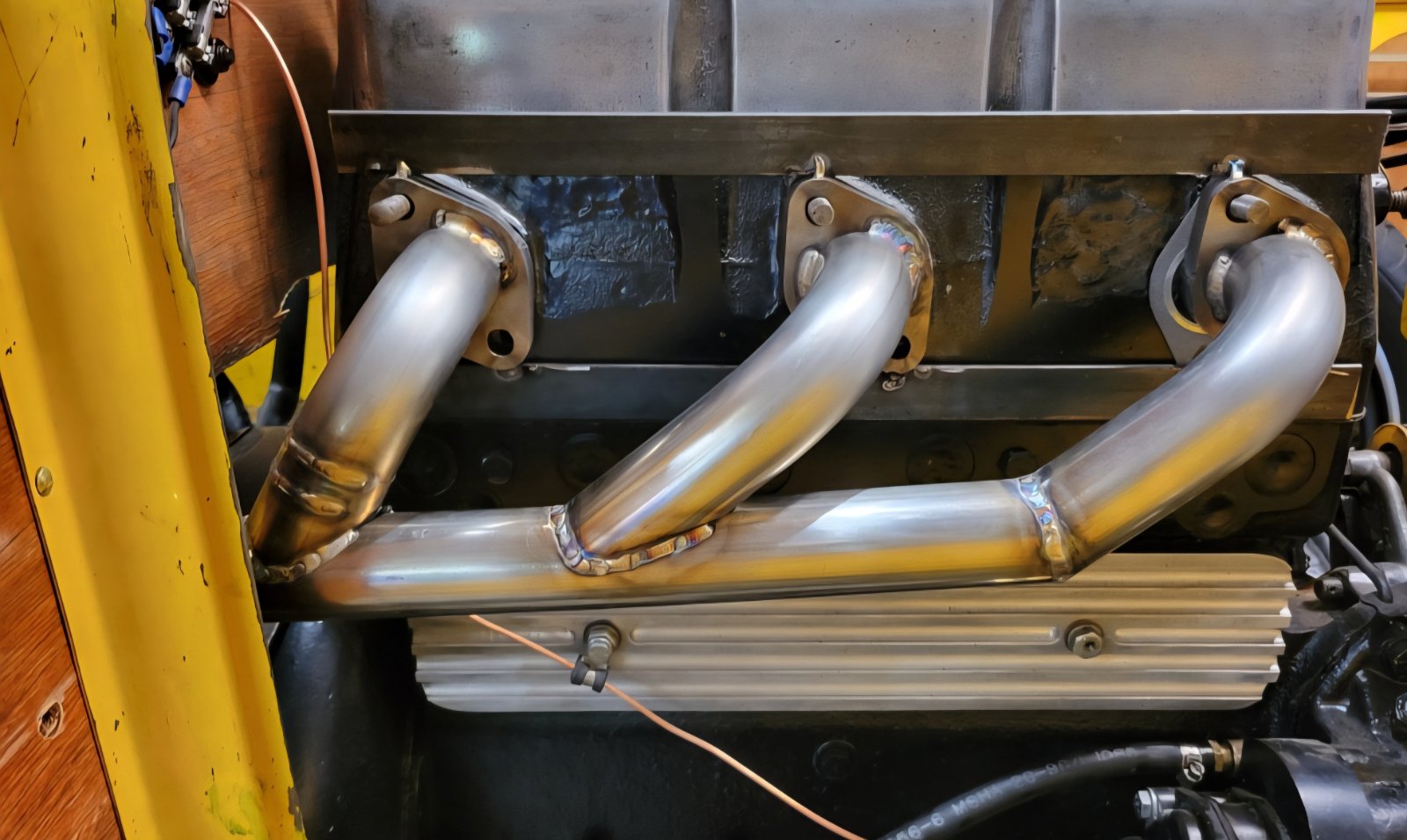

Topic author - Posts: 1520
- First Name: Keith
- Last Name: Townsend
- Location: Gresham, Orygun
Re: Header flanges?
A big box of material ordered from Stainless Headers arrived yesterday. Stay tuned...
- First Name: Keith
Re: Header flanges?
Here is what he's got put together so far...
Mild steel, 3/8" flanges, 1-1/2" steel pipe (1-5/8" OD).
Still learning about heat and warping...
Now I need to find some 1-5/8" ID flex pipe.
- First Name: Keith
Re: Header flanges?
Spencer is now working on the stainless steel unit...
Kevin Pharis
- Posts: 1654
- First Name: Kevin
- Last Name: Pharis
- Location: Sacramento CA
Re: Header flanges?
Lookin good! Noticeable improvement with both tube fitment and welding. I like your flange bracing, did it keep the flanges in place?
- First Name: Keith
Re: Header flanges?
We got the engine running but it was running really rough. Very sputtery and the intake manifold was really cold. I arranged a heat tube from the carburetor to an area near the exhaust header and it ran considerably better, so we made a heat collector and plumbed it into the carburetor. It runs much better.
- First Name: Keith
Re: Header flanges?
What carburetor is that, Steve?

Re: Header flanges?
Keith,
Looking good! I do not envy your son making the flanges out of stainless steel unless he has access to plazma or better still abrasive water jet.
- First Name: Keith
Re: Header flanges?
Bill,
He cut them with a plasma cutter.
