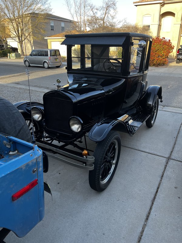

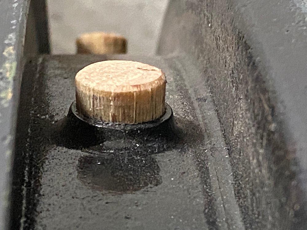

I have seen a couple wheels re-spoked but didn't get involved enough to learn the process.
My passenger rear had three loose spokes and when I jacked up the car it turned into more than a couple.
I ended up depleting the supply of U shims I had access to (8) and the wheel tightened up just fine.
It now has a bit of side to side wobble.
driver side rear seemed fine... but it wasn't...
once the driver side was jacked up it has loose spokes and the hub end is also loose.
I plan to take both apart soon.
My spokes appear to be in excellent shape otherwise.
There seemed to be some sort of either wooden disc or some type of fibre washers/shims installed when the wheel was built, and they are falling apart causing the loose wheels
My question is...
does tightening up the hub end affect the wheel "wobbling".
I do believe with the correct metal shims I can tighten up the wheel sufficiently, but I will also be prepared to replace the spokes.
My question is...

From what you describe it is time for new spokes.

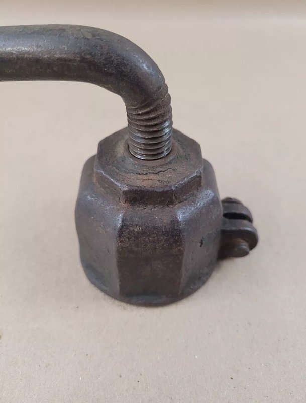

It does look like I need a wheel puller too.... is this the one? https://www.modeltford.com/item/2800WP.aspx
Sent from the panic room, via two tin cans attached with a string, and a jail broken Marconi, while wearing a Tin Foil hat.
- Posts: 7401
Re: And now the wheels.... rebuild and shim questions
You don't specify what kind of wheels you have, but I suspect this will cover them:
https://dauntlessgeezer.com/DG108.html
Yes, that's the rear wheel puller for cars. Be sure you clamp it tight before you apply pressure.

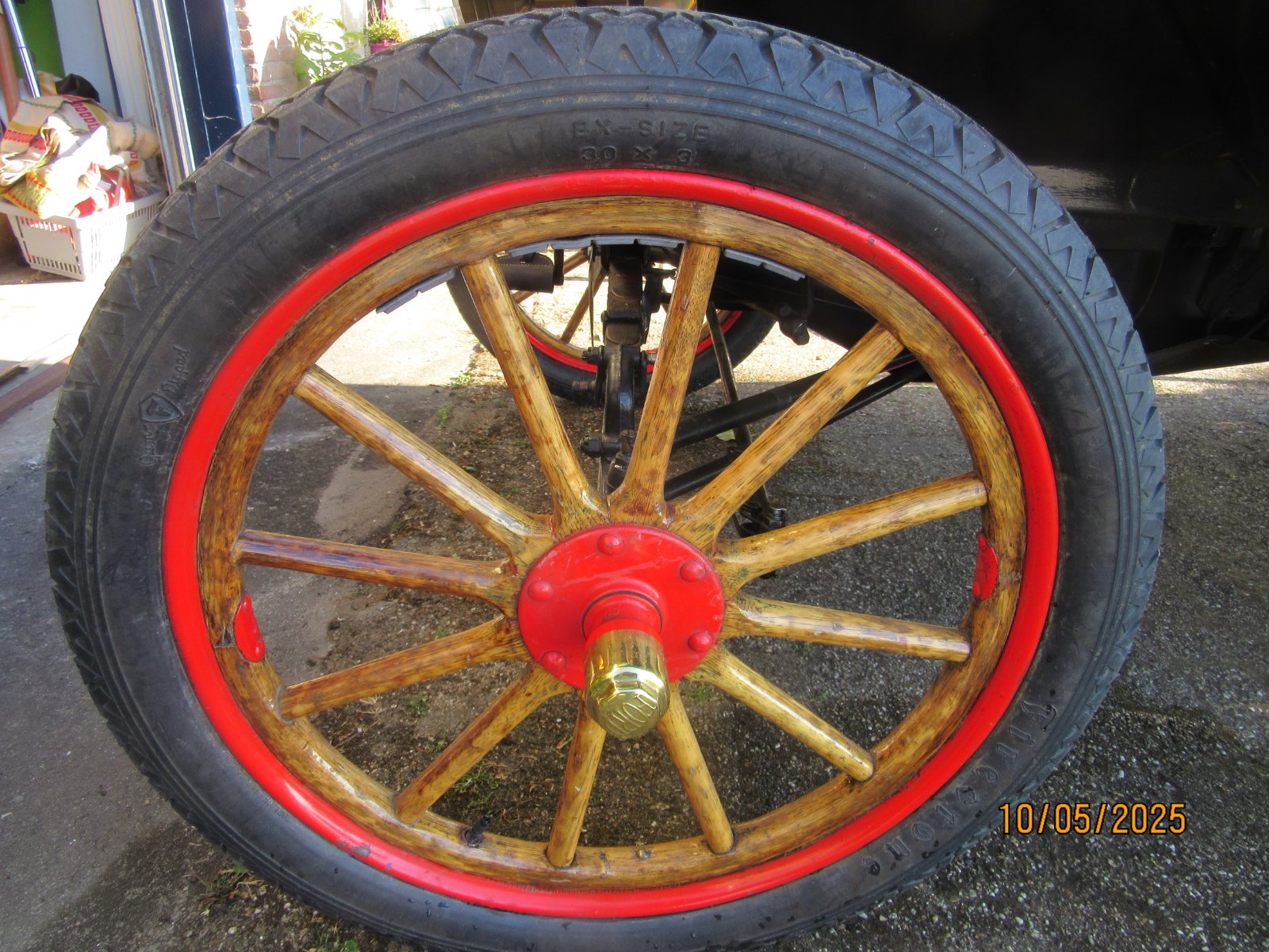

They are the 21" I do believe they are called split rim, demountable.....Steve Jelf wrote: ↑Tue May 06, 2025 10:24 amYou don't specify what kind of wheels you have, but I suspect this will cover them:
I have a beautiful red pinstripe around the cab of my car, I'm considering painting the rim red, with natural spokes, or even a red pin stripe on the black rim, with either black or natural spokes... I think all red spokes and rim would be too much....
Of course I would need to do the same to the front wheels.... I'm scared to jack up the front end to check those.... they seem fine with the cars weight on them.... but so did the driver rear....

Wooden wheels are very strong, but only when they are tight.
I would HIGHLY recommend checking the front wheels too! Wood wheels are strong front to back, but side to side, if loose, they can collapse. Being the steering wheels (quite literally) they take a lot of side load going around corners. Now is the time, if time and finances permit. The car is already apart, and your setting up to do the rears, so why not the fronts.
I refinished the spokes on my T over the winter and documented my experiences and posted them a month or so ago on the forum. It was my first time too, I only replaced 2 spokes, but I'm in the process of doing another set now, fully respoking them.
For me, torquing the hub bolts down tight really helped true up the wheels, before I was told my rear wheels wobbled quite a bit. They are a lot straighter now.
Good luck and have fun, after all, that's what the hobby is for.
viewtopic.php?p=358968

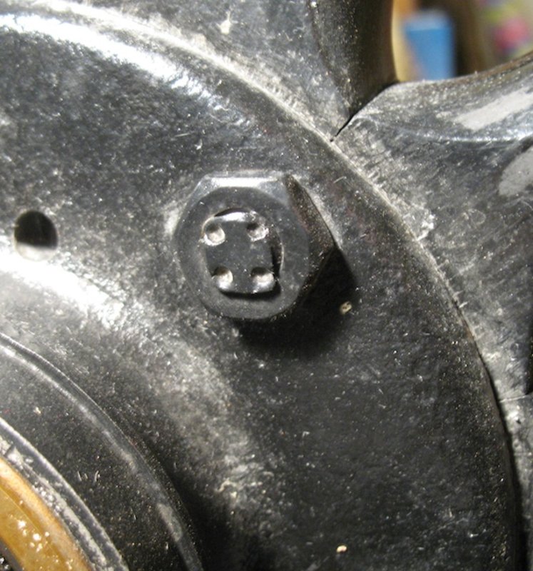

Remove BOTH rear wheels and tighten the hub bolts and peen them. Check and make sure that none of them are hitting the Rocky Mountain brakes.

I found this cobbled monstrosity of a wheel puller and I kind of like the aesthetic value, I may buy this one...

Right. Those are "band-aid" fixes that you avoid by using new spokes.
Have you actually tried to remove the wheels yet? Too often, they're already loose. Once you have the wheels/hubs off the axles, post some pictures of the axles and their keyways. You need all of this to be in good condition to be trouble-free & safe.

Shims are used to get more life out of loose/bad spoked wheels. A correctly tight respoked wheel has no shims.
The puller you show is a light duty period tool. The pinch is very important to not pulling/stripping hub threads. Best to find a Ford Z puller with very good threads. They come up for sale here occasionally. I see Langs offers a repop of that tool. If faithfully reproduced, its the one.

Good to know, I was tempted to try and find some shims for the new install.Jerry VanOoteghem wrote: ↑Wed May 07, 2025 10:42 amRight. Those are "band-aid" fixes that you avoid by using new spokes.

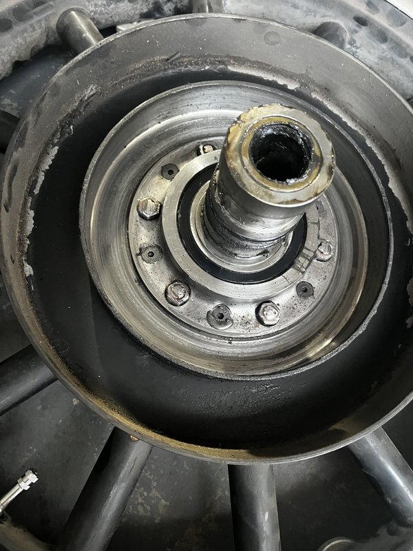

I think I mentioned it previously but there are some type of wood or fibre washers on the rear spokes now. they seem to be disintegrating and I'm certain that is the source of the problem....
The fronts don't seem to have any washers/shims/spacers at all, and they are in excellent health...
I tried to remove the driver side but not the passenger side. I'm happy with the tightness of the passenger side, but it has a little wobble as seen in the above video, but after installing 8 shims I'll be happier with a re-spoke.
If tightening the hub on the driver side would get me mobile I'd drive it to work until my spokes arrive.......
the axles seem solid, floating hubs were installed not too many miles ago.

uhggg.... Langs, does not have the puller in stock.... but the spokes and nuts and bolts are.... order placed...
I put an offer in on the ebay monstrosity puller..... I'll try the loosening the nut trick tonight....

I'm going to do a single red pinstripe on the black portion of the wheel to match the body pinstripe, and black spokes.Steve Jelf wrote: ↑Wed May 07, 2025 12:07 pmRather than waste time and effort on shims and other Band-Aids, re-spoke. Ford wheels had galvanized (zinc-plated) rims and were painted body color. You can get creative if you want, but if you show or sell the car that will be a problem.
The de-mountable rim is grey/silver/natural.
All my parts are on the way for a re-spoke.
I don’t have a full on side picture but the wheels and body stripe are here
I think snyders may have had the puller in stock, I didn't call, but it would have been $15 shipping + tax.... so just over $100
I bought the ebay fubared puller for $63.29 shipped.... I'll make it work....

I drove her around the block once and the wheel didn’t budge so I took in a figure 8 around 3 blocks and it came loose.
I think I’ll prefer the puller for the future…
The hub nuts are loose as hell and I imagine the other side is too…
I’m glad I opted for new hardware with the new spokes.
- Posts: 5500
That appears to be some type of "safety" hub - should have been a set screw in the grease cup location.

Yes, those are the floating hubs that make this axle illegal for the Montana 500….

The inside of these spokes look like they rubbed on the rm brake hardware too, but not as bad as the other side.
I tightened up the hub bolts and this wheel is completely tight now.
I will take the other side off tomorrow and tighten them up too.

Tighten those hub bolts on both sides and peen them then check the tightness of the spokes again. I can't see the previous owner not respoking before having floating hubs installed. I watched your videos and your spokes seem fine other than the VERY loose hub bolts. Be sure to address that scraping noise you talked about. this is just my opinion, bobt

The hub bolts appear to have had some sort of peening but it wasn’t aggressive enough.
I don’t have a proper punch so I’m stopping by harbor freight after work tomorrow.

Tonight I torqued the hub bolts on the passenger side and double dot peened each one.

I had found a thread here that had a neat picture of just two spots punch peened and now I can’t find the thread or the picture…
So I stole this picture from another thread on the forum…
I just did the two on the passenger side..
Probably just do two on the driver side too.
Mine isn’t as pretty as this…

Peening the hub bolts is meant to do two things, one more important than the other. First, it is to stop the nuts from falling off if they become loose.
More importantly, peening should be sufficiently aggressive enough to actually stop the nuts from loosening in the first place. To my knowledge, the hub bolts supplied by the vendors are all the same length. If they are long enough to peen over when used on the rear wheels with the brake drum in place, they will be too long for the front wheels. They should have their length trimmed somewhat before peening. Any subsequent adjustment to the tension demands re-peening the bolts.

I use blue Loktite on all hub threads prior to peening. There is a thread lock product available to use and it's supposed to "wick" into the threads.
- Posts: 7401
I think I recognize that photo. I don't always do them that well.

Hallo .
One of our Wheels of our 1912 have some spooks who are a little loose .
What is the best way to repair that ???
My spooks appear to be in excellent shape
Thanks for your answer .

- Posts: 2997
- Last Name: House
A red rim causes spokes to loosen much sooner than a black non demountable rim

Willy. The only problem I see with your FUBAR Ebay rear wheel puller is that the bolt has been replaced with that bent over thing. The original bolt allows you to, once everything is good and tight, you can whack the original bolt head with a BFH and that's when they usually "pop" off. bobt

Well it’s finally out for delivery, so we shall see how it works, I’m certain I can find some place to whack it with a hammer. If need be I’ll buy a bolt that fits it.

The new wheel puller worked fabulously, the bent bolt had plenty of travel and leverage, the wheel just popped right off.
