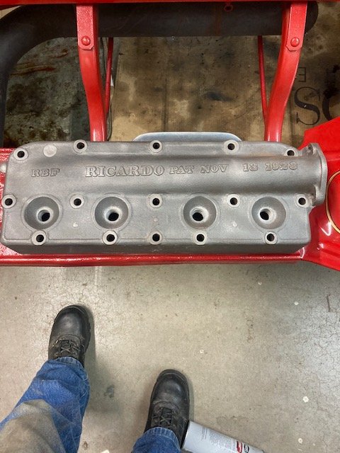

I'm looking to install a RICARDO PAT NOV 13 1923 HEAD & would like to send it out to have it surfaced .010 to get a better gasket seal but I'm
concerned about piston clearance. The current area over the piston is .423 so I would end up with .413 with a gasket crush of .050 to .060.
I have found info on line of the stock compression pistons being from .378 to .412 proud of the block. The pistons I have use the 5/64" rings
& I have been told they are Jann's. As far as I know the block has not been decked. Doe's anyone have a engine apart that could measure how
proud their pistons are? Thanks Guy's.

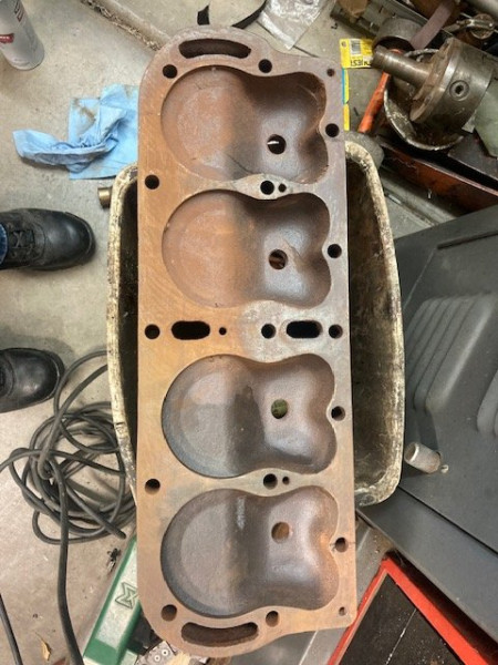

In picture of bottom of head. The top cly is that a crack?
I always pressure test any head I send to be decked.Dan

Hi Dan, no it is not a crack it washed off with brake clean. I did Magnaflux the head but not able to pressure test. The pits around the water ports are more than .005
