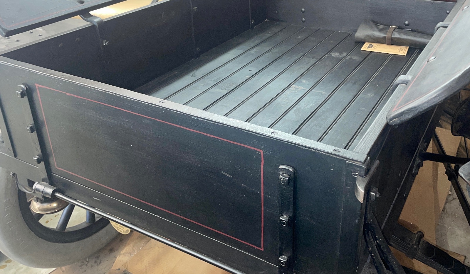

- Posts: 4040
Re: Pin Striping Paint
Terry
Seems like the One Shot color to match would be "Chamois" for a nice creme.
Here is the Color Chart:
https://tcpglobal.com/collections/1-sho ... ing-paints
I used their Maroon, but wasn't the shade needed to match the maroon of the seat cushion, which was older vinyl. So added a bit of Blue to the Maroon and got the match for my striping of the wood bed tailgate, flare boards, and front riser on the '12 Open Express project.

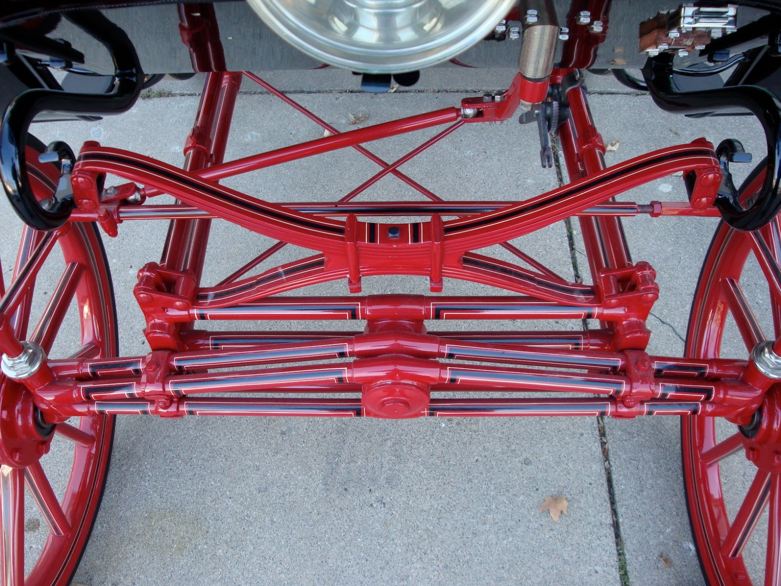

The pinstriper that my father utilizes uses 1 Shot. He is also a talented sign painter.
As far as various shades of 1 Shot goes, he can pretty much create any shade/color you want by mixing/combining the various off-the-shelf colors. I have witnessed him doing this. Also, I believe 1 Shot has tintable base paint so the options are theoretically unlimited.
https://www.ppg.com/en-US/refinish/products/1-shot
- Example of ivory/cream pinstriping - I believe it is an of the shelf 1 Shot color and not altered by the pinstriper - click to enlarge
- Example of red pinstriping
