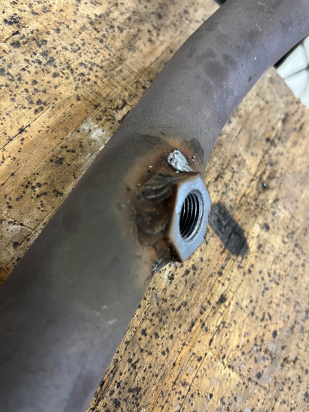

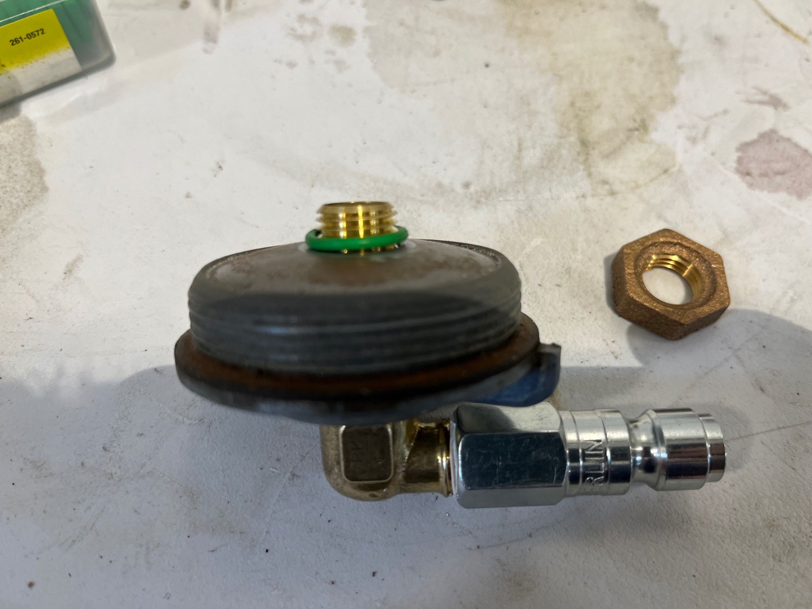

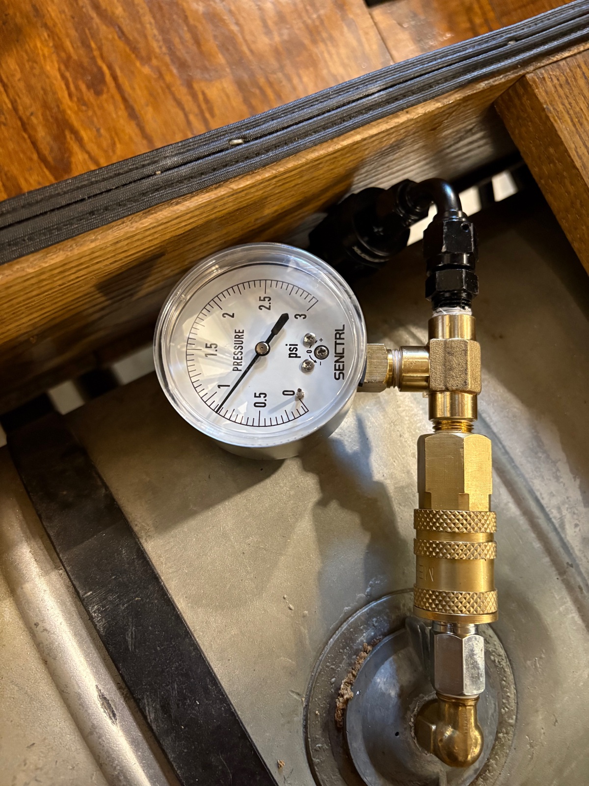

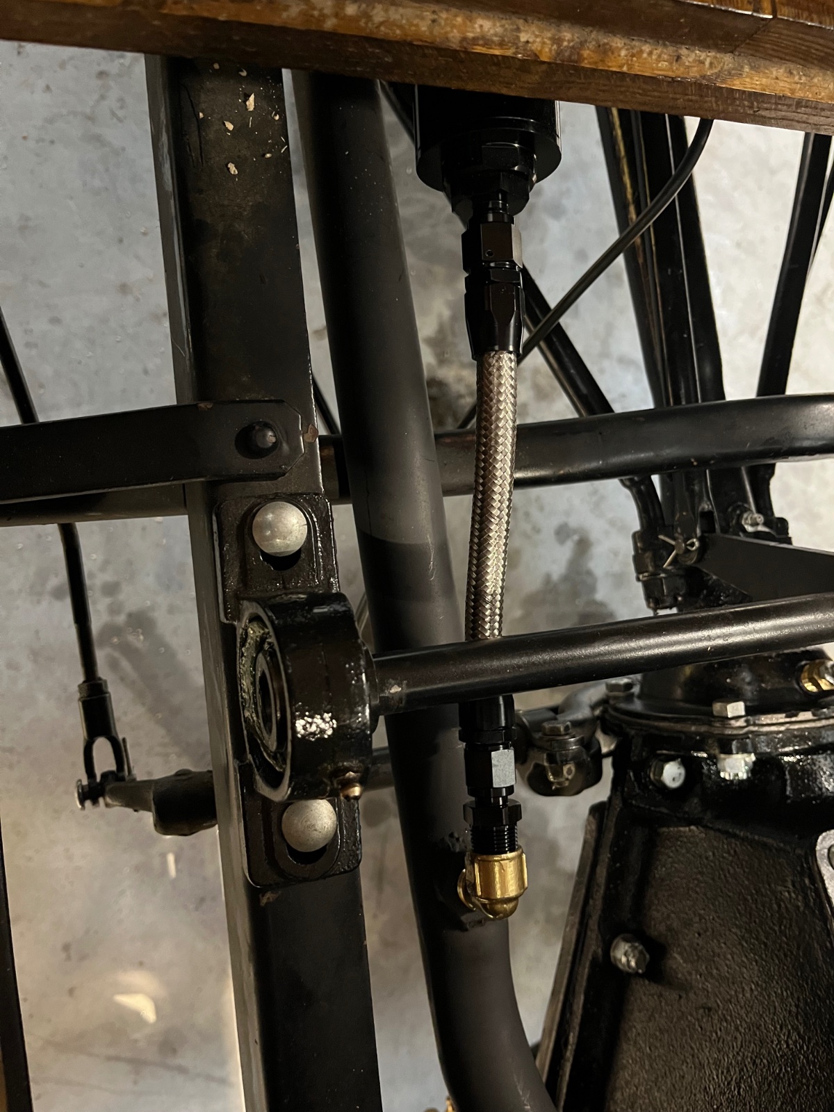

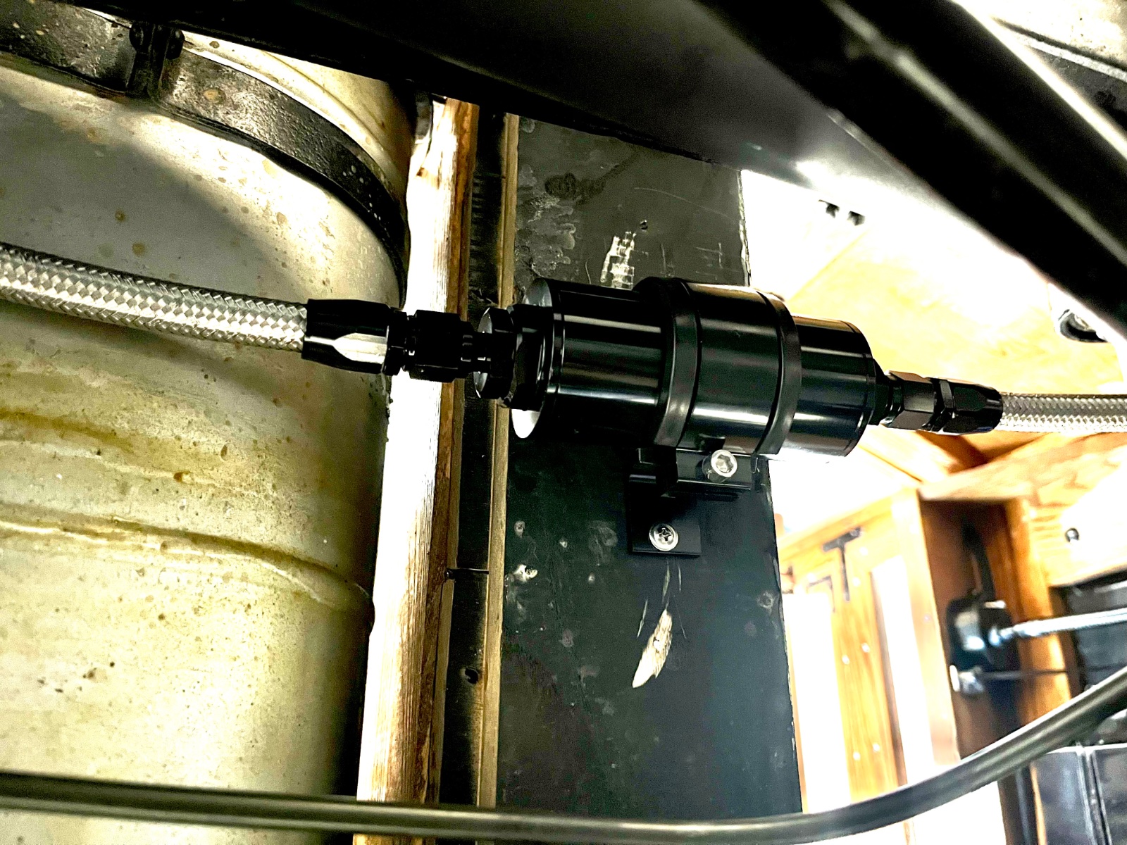

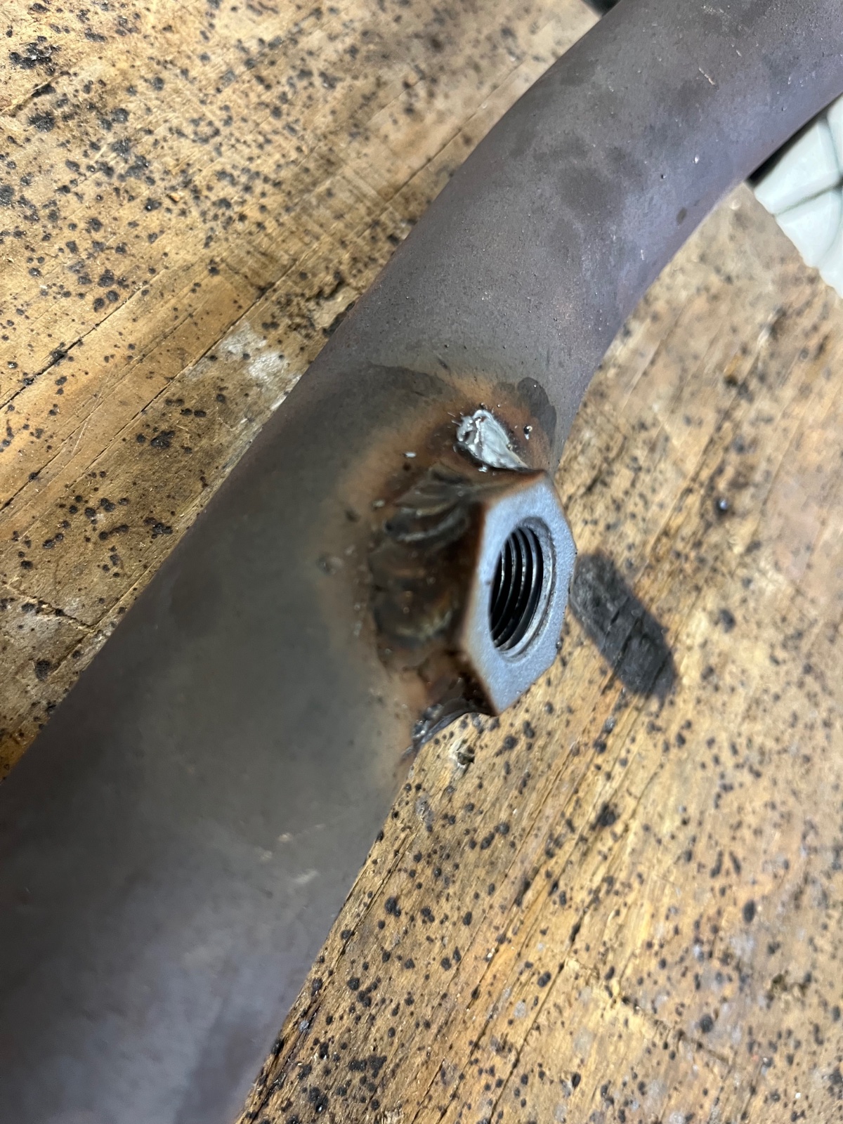

I finally took George Akins advice and pressured my fuel tank using the exhaust on my 1924 Depot Hack. For years I have had trouble climbing hills unless my tank was completely topped off.
To the neigh sayers, there is no risk of explosion. Any oxygen in the tank is displaced by carbon monoxide. There is an aticle in the MTFCA Carburetor book which explains how to do this work, taken from Model Airplanes which use the exhaust gas to pressurize the fuel.
I bought these things from Amazon
SENCTRL 0-3 Psi Low Pressure... https://www.amazon.com/dp/B0C624GLKD?re ... b_ap_share
HEROFFIX 1 Pcs AN6 Fuel Line Hose... https://www.amazon.com/dp/B0DN1XWBRJ?re ... b_ap_share
Shineyoo 6AN Straight End Fitting... https://www.amazon.com/dp/B095H8WFMJ?re ... b_ap_share
By adding a one way valve, I now have steady pressure in the tank. I also added the stainless fuel filter to act as a spark arrestor.
Look me up at Homecoming in June and I can show you the setup. Here are some pictures.

Negative pressure doesn’t exist. The one way valve is designed for low vacuum or pressure. Anytime the pressure in the tank goes negative, the valve opens thereby eliminating the condition you are describing of the tank collapsing.
The valve was added because the pressure gauge was bouncing quite a bit with each pulse of the exhaust. Now the pressure stays steady. The tank even holds pressure after the engine is turned off.
