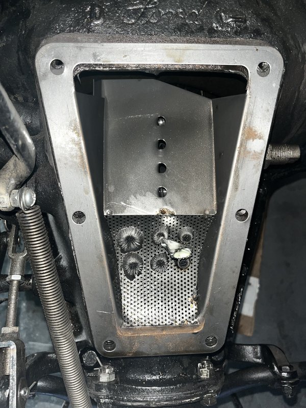

I adjusted the bands when I first got her and there were no fibres in the screen, but that doesn’t mean there aren’t any on the post.

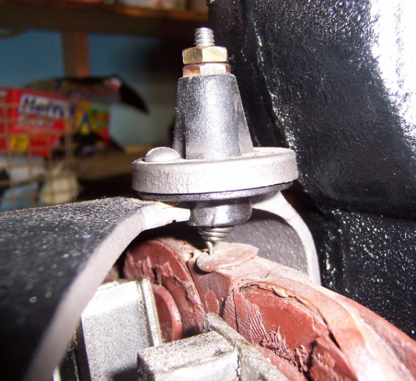

Forget the electrical tests for now. Confirm that there's no band lint issue. The mag post sits at the very top of the hogshead and has the magneto power wire attached to it. The post will be held on with 3 slotted head screws, (unless your car is a 26/27).WillyR wrote: ↑Mon May 19, 2025 12:06 pmI adjusted the bands when I first got her and there were no fibres in the screen, but that doesn’t mean there aren’t any on the post.
I’m so unfamiliar with the mag system I need to figure out where the post is.
I do not have an analog meter, any recommendations on brand and model?
I’m enjoying buying specialty tools.

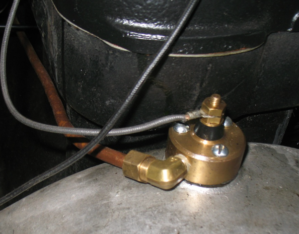

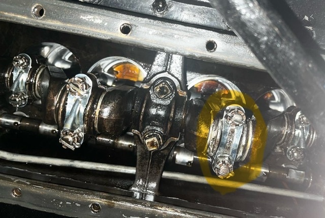

Here is a pic showing the mag post and how it contacts the magneto coil ring. (The hogshead has been cut away for clarity)
It's also possible that you have a mag post with an accessory oil pick-up. Like this...
They can be troublesome at times as well...

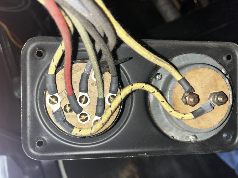

There were a couple loose connections on the electrical block on the firewall but no loose connections at the switch.
No band material on the mag post.
End of the video shows what she’s doing after checking that so far.
So it looks like I’m pin type switch, is there anything I can fix by taking it apart? Or will I have parts flying? If I take it apart?

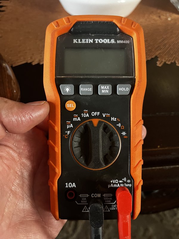

This is what I have at my disposal right now
A Klein mm400
Here are the specs for it..
https://www.kleintools.com/catalog/mult ... nging-600v
What setting should I have the meter set to? How do I set it to ac?
A Klein mm400
Sent from the panic room, via two tin cans attached with a string, and a jail broken Marconi, while wearing a Tin Foil hat.
- Posts: 5167
Re: Magneto woes…
Thats a DIGITAL meter. You need an ANALOG meter.

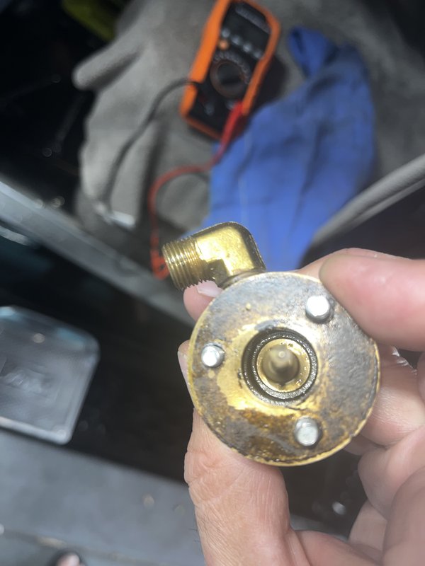

Elbow inside the body, pin has a slight bend I the direction of angina rotation but moves freely

Ok here is where something is weird.
Testing the ohm.
Unhooked the wire, tested and got .1 ohm.
Removed the unit to check to see if the elbow was protruding into the body.
Curious as to what the pin was riding on I stick my finger into the hole in the hogshead.
I see something shiny and pin like (needle bearing)? And I touch it and it falls into the pan.
I reassemble and check the ohms and it is reading .5-.6 ohms.
I start the car and use the test light and it shines right up.
Switch the key to mag and it functions like it should.
Question, what the hell was the metal thing?
Where did it come from?
Am I dropping the pan to find it? What’s my next step?
Testing the ohm.

Sounds like something was shorting out the mag. You got lucky!
BUT what was it?
It may have gone to bottom of pan. Or is stuck to the magnets.

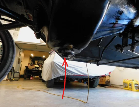

I would drain oil and see if can feel it at drain hole.
If you got a bore scope look in transmission and see if can find it. Dan
BUT what was it?

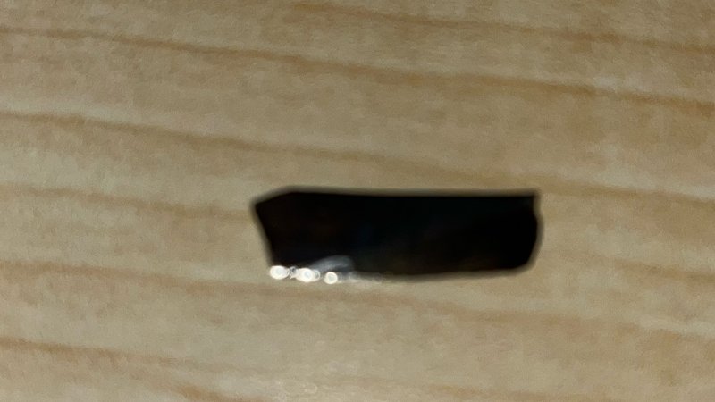

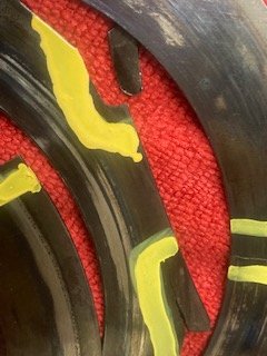

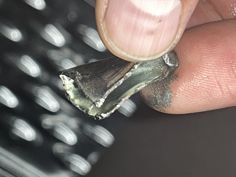

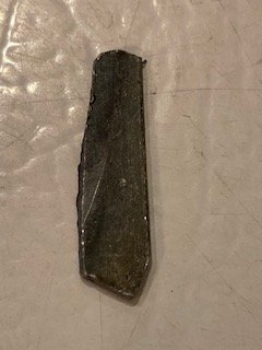

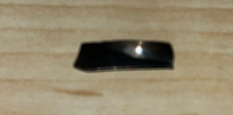

Oil changed, no metallic look to the oil.
This is what came out, it doesn’t feel as heavy as it sounded when it fell.
There is a shiny spot than made me think it was cylindrical for the 8/10ths of a second I visualized it…
Not sure why the trend, but there is a banana for scale…
Started it again and switched to mag and it functioned like it always has…

That looks like a piece of clutch lug shoe from the brake drum.

Hi Wilhelm,
How thick is that piece? could be a piece of clutch plate or clutch lug shoe but I think they are different thicknesses. I have had clutch plates
crack & fracture into pieces much like that. Do you have a trans screen with a magnet in it? That was were I found my clutch pieces. Plates
& shoes are hard enough to reek havoc on triple & drive gears.
Craig.
Craig.

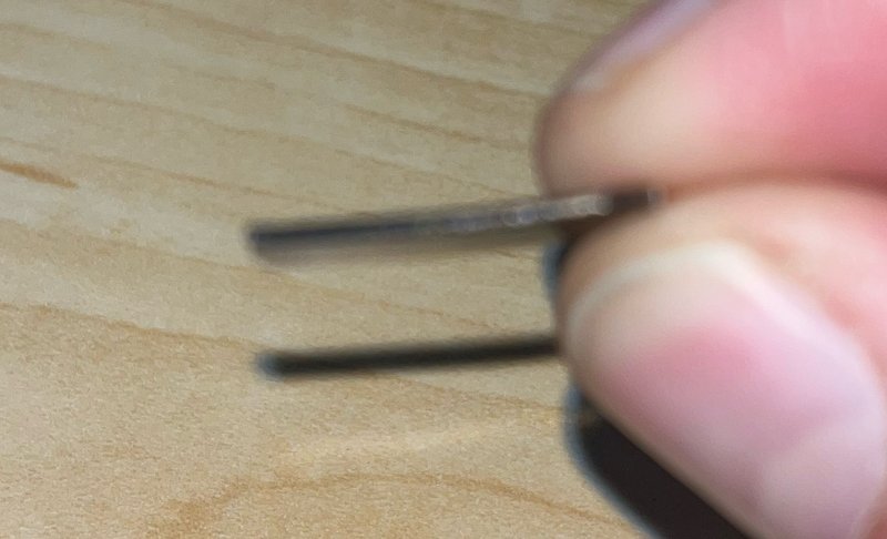

It’s fairly thin, I’ll check it with my micro-meter tomorrow. I’ll need to fix it since I used it to remove my drain plug. It’s a pretty shittu adjustable wrench.Craig Leach wrote: ↑Tue May 20, 2025 12:56 amHi Wilhelm,
Craig.

Don't know if it will help, but could you post a few close-up images of the "thing"?

Is it steel, aluminum or (hopefully not) Babbitt?

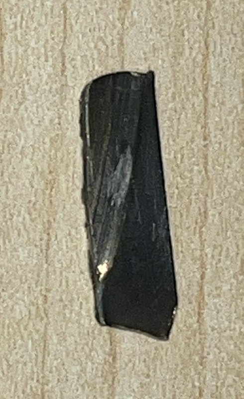

Having trouble getting focused close ups
It’s magnetic steel
I do have a trans screen and magnets. I’ll pull that tonight and see if I caught anything

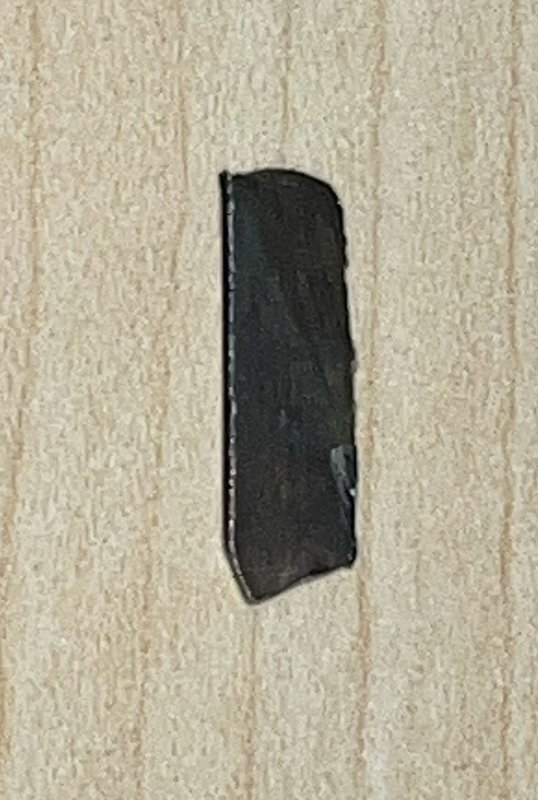

- Posts: 4400
Re: Magneto woes…
Maybe try backing away a bit with the camera/phone and then zooming in??
Is it hard steel? Can you file it, or will a file not "bite"? If you try to bend it, will it take the bend, or just spring back?
There are not a lot of thin metal parts inside your motor. I almost want to say that it's a piece of broken off transmission band, but I'm not sure how such a fragment would break away like that. Another thought is a piece of a high-speed clutch disc.

Witchcraft and alchemyJerry VanOoteghem wrote: ↑Tue May 20, 2025 10:23 amMaybe try backing away a bit with the camera/phone and then zooming in??
It is quite hard, I doubt it would bend without breaking and a file would have little effect.

Piece of clutch disk.

I am recalling events of that day, and this is how it happened.
I was pulling into a car show, on mag, looking for a parking spot. low band....
The car dies, and I'm not sure why, figured user error, so I switch back to battery and re-started.
I must not have switched back to mag and continued to park.
a few hours later when I go to start it it dies when switching to mag.
...by the way I had soldered wires directly to both terminals of an 1157 bulb since I didn't have a spare socket.
after I knocked the metal piece loose and got the test light to function, I did burn out both filaments of the test bulb....

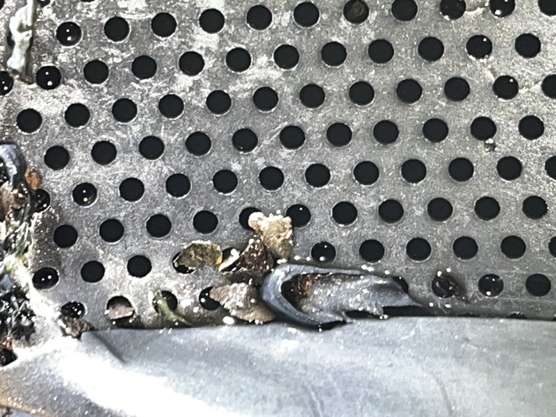

Craig Leach
- Posts: 2020
- First Name: craig
- Last Name: leach
- Location: Laveen Az
Re: Magneto woes…
Hi Vilhelm,

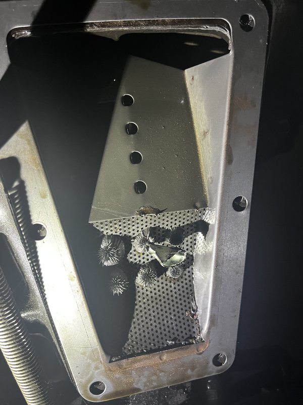

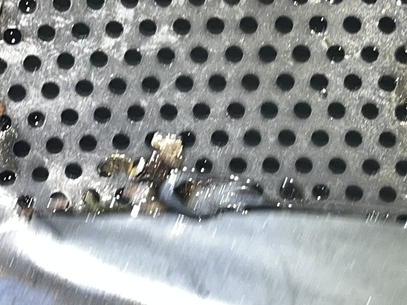

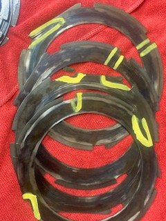

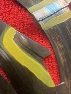

Had the same part show up in my screen back in 2023 & decided to pull the engine this is what I found
I attribute this to my own fault, when I filed the clutch lugs with a square file I made the lugs tapered to the center, there for putting all of the
load on the very tip of the notch in the plates instead if evenly spread over the flat. My solution is to grind opposite sides of the square file so
the none cutting edge rests on the curve of the hub holding the cutting edge square. Thusly finding out that trying to saving money by not buying
a new hub the more labor intensive route. And the clutch worked just fine so don't let that fool ya.
Craig.
Craig.
- Posts: 4400
Re: Magneto woes…
Yup. I'd say clutch disc, 100%.
Sorry dude...

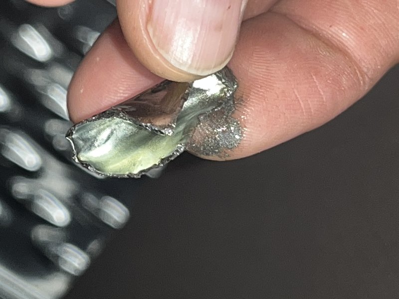

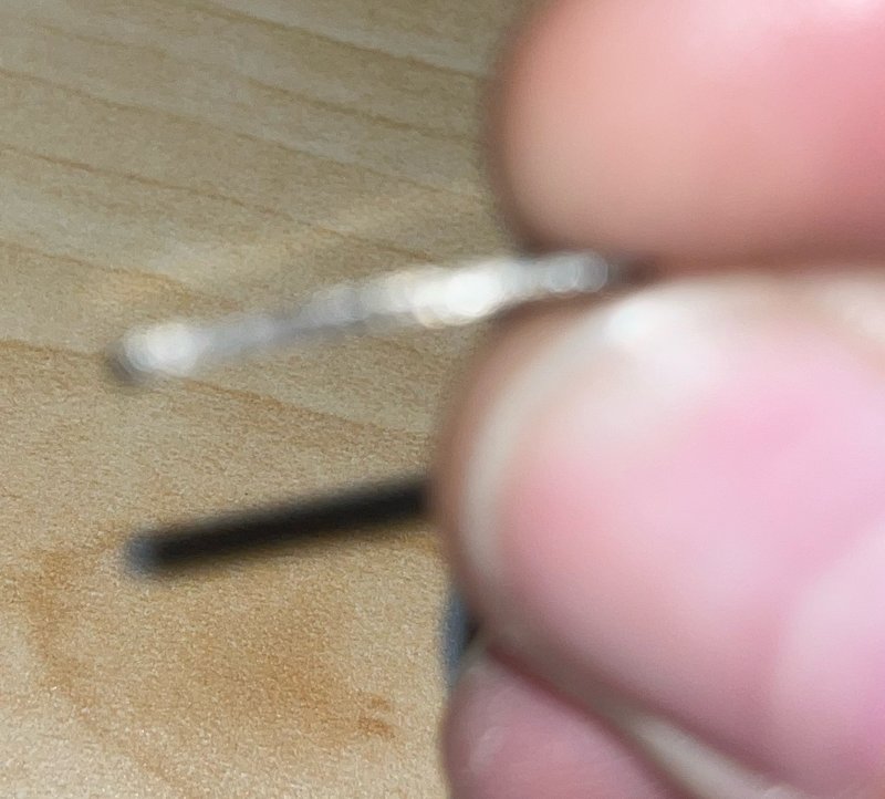

I just cleaned the screen less than 200 miles ago.
There was a little bit of metal on the magnets nothing like this there is a metallic sludge all over the magnets.
Had it for just over 6 weeks
- Posts: 4400
Re: Magneto woes…
That's an oil dipper from the bottom of one of your connecting rods. Good that you found it! Remove the oil pan inspection cover and you'll immediately see where it came from. As for the metallic fuzz, that's normal.
Last edited by Jerry VanOoteghem on Wed May 21, 2025 10:24 am, edited 1 time in total.
- Posts: 5427

Pull the screen and look at drums.
Also pull the bottom cover and see what took out the dipper.
When you go back, don’t use reproduction clutch disc. Never had any luck with them. Go with 400 disc and original large disc.
If you have to replace brake drum get one with replacement lugs.
- Posts: 5167
Re: Magneto woes…
Your magnet is on the wrong side of the screen!!!
The magnet fits in the screen trough on top.
The way you have it makes it likely to fall into the transmission.
- Posts: 4400
Re: Magneto woes…
I think they're in the right place. They seem to be smaller magnets than we're used to seeing and are obscured by the fuzz.speedytinc wrote: ↑Wed May 21, 2025 8:18 amYour magnet is on the wrong side of the screen!!!

Dan Hatch wrote: ↑Wed May 21, 2025 8:04 amPull the screen and look at drums.
yes, apologies, and edited.Jerry VanOoteghem wrote: ↑Wed May 21, 2025 6:28 amFirst, watch your language...
That's an oil dipper from the bottom of one of your connectiong rods. Good that you found it! Remove the oil pan inspection cover and you'll immediately see where it came from. As for the metallic fuzz, that's normal.
the drums and bands from the trans cover seem fine, should I attempt to rotate and further inspect?
this is the second time I have inspected the magnets, and first time was more of a black iron filing look this time is more silvery fuzz, and a bit more, so that had me worried.
I was almost expecting more of the same hardened steel pieces like the first one.
I'll get the oil pan inspection cover off tonight and see what is going on there..
the crud in the first two pics looks to be some band material and a wisp of silicone.
What parts should I be buying?
the dipper set is $22
looks like the clutch disk set is about $200 with a couple different options.

Jerry VanOoteghem wrote: ↑Wed May 21, 2025 10:25 amI think they're in the right place. They seem to be smaller magnets than we're used to seeing and are obscured by the fuzz.speedytinc wrote: ↑Wed May 21, 2025 8:18 amYour magnet is on the wrong side of the screen!!!
they are small neodymium magnets, I added some bar magnets across the top of those for more surface area without blocking the mesh.speedytinc wrote: ↑Wed May 21, 2025 8:18 amYour magnet is on the wrong side of the screen!!!

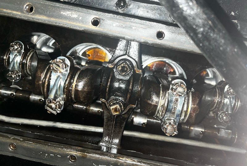

I'm seeing how the con rod dippers are attached.... I'm nervous about what tore it off...

You will have to, @ the least, lift the motor off the pan a bit. Resealing is a nightmare. This job is really a pull the motor & tear down IMHO.
For this reason I would not until you have clutch problems that require the work or another problem that needs a motor pull.
Regarding the dippers. They are junk soft. Torquing the nuts displaces the smooched metal. Feels like the threads are stripping during torquing.
Losing them is not unusual.
I don't use them. Their usage has been discredited by those in the know.
Back in the day (before these re-pops) guys used real Chevy dippers. Chevs were a hardened spring steel.

Ok so when I pull the inspection pan, I just need to look for a cause of the dipper coming off? but I don't need the dipper? I'm ok with that...speedytinc wrote: ↑Wed May 21, 2025 2:18 pmYou will have to, @ the least, lift the motor off the pan a bit. Resealing is a nightmare. This job is really a pull the motor & tear down IMHO.
or is there a real cause? just cheap junk spinning off into the ether...
I don't have an inspection pan gasket, so if I don't need to remove the pan just yet, I'd prefer it.
AND I don't need to worry about taking the engine out yet? she has been otherwise driving fine.
I'll get an inspection pan gasket on my short list of things to buy.

alright I have been reading up on dippers, and since I'm set up for them I am going to buy a set along with a few gaskets.
I'm hesitant to pull my inspection pan without a new gasket, but I will probably do that tonight anyway since I'm curious as to what other metal bits I can find.
If I find any more clutch disk pieces I'll plan for that sooner rather than later....
I was planning on a spare set of coils, and an I-timer soon, with a ruckstell waiting in the wings.... but I think I'll just continue to save up for whatever she decides I need to spend my money on.....
still love this car....
Line_Noise
- Posts: 30
- Joined: Sat Nov 19, 2022 8:50 am
- First Name: Derek
- Last Name: Dudgeon
- Location: Baltimore, MD
- Board Member Since: 2022
Re: Magneto woes… turned into clutch disk woes...
Question - did you jack the front of the car up when you drained the oil? If not, you want to do that before you pull the cover. There is like half a quart of oil in the pan dips, it is a lot less messy when you can get as much out as possible ahead of time. It is probably still going to be messy.
Also, I don't know how clean and dry your garage is, or what other purposes you use it for. If there is any chance of dust, moisture, rodents, etc. getting up in there, you might want to make two studs out of bolts or threaded rod so you can quickly get the cover back on, start a few bolts and close it up hand tight between inspection sessions, rather than just leaving it off overnight. I took a couple of matching thread size bolts and cut the heads off, worked great. You will need something anyway when you go to close it up final, when there is wet sealant on the mating surfaces and don't want to smear it all off fighting to get bolts started into the horseshoes.

I was going to drain out the lower oil check valve and jack the car up.Line_Noise wrote: ↑Thu May 22, 2025 12:53 pmQuestion - did you jack the front of the car up when you drained the oil? If not, you want to do that before you pull the cover. There is like half a quart of oil in the pan dips, it is a lot less messy when you can get as much out as possible ahead of time. It is probably still going to be messy.
It's dusty on a good day so I was going to button up the cover after inspection. not having taken one off before I wasn't counting on the gasket being re-useable.

I wasn't going to drain all the oil, just drain from the lower check valveJerry VanOoteghem wrote: ↑Thu May 22, 2025 2:20 pmDid you remove the drain plug at the bottom of the pan?
- Posts: 5167
What the point of that?
Pull the drain plug & feel around & find any other pieces.
If you want to limit good oil loss, save it & put it back in.
- Posts: 5427
- Last Name: Hatch
- Location: Alabama
Willy needs to look up what happens when something hangs on a model T magnet and wipes out the mag coils!
Or when a clutch hangs up or explodes.
Lot cheaper now than after that happens.
But, you got by lucky on that piece that fell pass the magnets already. If that had been me I’d be replacing magnets, coil and who knows what else. Your mileage may vary. Dan
- Posts: 4400
You'll want to remove the plug to see if any more fragments of ??? come out with the oil. The screen doesn't catch everything. Some of it will settle to the bottom, where the plug is.WillyR wrote: ↑Thu May 22, 2025 2:37 pmI wasn't going to drain all the oil, just drain from the lower check valveJerry VanOoteghem wrote: ↑Thu May 22, 2025 2:20 pmDid you remove the drain plug at the bottom of the pan?

I already fiddled around at the drain plug and didn't find anything more there, that's where the clutch plate looking piece came from

I got a mess of parts and gaskets on order, I should be able to borrow some stuff on monday to get her back on the road.
But tonight I'll pull that pan and see for sure where I'm at.

It looks quite nice in there, no signs of other foreign matter.
The holder piece for the scooper is tight no signs of con rod problems. On any of the caps.
The previous owner recalls one of the rod may have had a shim removed some time ago.
It this was the one and the old scooper was reused that could explain its failure.

- Posts: 5427
- Last Name: Hatch
- Location: Alabama
Look at rod number 3, marked in yellow.
- Posts: 7166
The dippers need fiting. This means if they are too wide to go between the raised edges of the cap, they need to be narrowed to fit. If the rod bolt holes don't line up when they do fit between the ridges, the holes need to be reworked. The dippers should not just be placed over the bolts and the nuts drawn up, deforming stuff as they are tightened. I believe the dipper part id spot welded to the base, and stretching/deforming it may have broken that weld.
With the pan cover off, it is wise to remove the horseshoes in the pan and clean out any crud which may have lodged between the shoes and the pan sides.
TFan
- Posts: 410
- First Name: Jim
- Last Name: Riedy
- Location: Sandusky,Ohio
Maybe it's just my eyes but I see no hole for the dipper to push the oil through where the scoop is missing. Jim
- Posts: 5427
- Last Name: Hatch
- Location: Alabama
I don’t see one either. But something made the scoop come off.
They don’t just fall off for the fun of it. Need to at least take cap off and check bearing. Check the cover and be sure not hitting something.
- Posts: 4400
I believe you're correct, Jim. That being the case, there's no reason to use dippers at all. If it were mine, I'd just remove them entirely.
Some will say that they will still splash oil around. They apparently, will also fall apart... Not worth it.

There is a looberkashun hole in the cap.
I have a new dipper and I can see how it’s spot welded to the flange.
When I get the old one off I’ll see where the old one failed.
I’m watching kitchen nightmares now and I’ll button her up in a few minutes.

I didn't get to drive her today, I was in a rush and needed to stop for gas.
I did, just now order an analog multimeter, and I figure I may keep it in the trunk maybe....
I also ordered my pinstriping paint...
AND last night, I had never started it by the crank before, and after lubing the slapper timer with dow 33, I choked her one crank, and she fired right up with the next.
She was mildly warm from running her a bit a few hours prior, but after I figured out I don't need to choke the living tar out of her even when using the electric starter.
When cold two quick cranks with choke and electric and she fires right up....

Those dippers show signs of never being fitted, just put over the rod bolts and drawn down, conforming to the rod as they go.They should not distort inwards at the sides of the scoop, and the rod holes should not be stretched oval If they were fitted, there would need to be some relief on the sides so they would settle between the webs on the cap without distorting the sides of the dipper. Then, if the bolt holes did not line up, they should be deliberately reworked into an oval shape so that the foot can rest on the cap bolt holes. The bolt will the fit without stretching the eye in the dipper body.
Like a number of reproduction parts, they need reworking so they can do what they are supposed to do. Who can remember the amount of fettling needed to make the old two piece, cast iron, lined emergency brake shoes?
Allan from down under

Could be, I fitted this one, (rounded to the cap shape) it didn't take much, I think I'll check my transmission screen every time I lube my timer. so 200 miles or so.Allan wrote: ↑Wed May 28, 2025 3:04 amThose dippers show signs of never being fitted, just put over the rod bolts and drawn down, conforming to the rod as they go.They should not distort inwards at the sides of the scoop, and the rod holes should not be stretched oval If they were fitted, there would need to be some relief on the sides so they would settle between the webs on the cap without distorting the sides of the dipper. Then, if the bolt holes did not line up, they should be deliberately reworked into an oval shape so that the foot can rest on the cap bolt holes. The bolt will the fit without stretching the eye in the dipper body.

Is there actually a hole in the rod cap? That looks like it is just a punch mark, if a hole it is rather small.
Craig.
Craig.

Saturday is a club breakfast, and Sunday I'll be checking my transmission screen for odd ball metal and kewpie dolls and such.
no other odd sounds since that piece possibly came off a clutch disc...
running flawlessly.....
I now have a plethora of gaskets so I can inspect ad nauseum...
I have not tired my new analog multimeter on my magneto but will do this on sunday...
