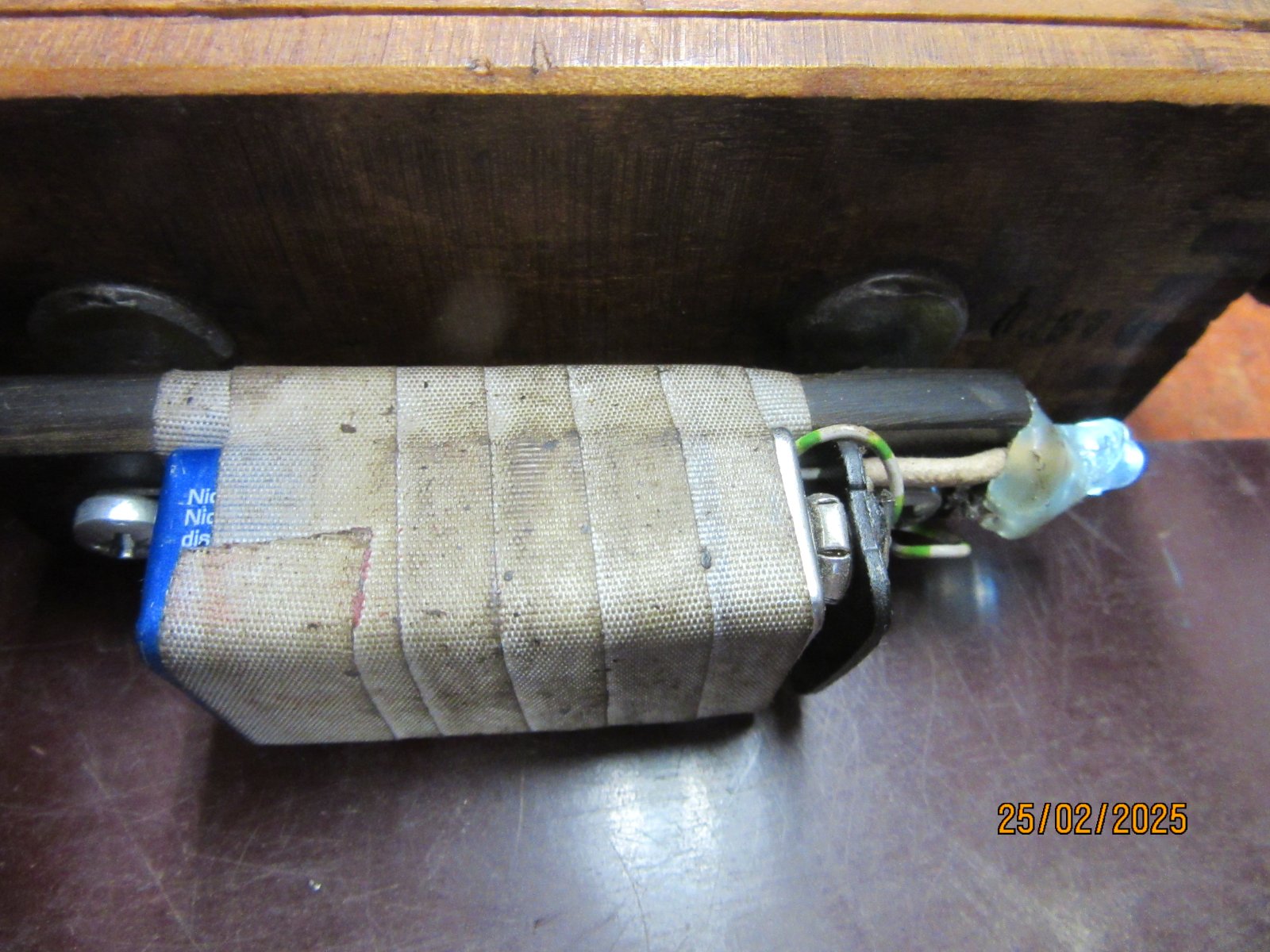

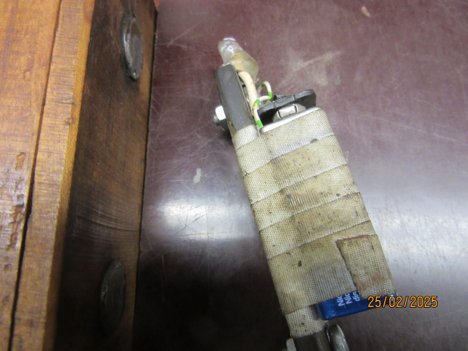

The Beeper tester has prongs to stick into the coil solder pads. What type of contact will your card size have? Will the contacts have points to meet a crusted solder pad to be sure of good contact?
On the Beeper, found that it will beep if the contacts can both meet any metal surface, so when carried about, have to keep plastic caps on the pointed contacts. That helps prevent beep and battery drain, and protect the pocket or bag the Beeper is carried in to prevent sticks from the sharp contacts.
And have to wrap tape around the board to keep the 9v battery from escaping, it is held only with the battery contacts and can fly apart from the board easy. So your contained coin battery will be a great improvement.

Mine didn't have that accessory
But the friction tape works, and just peeled away more for the photo, and I used the black friction tape to 'disguise' the device. Lots of sellers of old coils kinda looked at the little black box in my hand that made their coils either beep or not.
Some would ask ‘'what is that thing? I would just say it reads left over voltage so I don't get shocked

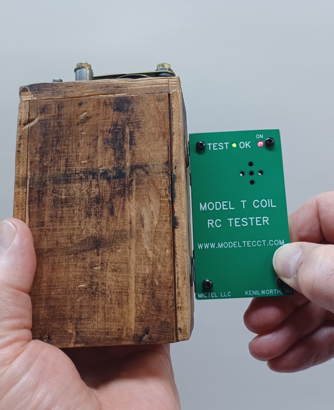

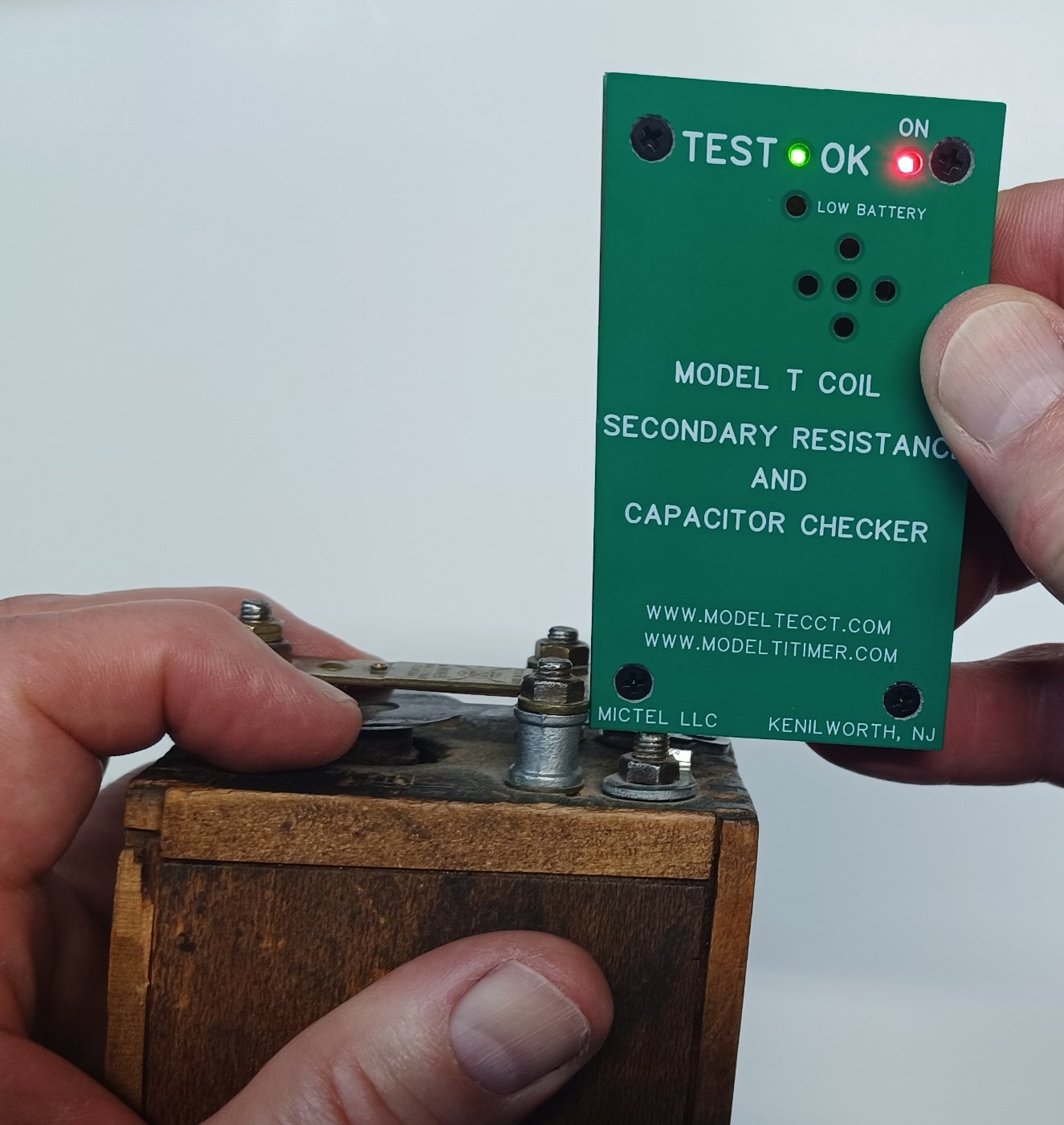

Just finished building the prototype Model T Coil RC Tester. First pass success!
The circuit simulation software really is that good in helping to get it right the first time.
Only problem is.... the tiny beeper that fits in the compact case puts out a tiny sound that you can hardly hear.
Question: Do you think the Beep is really necessary?
The Green LED tells you all you need to know and does so without broadcasting what you just learned about a perspective coil.
Coil Secondary Winding Resistance Check: 1850 to 3840 Ohms = OK
Capacitor Value Check: 0.47uF +/- 20% = OK
Inside Voice: "Humm, That's a great coil for $10..." OK, I'll take a chance on it for $10

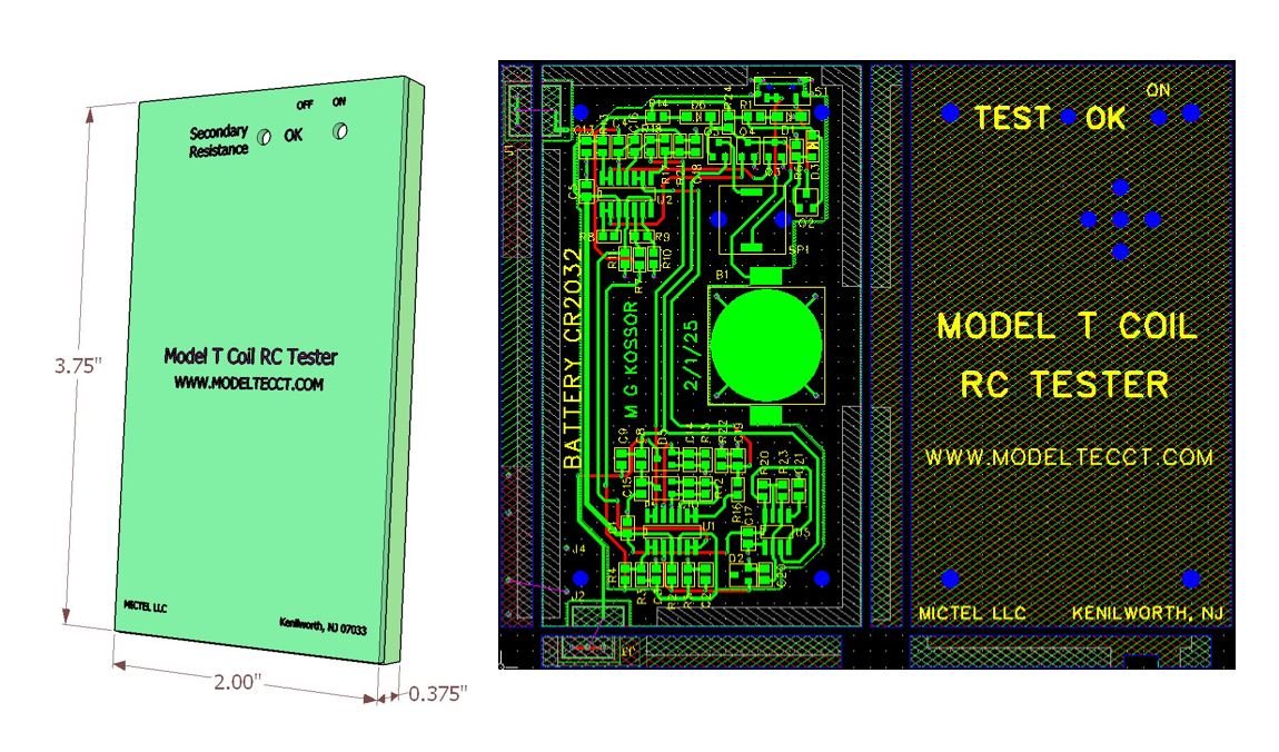

Update: prototype circuit boards are due in this week. I was able to incorporate most of the great suggestions made here.
If all goes well, should have a production run made late May or early April.

I believe the Capacitor value in original Ford coils was 0.5uF, if so, yes the new Model T coil secondary resistance and capacitor checker will tell you if the capacitor Value is 0.47uF +/- 20% and may not need replacing.

Pocket Coil Checker - Update
Several design revisions were made thanks to great feedback from folks here and the Model T FB groups.
The new Digital Version is the same business card size but has significantly fewer components and more features:
1. Power turns on automatically when secondary resistance measurement is detected
2. Power ON indicator
3. Checks Model T coil secondary resistance is within its nominal range (2200 to 3800 Ohms)
4. Checks Model T capacitor value is within its nominal range ( 0.47uF +/- 20%)
5. The TEST OK beep can easily be turned off (or on) based on user preference
6. Low battery alert is signaled by 4 short beeps at power up and flashing Low Battery LED
Thank you for the helpful suggestions to make a Model T tool with feature folks need and want.
A few more bugs to workout so if there is a feature missing let me know soon! Should have them available by June.
The Pocket Coil Checker instruction manual can be viewed here: https://img1.wsimg.com/blobby/go/f76807 ... 6840302570

The one suggestion I don't is to make sure the lights are bright enough to in the bright of day outside. Sometimes you cant see if the light is on or not in the daylight.
As Tom Sellick told Marston in the movie Quigley Down Under, I told you I dont have much use for handguns, I never said I didn't know how to use them!
