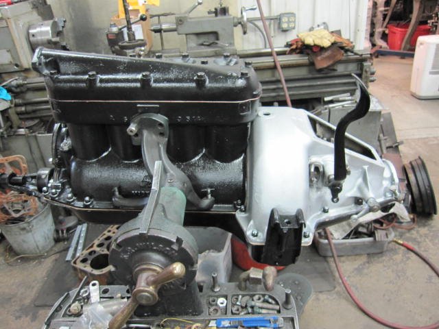

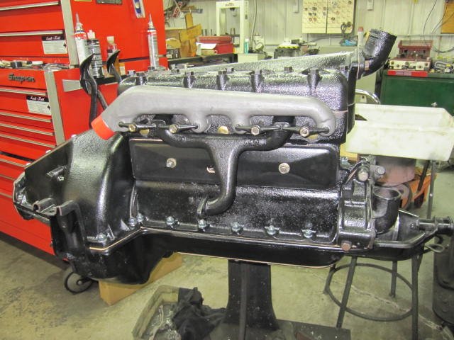

I don't see an issue as we've been doing so for 40 years now. KR Wilson was an authorized supplier of FORD tools . These are KRW stands we support the T, A and V8 engine's on .Martinbuilt wrote: ↑Wed May 28, 2025 10:55 amI'm new to model T's.
The motor i bought came mounted on a small wooden cart.
I recently overhauled a model A engine, which i had hanging on one of those water-inlet brackets that Snyders sells.
Is it safe to hang this T motor with the hogshead and everything together?
It seems like a lot of stress on those two threaded holes.
I'm sure Henry Ok'd how the engine was to mounted on an engine stand.
