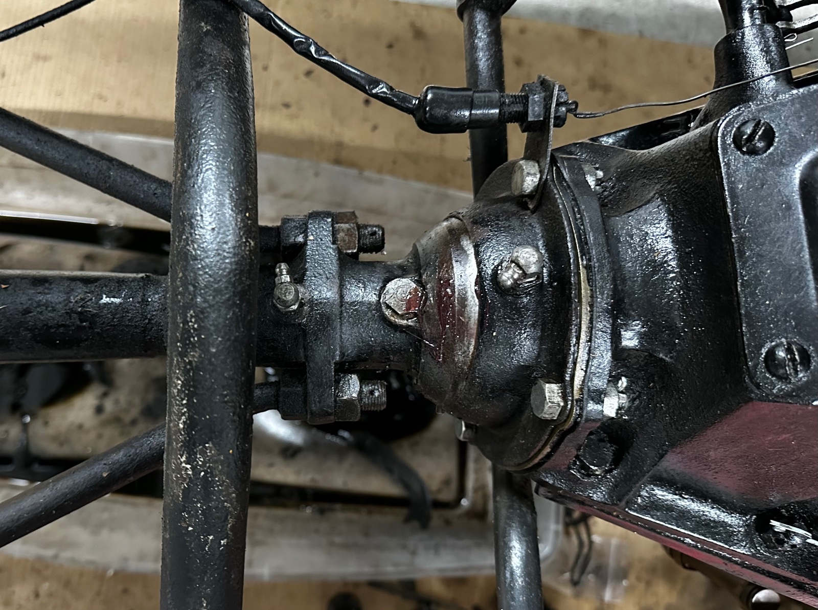

I inherited this 1919 roadster from my dad. Trying to stop, or at least reduce all leaks. So far I've resealed the inspection cover using aircraft sealant and neoprene/metal washers. No more drips there! Then the outside oil line and persons for the oil level with ezturn. Tightened up all the block to pan and hogs head bolts and cotter pinned. Sealed up gen mount, put one of those seals in the starter with a new busing and all new gaskets. Everything coated with aircraft sealant.

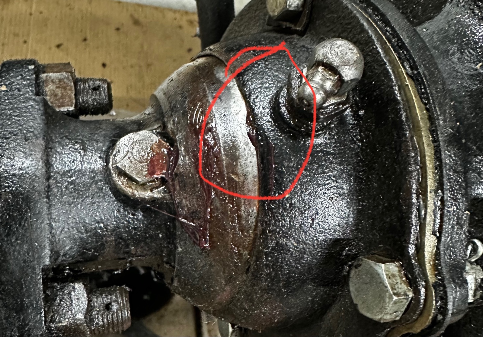

The one spot I cannot figure out is why a sliver of the grease hole shows at the top of the ujoint housing.
Grease just oozes out of here when running, driveshaft spinning.
The car has "float-a-ford" springs all around, but that doesn't seem to affect the height from the rear end. Any thoughts? Wrong rear leaf? Take a few leafs off? Any input is appreciated!

That is a tough area to seal or even slow down. But a constant ooze whall running points to possible reasons & ways to limit the leak.
One of biggest causes is a poor 4th main to output shaft fit. Clearance should be .0015" A missing output shaft plug can contribute.
A looser fit, thin & overfilled oil will allow oil past the shaft into the U-joint pocket. An exacerbator is the modern transmission screen which dumps its excess oil right on the 4th main. The 4th main has a lube hole on top. It can be rotated 180 degrees to limit some of the excess oil that comes from the screen. (If it was correctly center machined) & the pan is in alignment.
There can be excessive wear on the ball & flange fit. A shim is available to fill/take up for the wear. It is a ball joint & must be able to freely allow the DS to move up & down.
Use a thick grease.
I have tried a thin layer of ultra black under the outer edge of the flange.(Flange oil free) Run a small bead , let it set up an hour or so.
place in position to form the soft ultra.(Ball well oiled or greased) Bolt on with about a 2 thread gap. Let the ultra dry overnight. Snug home the next day.
This worked a few hundred miles, but eventually pounded out the sealer. So, I live with the ooze.

The quick answer is nothing you can do. There is no seal there, and no rear main seal.

With the T jacked up like it is, engage & disengage the handbrake as you would in normal driving conditions - look very closely at the ball socket for ANY fore & aft movement - could be a worn torque tube ball.

Remove this gasket and it may help you some. Only 1 gasket is needed here, between the 4th main and hogshead.
Other than that... they just leak.
I will say, however, that your retainer ring kind of looks stretched out, letting ball go too far back. It almost looks like the lube hole in the ball is peeking out.

Jerry is correct about just one gasket needed at that joint, between the pan and the fourth main. However,I am not convinced that he is seeing an extra gasket there, just the back edge of the fourth main bearing flange.
If there is a gasket there, it opens up the ball housing, allowing excess movement and grease escape.

Jerry might be on to something with the edge of the fill hole showing. I thought it was a bit of grease.
The hole may be uncovered by the frame being up on jack stands? It would appear so looking @ the wear pattern around the ball.
I first thought there was a gasket also, until I studied the different pix. I think its a clean 4th main edge.

Wait, that you are pointing to is the 4th main. It's one of those sealed ball bearing units. This drivetrain was fully rebuilt a few years back.
What is between the cap and the bearing is a small bead of rtv.

If the DS ball was chopped/BUTCHERED per instructions, there is normally more slop added to the joint. A ball shim may help. Not a fan of the ball bearing conversion. Another repop part causing more problems than stock. IMHO.

If one enlarges the top photo, clearly seen is the wear pattern that John spied - no doubt the modification to a ball bearing 4th main has exacerbated the sloppiness in the unit thus the grease releasing !
Bingo. Moved forward quite a bit. Will try to install the shim and report back.

Once you put weight on the car, you will no longer see the hole.

The torque ball fits into the fourth main ball & ball cap. Its a simple ball & socket fit needing lubrication. There is no seal like for a CV joint.
The movement of the torque tube is bound to cause some grease to be squeezed out. The more wear in these parts, the more ooze of grease. But its good to see some ooze so you know things are getting lubricated. There appears to be a wear line on the ball end of the torque tube from its movement. I'll let others weigh in on the degree of wear. Suppliers have a shim to tighten things up, doubt if you need it because it may already be in use.
