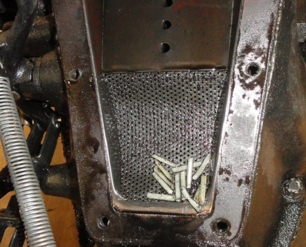

Re: 7.5 degree timing advance
Back in NOV 2015 I got stuck on the side of the road. Here's why (see photo). Upon repair I installed the bronze gear and have had no problems.
