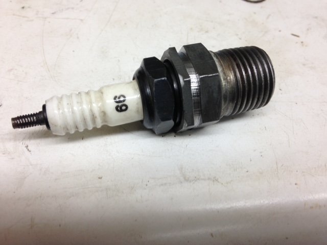

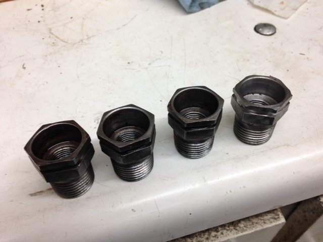

Hi Rick,
All my engines run 14mm plugs. I don't know what reach you need, I use Autolite 66 plugs they are a 1" reach ( that is plug seat to electrode end)
& they have a removable end. I run distributors so I have no experience with them using T coils but I also used them in KT-100 2 stroke kart race
engines turning over 13,000 rpm so I think they will handle the multi spark OK. I make my own adapters out of the old Autolite & Champion
crimped plugs no one likes so they look like 1/2" pipe spark plugs. Craig.

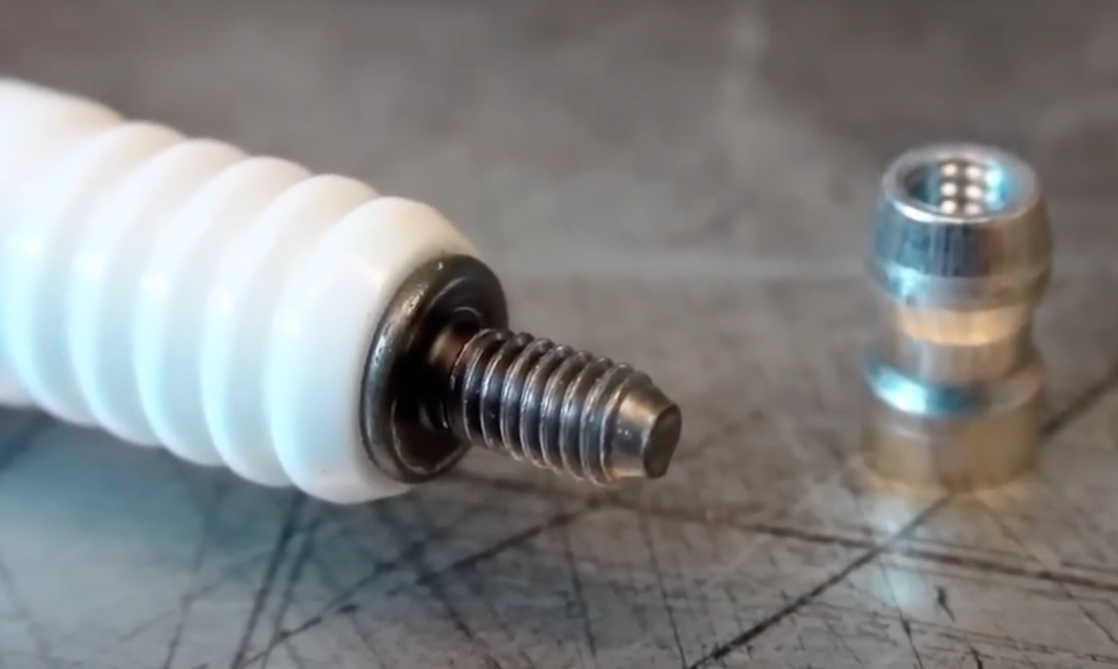

- Posts: 4694
Re: 14 mm Spark Plug Recommendations?
If you have the original wires, they will fit on the plug as shown in the picture. Then screw on those snap on connectors and they will hold the wires. If the thread is the same you could use the original type nuts. You would need to try them to see if the thread fits.
