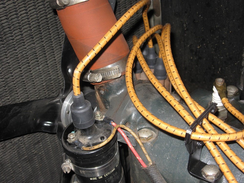

I have had a very similar problem recently. I replace 3 sets of points coils and condensers in less than a month. One of our suppliers ask how the coil was mounted, when I bought my T the coil was laying on its side. He said if it was vertically mounted the electrolytic oil would have a better chance of insulating the internals.
I changed the mounting position about a month ago and the problem has gone away. I'm in my mid 70's, grew up around old tractors and can't remember ever seeing a coil mounted on its side. Well, it worked for me.

I made a bracket to mount the coil on the driver side off the water neck away from the heat.
