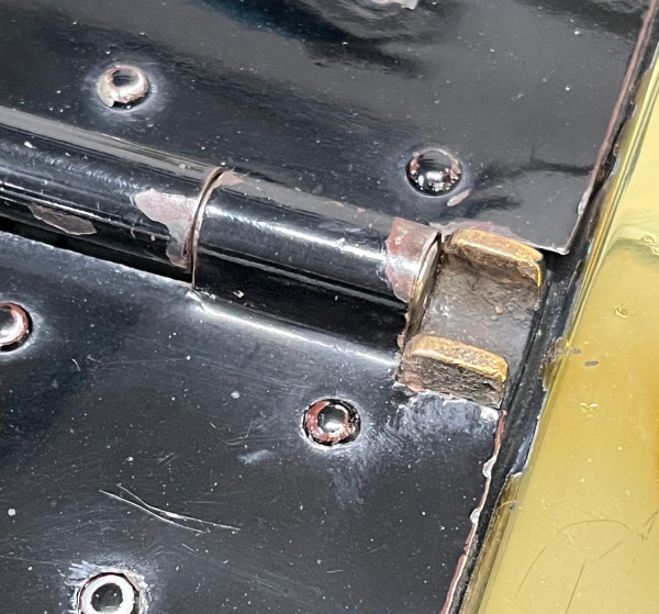

Maybe you could use a small prick punch and tighten the front loop of the hood to the rod, from the underside, fastening that loop, keeping the hinge rod from riding backwards.

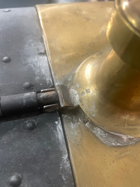

On my '12 project someone in the past had the opposite problem with the hinge rod siding forward and letting the rear end come free at the hood former. So that clever fellow soldered a tab to the radiator for a stop

Mark, I had the same problem with my 1915 Runabout that I used to own. Dan's suggestion may work, or even a small blob of JB weld on the rod ahead of the forward hinge loop. Our 1911 hood hinge rod does not move at all for some reason.

John, there is no mention of it being cut shorter. As others tell, they can migrate, either forward or back, probably due to vibration. The radiator will stop it going too far forward, but the mod shown in one of the photos will stop it wearing a hole in the top tank. There is nothing for it to come up against at the back. It can disappear into the void in the hood shelf. The shoulder I soldered on stopped this, and helped disguise the worn hole in the shelf. The other trick is to do some damage to the hinge rod to make it a firmer fit in the panels.
