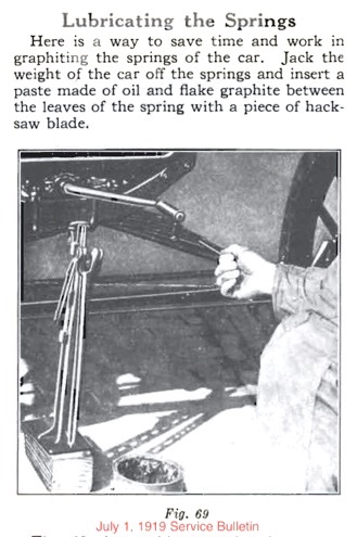

After you finish prepping and painting the spring leaves, I suggest getting powdered graphite from the hardware store. .....Use chassis grease & lightly grease both sides of each spring leaf,.... just the bottom of the top leaf and the top of the bottom leaf,... and lightly sprinkle graphite on each greased side as the spring unit is assembled.... worked for me. ... May be a slight drawback, as with driving and flexing springs will require wiping visible graphited grease that squeezed out.

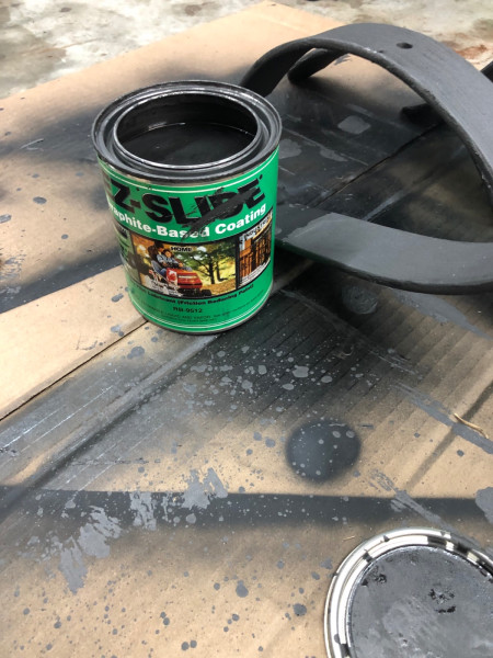

E-Z Slide paint is just a graphite powder in an oil base paint - make your own

Once made a mix of grease and powdered graphite lube, which was in the small key lock tube, but that mix just kept seeping out between the leaves and looked messy. Dry slippery graphite is better. EZ Slide and Slip Plate paints dry on application leaving dry, slippery graphite shiny silver surface.

Ford did issue this method in the field to oil and graphite the leaves, but that is messy IMO.

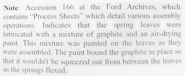

Maybe this will help get around your hazmat problem. Here is Ford’s original slip paint formula. I mixed some in 2002 and painted my leaf springs with it. It worked/works.
See: www.mtfca.com/discus/messages/29/19078.html

The graphite/enamel/mineral spirits mix does harden and provides great slickness between the leafs. After applying, assemble the leafs together and tighten, then clean off any mix on the outside edges, tops and bottoms of the assembled springs with mineral spirits and paint with a gloss black paint of your choice. I brush painted mine with gloss enamel since it goes on nice and smooth with a brush and is somewhat flexible. Also, it is the paint Ford would have used.
- Posts: 5549
Re: Painting springs
100% This is how it was don't by Ford for the T, think that info is in the Ford Service Bulletin's. The Model A and later didn't use anything between the leaves, just bare metal, grease was not even recommended.jiminbartow wrote: ↑Mon Jul 07, 2025 11:53 amThe graphite/enamel/mineral spirits mix does harden and provides great slickness between the leafs. After applying, assemble the leafs together and tighten, then clean off any mix on the outside edges, tops and bottoms of the assembled springs with mineral spirits and paint with a gloss black paint of your choice. I brush painted mine with gloss enamel since it goes on nice and smooth with a brush and is somewhat flexible. Also, it is the paint Ford would have used.
