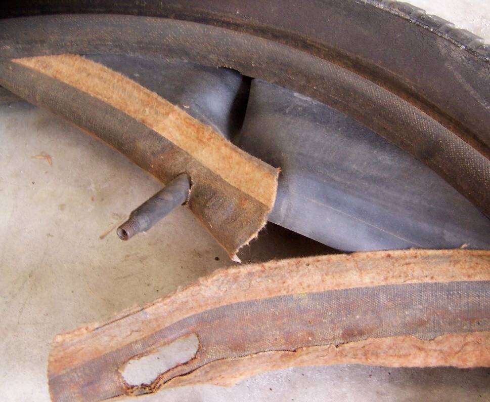

The old time flaps for clincher rims were either very thin more like liners, or more robust ones and thicker.

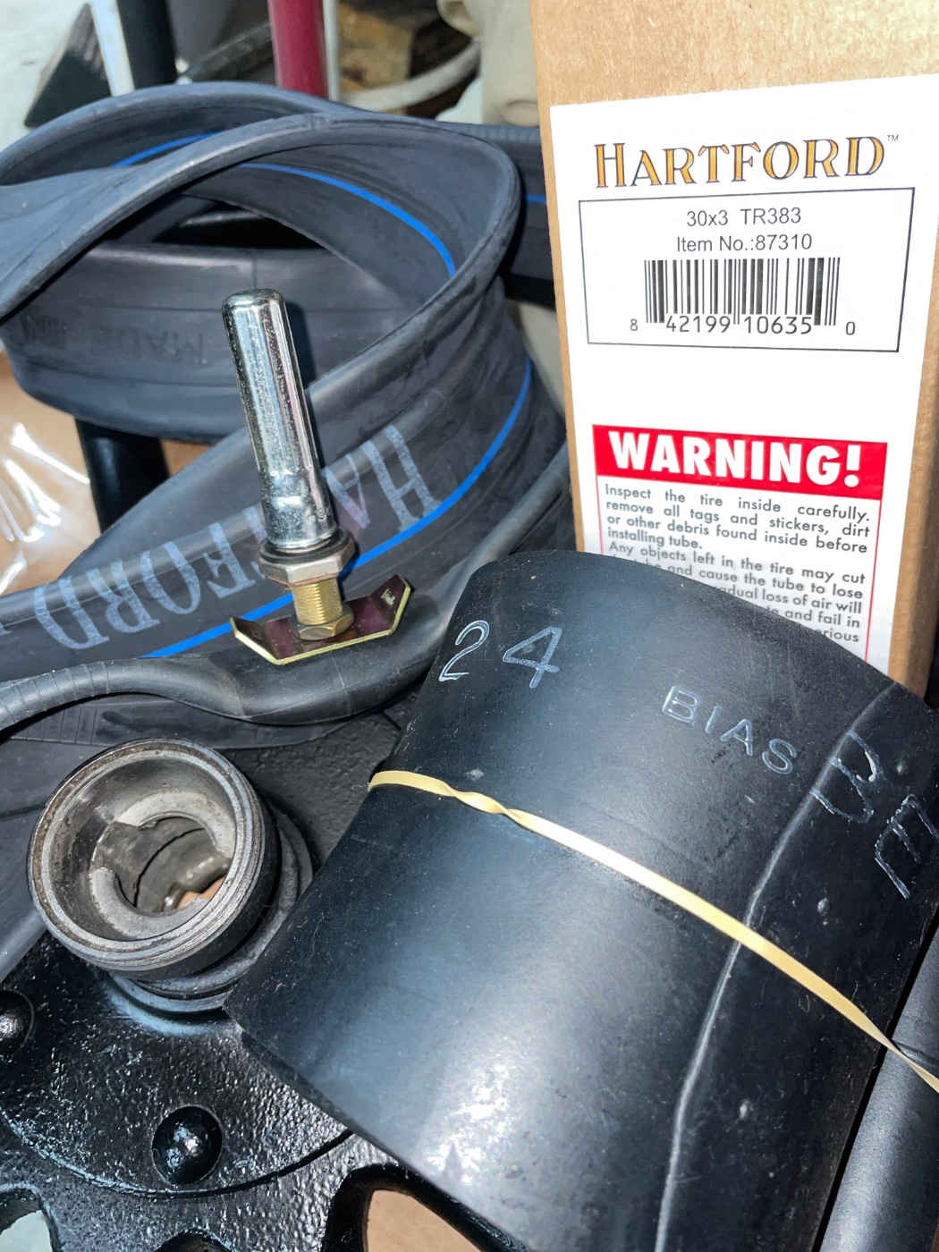

What is today a clincher flap is rather more thick, stiffer, and bit wider. IMO they are ok to use, only time had a struggle was with a 30x3 size, the 24" flap and tube fit, little more tire tool work though.. (BTW, a flap was std. Ford issue for 21" split rims, as the split and lock fitting rivets have to be covered with a flap to protect the tube.)

Dan's photo of the old time flap is revealing. Even this tough old fibre reinforced flap and the tube, have clearly been driven down to the rim base. It also shows that it is unnecessary to notch the bead to fit the valve stem.
