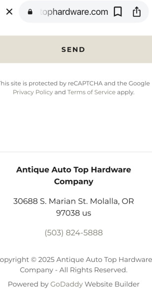

You might call this outfit , may have a saddle that fits.

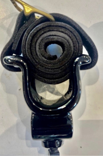

This is the measure made on the socket diameter.
1910 touring, original saddles, reproduction top sockets with the following measurements:
Top socket width 1-45/128"
That would be about 1 3/8" diameter, give or take.
But remember the saddle will have a leather strap laying in the curve, so you have to add that thickness too.
