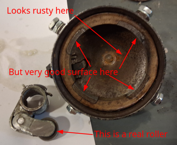

Well, I guess I somehow destroyed my roller timer within approx. 1000km, but I have no idea, how. (-> therefore I ask here, in hope to find out what I did wrong)
- The roller itself has a huge play on its axle, so either the axle, roller bore, or both is heavily worn out. I can rotate the roller for approx 2-3 degrees!
- The outer surface of the roller is like 60 mesh sand paper.
- The surface of metal plates on contact ring is also like sand paper.
- The Bakelite ring (insulator) has a dent before and after every metal plate, so deep, that you can easily feel it with the finger when sliding over it. It is really deep (or feels like so).
- The brass shim for the felt ring behind the roller arm is loose and flapping around when the timer cap is removed. I don't know it it has to be so loose in this case.
I assume the roller never saw any oil while I dripped in some oil from time to time. This caused this extreme wear. And this in turn causes a bumpy run of the engine when speed is above 40 kph (not mph!!). For sure the roller will jump out of every dent in Bakelite, this results in delayed contact for ignition, and so I actually get a later ignition. Also explains while I drove most of the time with fully advanced spark, also at medium speed.

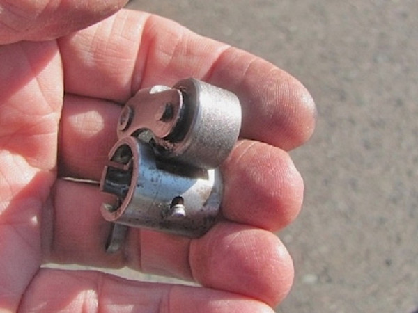

Remember that at 1000 rpm the timer roller is making 2000 contacts a minute. That is about 30 mph.
1000 rpm crankshaft speed. The cam, which the timer roller is mounted on, turns half of engine speed, 500 revolutions per minute. The timer roller makes 4 contacts in the timer case for every revolution = 2000 contacts per minute. Lots of wear can happened without lubrication.
This roller was causing miss at speed, as surface was worn from debris by poor maintenance.

I have the impression you are talking of timers with sliding contact, as you are talking of brushes?speedytinc wrote: ↑Fri Jul 11, 2025 5:58 pmThe new roller timers available in the past,( I cant speak to current production, but I doubt their quality has changed) are/were junk new out of the box. Inside contacts must be perfectly round & centered, they were not. New rollers commonly wear out quickly.
This is why those in the know don't run them. Look @ what the Montana boys run - Anderson's & new days.
My own experimentation has led me to the New Day with a soft carbon brush. I get several thousand miles between cleaning the carbon dust out.
I carry an extra carbon brush in case I get caught with a worn brush on the road.
This is one of the "new" roller timers I got:
It is a little bit rusty inside, but the contact ring is in very good condition, with even, clean and smooth surface. I will use some sanding paper to get out some of this surface rust, then I will paint it a little bit in black before installation (of course, not the contact surface).
This timer looks LOTS better than my old one.

The new timer you show seems to have higher edges on the contact edges than the adjacent insulators. This is no good. The inside must be perfectly smooth & centered. Anything less will cause the roller to bounce causing a washboard wear pattern & worse running the higher the RPMs.
Sandpaper wont do it. The timer must be trued in a lathe.

Hi.speedytinc wrote: ↑Fri Jul 11, 2025 6:25 pmThe new timer you show seems to have higher edges on the contact edges than the adjacent insulators. This is no good. The inside must be perfectly smooth & centered. Anything less will cause the roller to bounce causing a washboard wear pattern & worse running the higher the RPMs.
Roller timers need constant attention. Oil before each drive AND every 200 miles if on a long drive.Your description sounds like the timer wasnt oiled enough.
The picture shows that the contacts are a very little bit wider (sideways), but this is out of where the roller is. The inner radius (where the roller is in touch) is smooth, no changes in height.
I will get my lathe finished in 1 week or so, then I will give the timer a little touch from inner side to verify that it is really 100% round.
The washboard wear pattern and what you describe is what my old timer shows.

Rainer, that timer has nice thick metal contacts in the ring. It is a good candidate to be re-machined in a lathe so that you clean up the rust and make the roller track perfectly round.
In my first years of T model ownership I ran the timer packed full of red grease. It worked really well. When I came back to T models in the late 70's I went the same route, but it was not much good. Whether the grease formula was changed in the intervening years I do not know.

A possible cause of the sandpaper look to the contact surfaces and roller is electrical arcing. One cause for excess arcing could be excess current draw from the coils. Another could be excessively thick lubricant. Worn parts would probably aggravate both arcing and promote rapid further wear. I would expect a Ford type roller timer to perform best and last longest when lubricated and maintained as Ford directed and when run on Magneto most of the time using well adjusted coils.

Although this timer might look ok, it is flawed and I would not use it. The insulating rim has a crack in it right under one of the contacts. This creates a perfect location create a short circuit and cause mis firing. If the crack is on the bottom section of the timer, it will be subject to ingress of hot oil and will fail quickly.rainer wrote: ↑Fri Jul 11, 2025 6:18 pmI have the impression you are talking of timers with sliding contact, as you are talking of brushes?speedytinc wrote: ↑Fri Jul 11, 2025 5:58 pmThe new roller timers available in the past,( I cant speak to current production, but I doubt their quality has changed) are/were junk new out of the box. Inside contacts must be perfectly round & centered, they were not. New rollers commonly wear out quickly.
