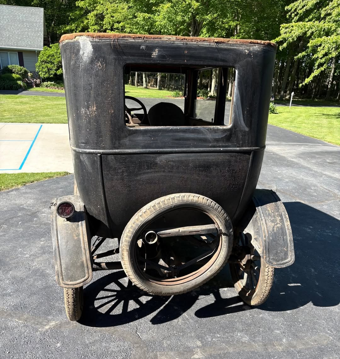

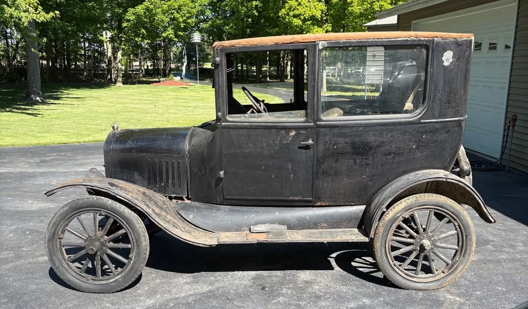

Hello, my name is Kevin and I just purchased a 1923 Ford Model T Tudor. The car is very complete and original looking. It needs a few things to get road worthy. One thing it is missing is the gas tank. I've been a car guy all my life, so not new to cars. My question is this, where does the gas tank reside in a Tudor? The information I have read says the '23 used an oval tank. The driver seat is secured to the floor. The passenger seat hinges forward. So, that leaves no possibility of the tank being mounted under the front seat. The rear seat is difficult to remove. It doesn't appear to be enough room under it for the oval tank to fit. Under the car hangs the battery and exhaust system. I'm at a loss for where the tank can fit. Any help, advice and/or possible pictures would be greatly appreciated. Thank you in advance. Kevin

The gasoline tank should reside under/inside the driver's seat, under the small cushion. It is a sort of square/ cube shape, with a slightly slanted top. It is accessed by removing the driver's seat bottom cushion. The seat needs to be unbolted from the floor to remove or install the gasoline tank. It is a bit smaller than the oval or round tanks used in mode body styles (about 8 gallons?). Both the earlier center-door sedans and the later two-door sedans as well as SOME early style coupes (mounted inside the small turtle deck/trunk near the back) used basically the same small tank.
The tank might still be there?
That looks like a nice original two-door sedan.

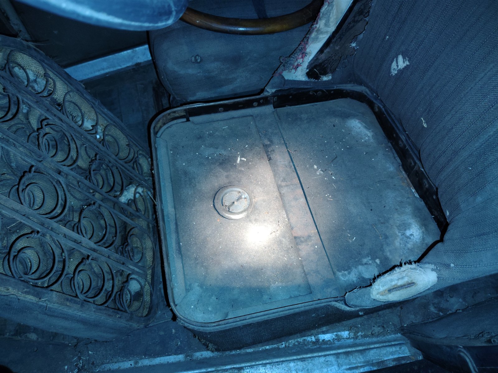

I believe the tank under the seat would look similar to this

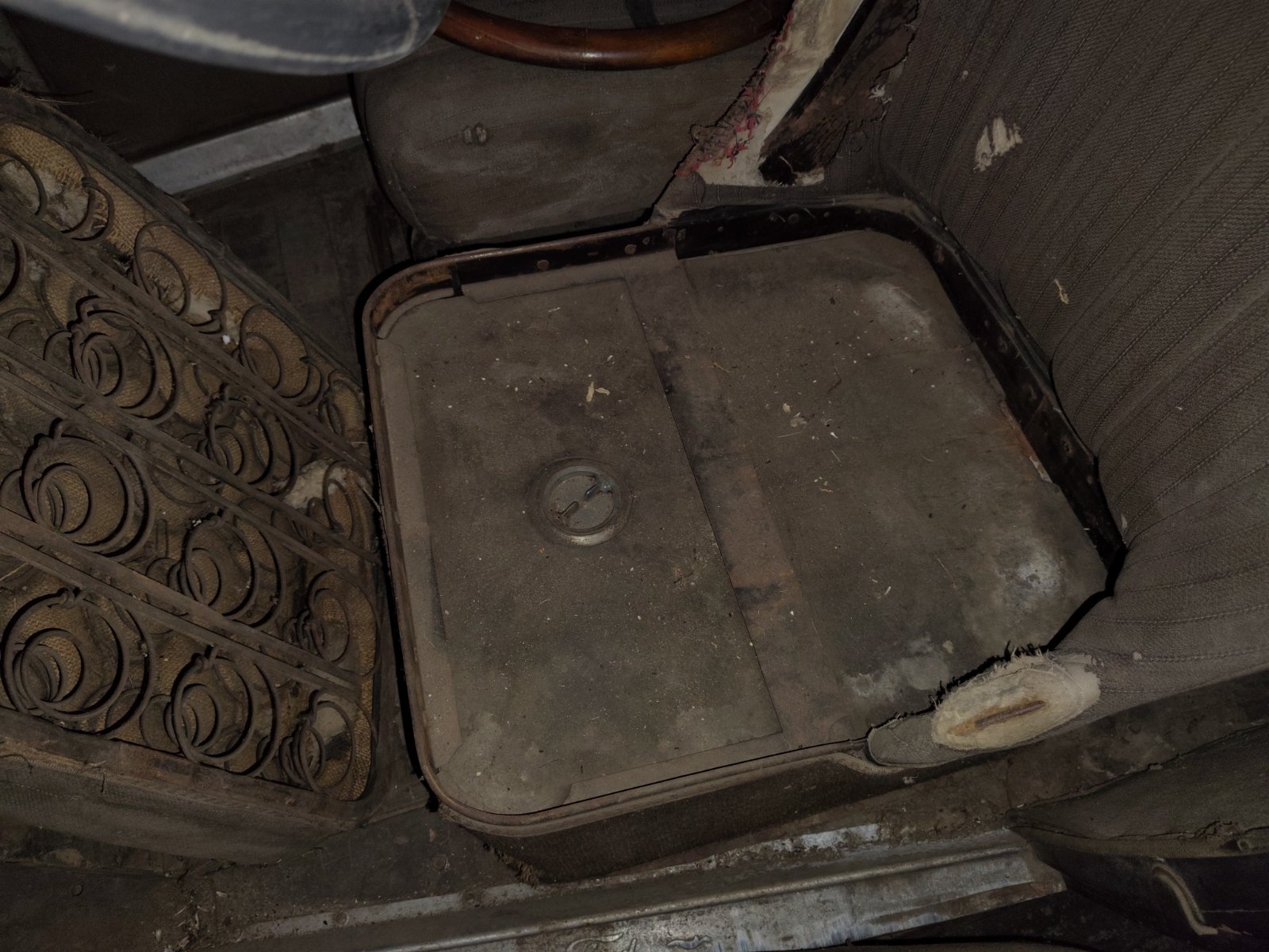

THANK YOU!! I thought I was going crazy. The gas tank sure enough is under the driver's seat. Sorry for the bad pictures. The car is still in my enclosed trailer. So, not much lighting. A quick peek inside the tank and it looks reasonably clean. It's been difficult looking the car over in the trailer. Very hot at times too. I followed the fuel line from the carb, but it just ended near the battery. The sediment bulb is in the box of parts that came with the car. It not being attached to the tank, I had no idea to look up at the floor under the seat. Thank you again for the information. It is much appreciated. Kevin
