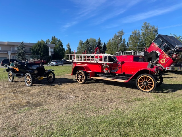

I took the car to a show today and it ran fine with the new needle. As the oldest car there they asked me to park it next to the fire department’s restored 1923 fire engine.
