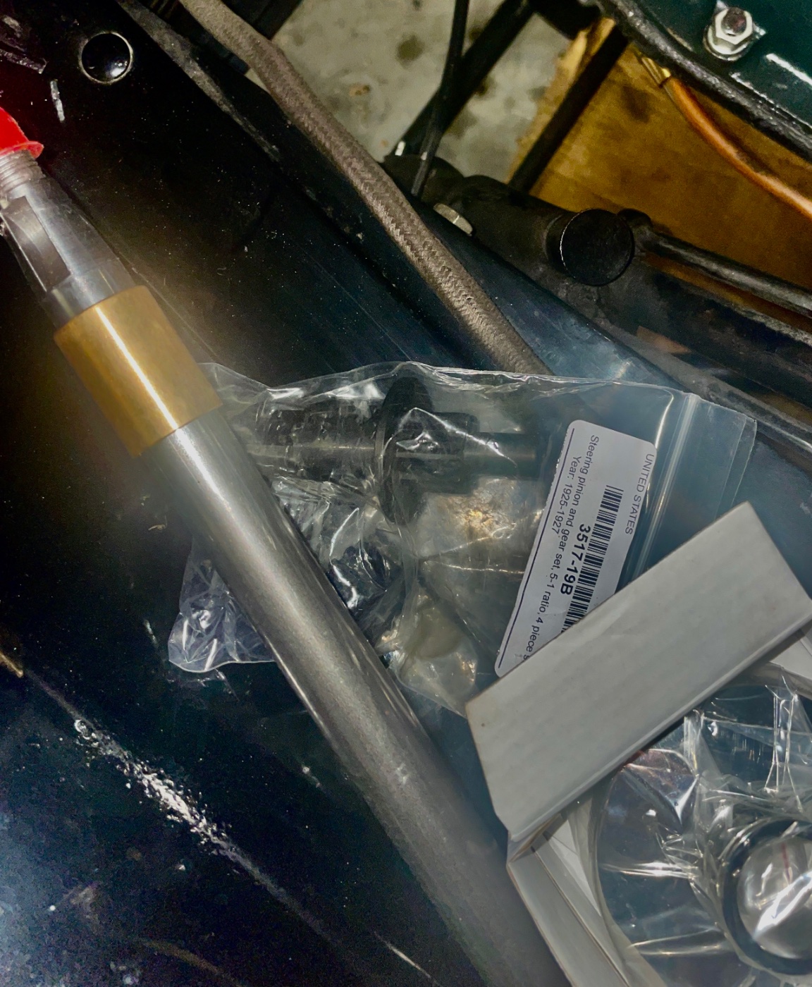

Will be restoring the steering gear on my '27 soon.
Last done in 2003, and now the steering shaft is wobbly in the bracket bushing. The shaft was an old original and when fitting the new bushing, reamed it to a slip fit. Likely now that old shaft was a bit oblong worn anyway, and fitting a new bushing gained some more life.
So got a new 5:1 shaft from Birdhaven, along with new pinion gears for the cluster, and a new reproduction cluster cover too.
Note the shaft has the new 7/8" bushing fitted for display, and there is just 1 bushing in the correct '26-'27 steering bracket factory number marked on the bracket, T-932C. The '26-'27 Fordor and bare chassis uses a different part, T-933.
