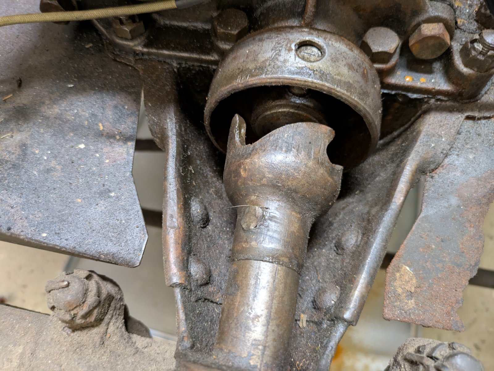

I learned something new yesterday. I am in the process of pulling the engine on an early 1914 T and I was getting ready to pull the pin holding the crank handle ratchet, when I discovered that the pin was permanently installed with both ends peened. I asked Larry Smith about it, and he said that is how Ford used to do it! Anyway, a couple of minutes with a Dremel with a grinding stone and I was able to drive out the pin. You can just barely slip the fan belt between the ratchet and fan pulley, but there's not a lot of extra room.
I will use either use a pin that takes a cotter key or one of the pins with a spring clip attached to one end that allows easy removal of the pin without the need of a cotter pin. Unfortunately Snyders is out of those right now.
My question to the forum members is whether Ford always peened the pin for the ratchet to the crank handle on all the T's that were produced, or did they eventually switch to the removeable pin with a cotter key? It seems like it would have been cheaper for Ford to use a pin and cotter pin than taking the time to peen both ends, but they were the time study experts. It certainly is not as user friendly as being able to remove it for putting a fan belt off/on.

The ratchet in your photo is definitely the early style. Clean it up, and reuse it.

Definitely! There is not much wear on it.Original Smith wrote: ↑Mon Jul 28, 2025 6:05 pmThe ratchet in your photo is definitely the early style. Clean it up, and reuse it.
