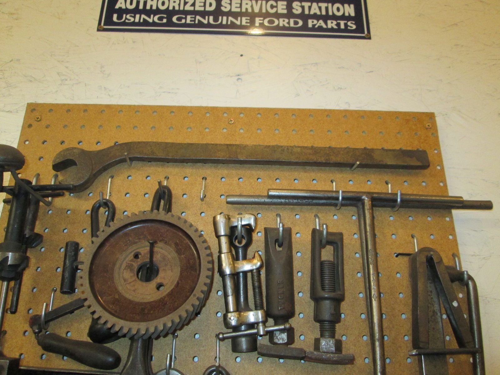

Re: axle torque
Didn't Ford offer dealers a special axle nut wrench about 2 feet long? I'd guess that would translate to about 100 ft lbs.
- Posts: 5307
Re: axle torque
Yes, they did - I can post a photo later today - mine was nickel plated as are some of my other "factory" wrenches.

- Posts: 4224
Re: axle torque

Re: axle torque
Steve, I like your display. Some day when I move back north I'm hoping to have a larger garage and I want to set up a board like yours with all my specialized Ford tools. Thank again everyone for your help.

Re: axle torque
20" wrench, 165 lb mechanic....

Re: axle torque
I'm surprised that the rear axle nut "Z" wrench is open-end.
My father has a TT rear axle nut Z wrench and it is box-end. It also has a round handle which is easier on the hands.
- Posts: 5307
Re: axle torque
Thanks Erik - I'll go check the numbers - that could be the rear perch nut - I have more !
