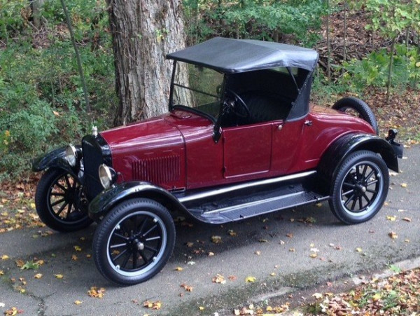

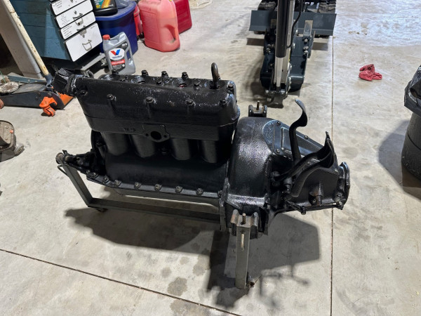

Hi Folks
I recently purchased a rebuilt 24 engine (July 24 according to the SN) and want to install it in my 1926 Roadster. What issues will I run into if any? I see the pedals are different and I’m not sure if the hog’s head are interchangeable. I have read that some of them are not and just want to see if this combination is or if it will even fit into the car correctly. If there are any complications or things that will need changed, I would appreciate the heads up before tearing into it.
Thank you
Thank you

My apologies I should have been clear with my question. I have a 24 engine and transmission that was rebuilt by Ron's Machine Shop. I was unclear if I could just swap the hogs head but sounds like that's not an option. So I will do the engine transmission swap and change the floor boards. I attached a photo of the engine.

Man I thought it would be easier than all this. I guess a few options would be to stick it in and make it work while getting the 26 engine rebuilt or find a 24 to stick it in (always need another car) or build a speedster and stick the engine in that and drive the speedster while the 26 is down. I have wanted a speedster for awhile. Might be cheaper just to buy a car already restored and be happy.

Yes… beautiful roadster Gerald. You’ll have fun with its future performance. I agree with Pat. Refurbish and revive the ‘26 engine in situ. Primarily because pulling a ‘26-‘27 power pack is more of a pain than earlier engines. Starting with the headlight bar.
I have a ‘26 roadster too. All body styles of these last 2 years tend to be sluggish. Once I achieved stock engine performance, I added an NH straight thru carb on a high volume aluminum intake manifold. Then I added a Scott Conger needle/seat and a Giant Power Head.It ran like a scalded ape but not being content, I also added a KC Warford tranny. I answered your OP by stating ‘yes you can’ but now encourage the ‘26 engine attention. And my roadster even has a painted radiator shell and nickel headlamp rims like yours.
