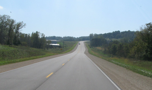

- Posts: 6311
Re: Trailer OR Drive?
Go for it!! Hilly in Iowa means going downhill then uphill. The area around Pella is full of small valleys not hill. You should be able to make the 15 mil trip in 45 minutes at 20mph.
- Attachments
- iowa.png (336.87 KiB) Viewed 407 times

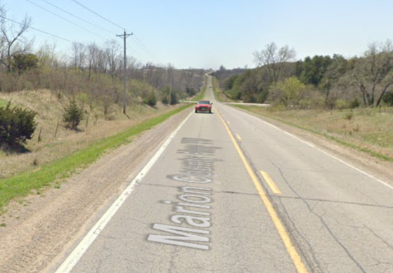

- Posts: 7302
Frank's picture reminds me of this shot I took in the mountainous NE part of Iowa.
